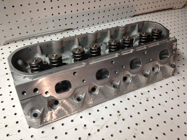

      It was 4 weeks door to door, and that was in March at the height of their season. Mike is a really good guy, spec'd my cam, and responded to all my emails/PM's.

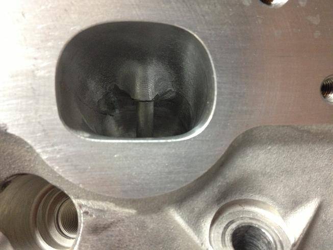

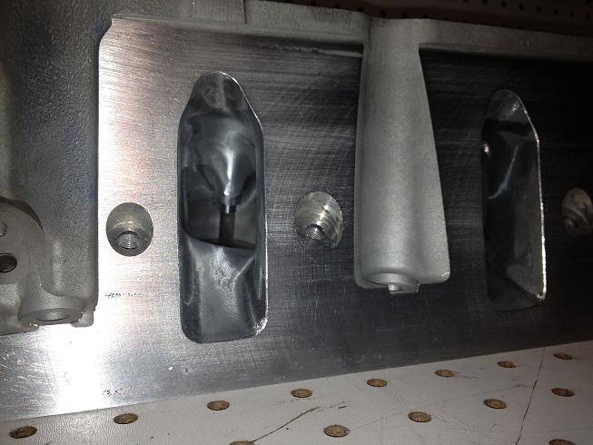

      I initially looked at Advanced Inductions, but after several weeks of less than stellar communication, I contacted TEA and am very glad I did. Here are the TEA Stage 2 243's:

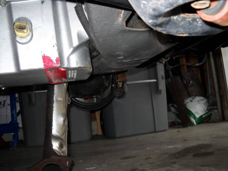

      wow those heads look mint. i'm going to do this in a few short stages so 1 is getting the motor in the car and drivable(aiming for the summer). 2 is getting the new comp cam and swap it in sept(when my bday is). 3 is having the heads ported(the following xmas). i want to make this a fun project, not something to just rush and do. I like my stock stance for the car right now, maybe lower the back an inch at most but i never have any clearance issues, and in mass the roads are terrible and i need all of it. with that said, do you think i will run into any problems if i kept the truck oil pan?

      no way the truck pan will work, it hangs several inches below the crossmember. The CTS-V is the best economical choice. It's only about 3/4" below the crossmember. If you don't lower the car too much, you'll be fine with it.
