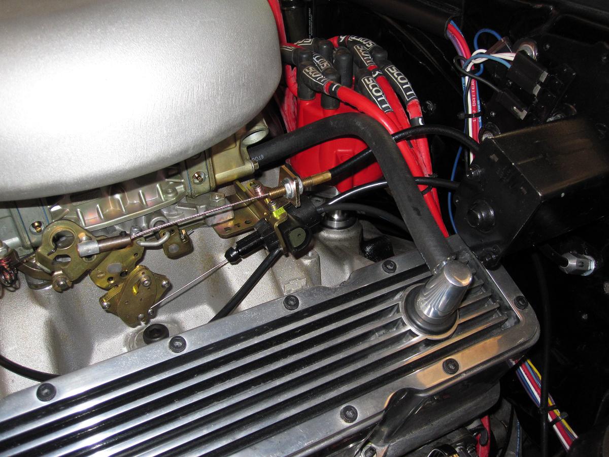

      I have one breather on the passenger side valve cover and did notice a little fluid backing out there but it was minimal ... The drivers side has a PVC (Hose from Valve cover to rear of Carb) ...

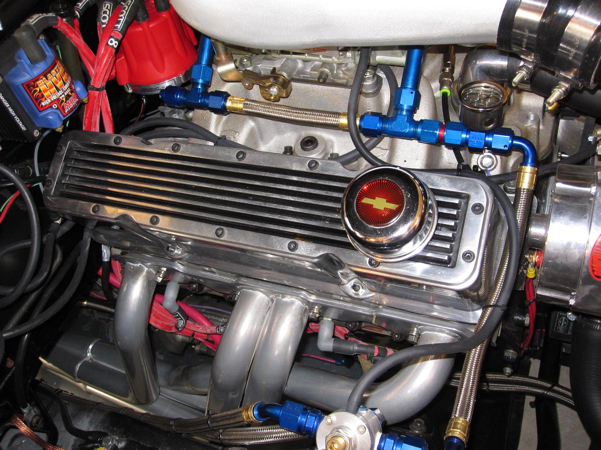

      I'm uploading images of my current setup ...
      Name:  Dipstick Resized.jpg
Size:  197.5 KBName:  Passenger Side Breather Resized.jpg
Size:  218.1 KBName:  PCV Hose Resized.jpg

      After speaking with a local engine guy, he recommended adding a 2nd breather and keeping the PCV valve. Looks like I might need new valves covers as I'm not sure how to drill these ribbed covers for a 2nd breather ... I'll also probably get better breathers while I'm at it. Any recommendations ???
