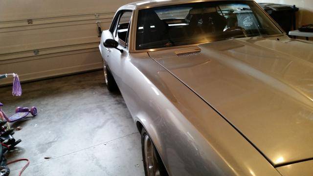

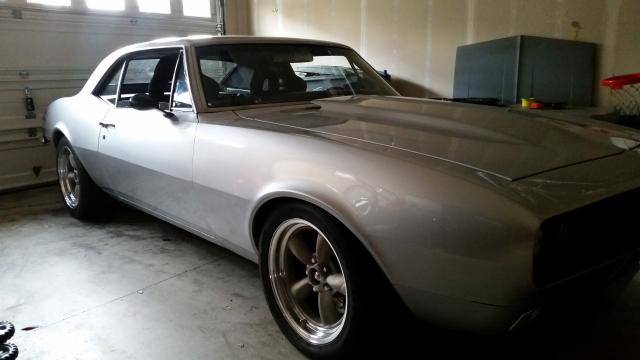

      Few more pics. added some side mirrors. installed hush mat, now time to figure the wiper motor setup out.

      Hey man nice, I like your car. What silver is that? Is it a Subaru wrx silver.
    5. #25
      Sep 2013
      31
      Thank you. Its the Toyota FRS . or subaru BRZ D6S paint code. its a decent looking silver. The wrx is 01g code if i remember right.
