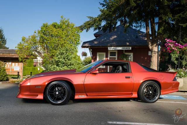

      Thats a picture when I bought the car.

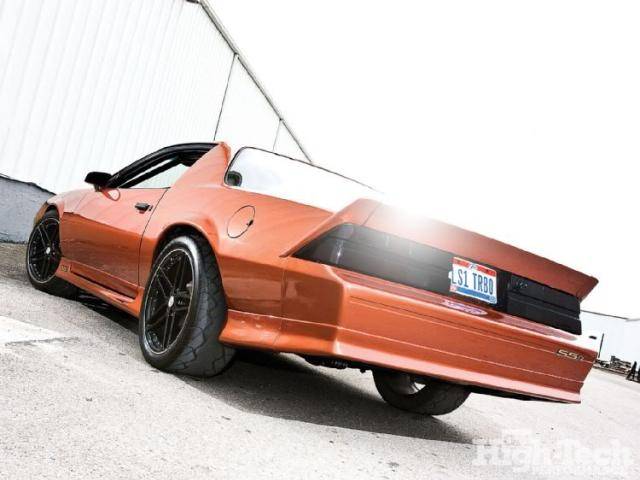

      It was featured in March 2011 GM High Tech by the previous owner. http://www.gmhightechperformance.com...o/viewall.html

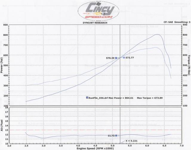

      Did a few pulls on the dyno yesterday
