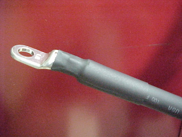

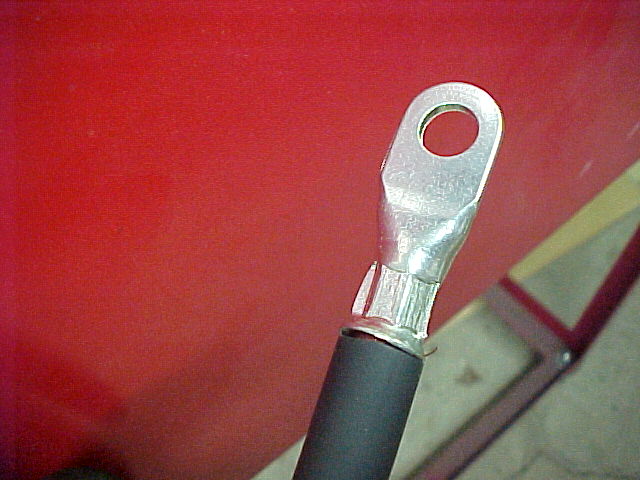

      I got it today and tried it out on a 1/0 cable terminal. I can say it worked very well and I am glad I waited to do these crimps until I got this tool...
      Here is the lug I am going to crimp. As you can see this is pretty big. The tool comes with dies to do up to 2/0.
      Excellent investment and it makes some nice looking crimps. I am going to look into hard mounting it to the bench. It gets kind of busy trying to hold the cable in place while trying to actuate the hand pump on the crimper.
      I clamped the lug in the vise and tested the crimp. It will take a lot of force to pull the lug off...
      I finished up the crimp with some heat shrink and called it good...
