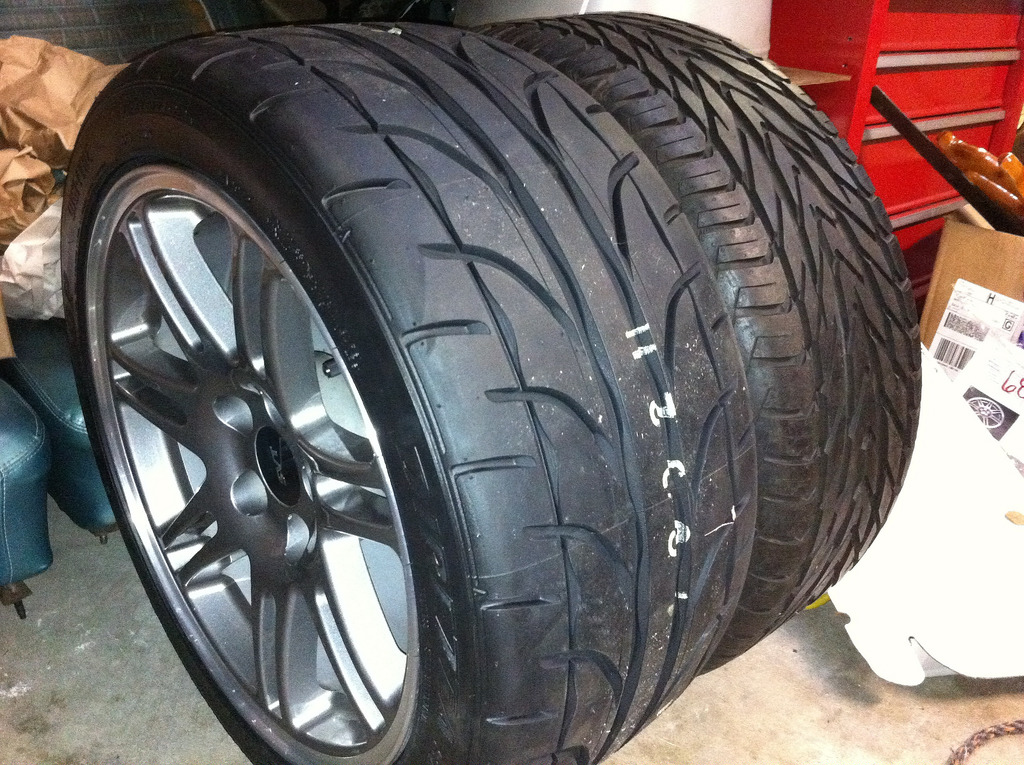

      I was taught early on in my autocrossing days to put shoe polish or chalk on the sidewalls of a tire and make a run to see how far the tire is rolling over and adjust air pressure accordingly. Here is the result of that from two events ago, Started the pressures out at 40 PSI and bled a pound or two out the first two runs and it leveled off at 40 PSI hot.
      The polish wore off right at the edge of the tread blocks and I called it good at the time.
      This was before I saw the video of how far the tire was deflecting under "normal" driving circumstance at near the same pressures.
      Lance
