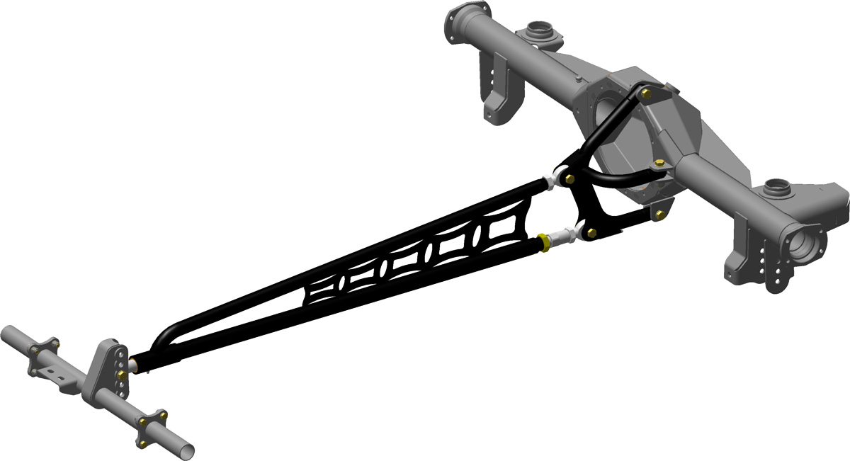

      Also, regarding your '99 Firebird, we have a coilover conversion for the front. Read about it HERE on Chevy Hardcore. AND, I might as well mention this here, we have a brand new FAB9™ and Torque Arm we have on the shelf and are about to release for the rear. Super nice drag race stuff.
      Here's a sneak peek.
