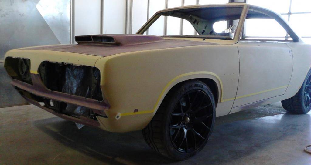

      Tire Clearance
      I made a 1" spacer for the rear out of 5/16" spacer and some washers to mock up the tire to simulate a wider wheel/tire combo relative to the outside lip.
      Minimum clearance at the outside on the rear went to 1/2" from the stock wheel lip. The stock wheel lip is nearly 1" wide, it will be getting rolled to provide a little more room. Probably go ahead and run a 1/2" spacer with this wheel and tire, which would take it in 1/2" vs. the pictures.
      Here is a picture of the inside clearance at the closest point. At the top inside there is more room.
      That 295 just disappeared into the wheel well. According to Falken the 295/40 is 11.8" section and 27.2" tall. The Michelin Pilot Sport 345/30-19 is advertised at 13.8" section and 27.2" tall. That may just barely fit. With glass, gas, people and the interior the rear end will sit down a bit more. Tank is 32 gallons, I had icemanrd19 sit on the rear bumper (he weighs about the same as a full tank) and the lip was almost level with the top of the tire.

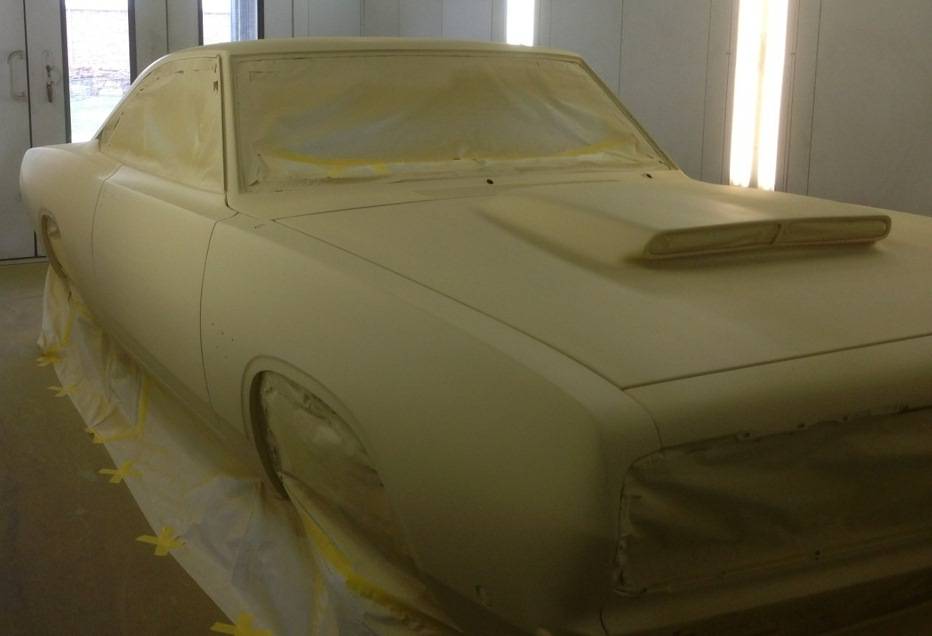

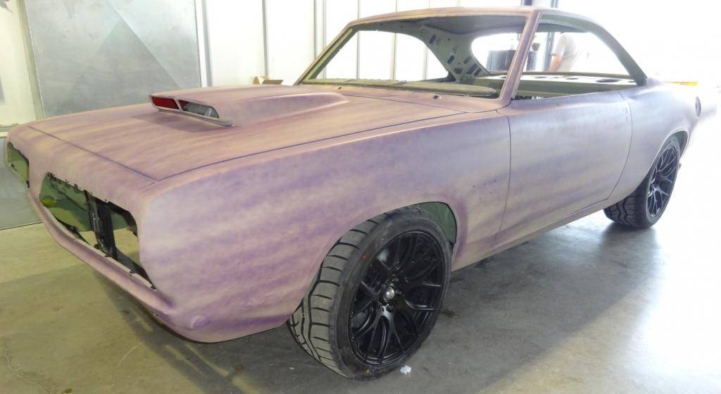

      This morning..
      By lunchtime, mellow yellow primer:
      This afternoon, plum crazy guidecoat:

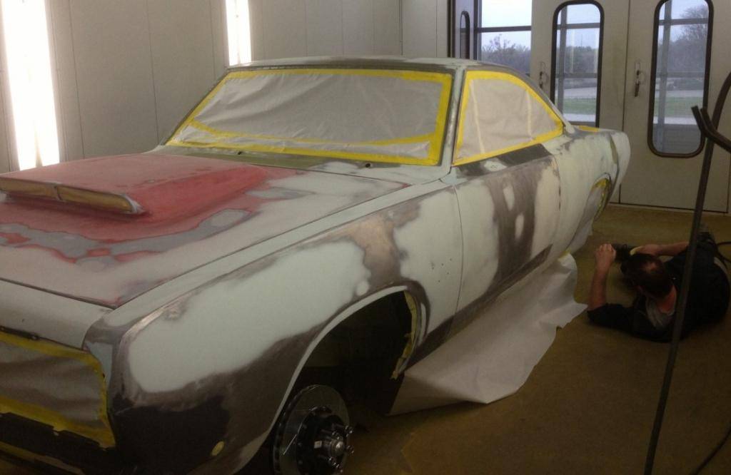

      Block Sanding
      ... and sanding continues.

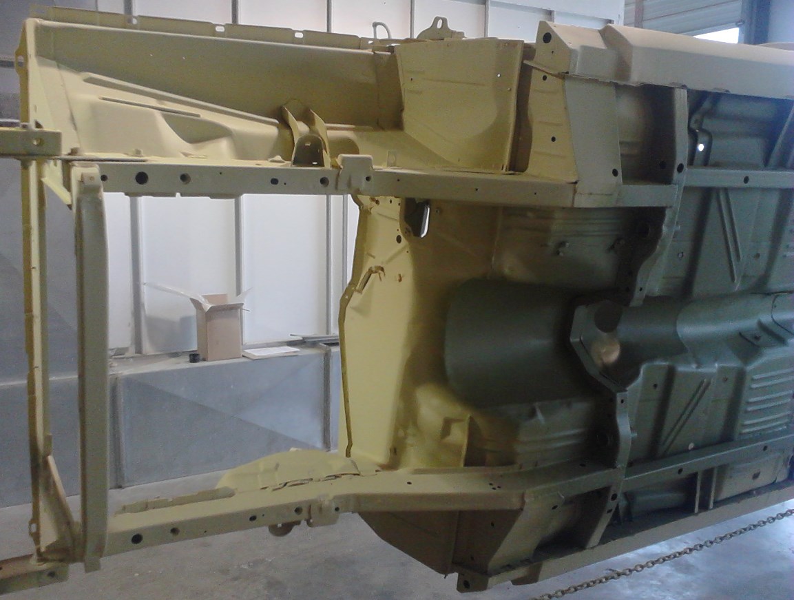

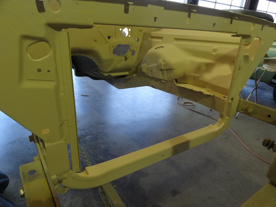

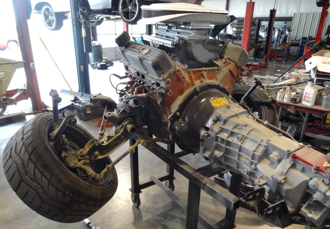

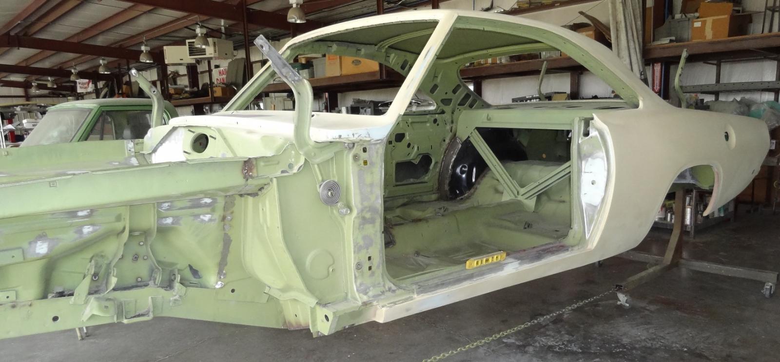

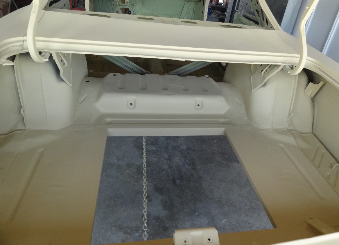

      Block sanding is done, final prime on the fenders, doors, decklid, header panel, front valance, and hood are done.
      Put the car back on the Rotisserie today so they can do the final primer and finishing work for the inside, underneath, and outside of the body. My son Alec and I went to the body shop at 8am, pulled the engine, transmission, front suspension, brakes, wheels, rear axle, and rear suspension. Put the car on the rotisserie, removed the wiper motor and a few other odds and ends still on the car. We left at 11:15, ate some lunch and went to a car show...
      Sure makes things easier when you have a lift and air tools you can use.
      First picture shows the 2x2 cross brace Sam installed. We started w/ the XV brace, modified it to the correct width, raised it to match the height of the factory piece, cut pockets in the corners to clear the cross flow radiator, put nutserts into the front for the latch support to bolt to, and added stand offs to the corners for the front valance attachment points. Sam also cleaned up the edges where the radiator opening had been expanded to fully expose my 27-1/2"x19" radiator core.
      Second picture shows the engine-transmission-suspension assembly which drops out as one complete unit with the removal of a whole 12 bolts. Pulled it out in about 30 minutes, and only took that long because an 11 year old was doing much of the wrenching.
      Third picture is of the car after the fact back on the rotisserie.

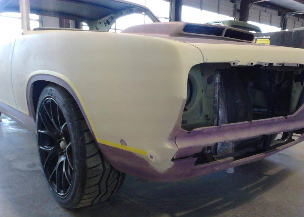

      Not much progress this week
      Some shuffling at the shop to try to keep all the hands busy... resulted in not much progress this week on my car. Pictures from last Saturday. Final primer is done. I cleaned out my garage and took a bunch of loose parts home that they did not need for fitment any longer. Bottom, inside and jambs should be painted next week.
