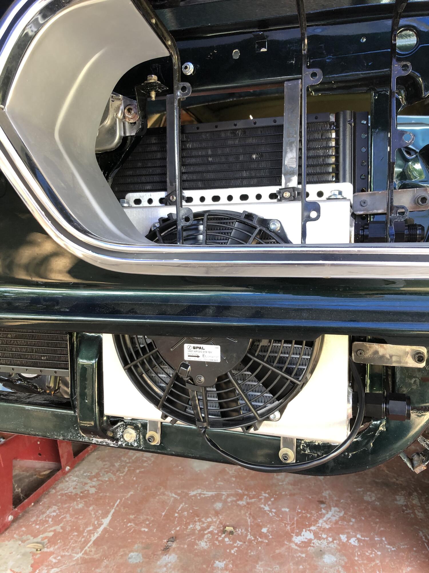

      Oil cooler mounting

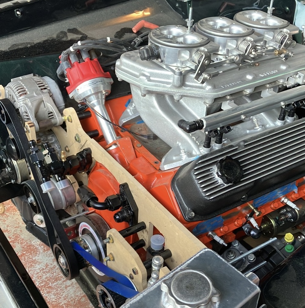

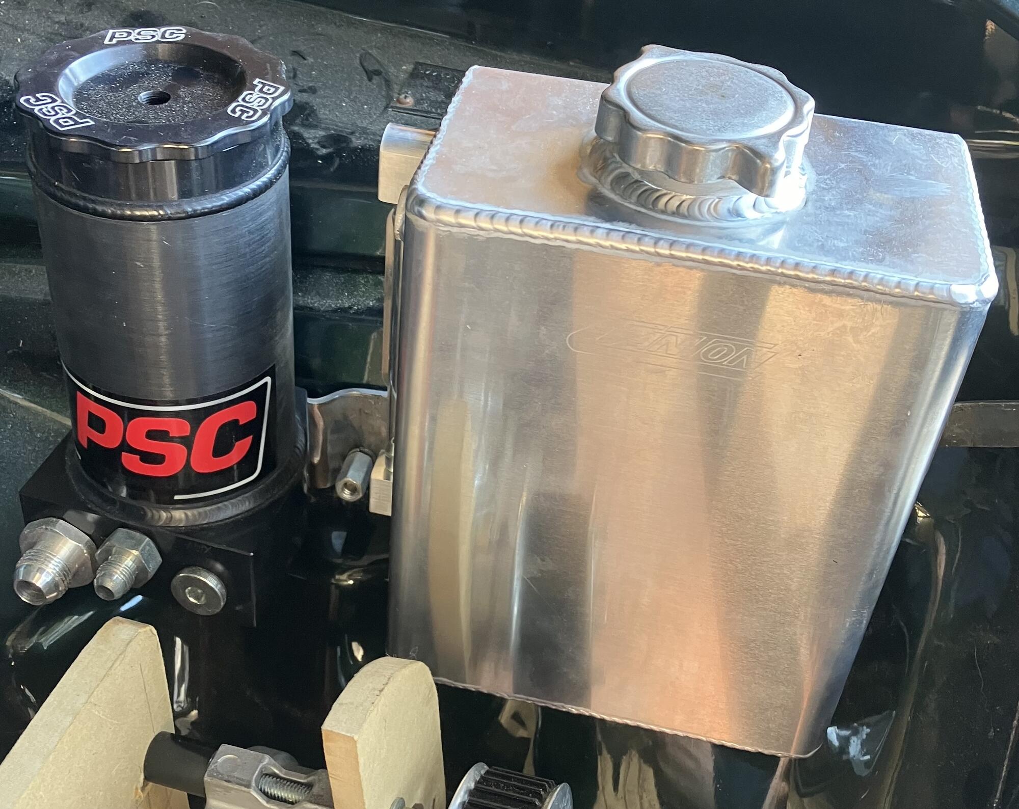

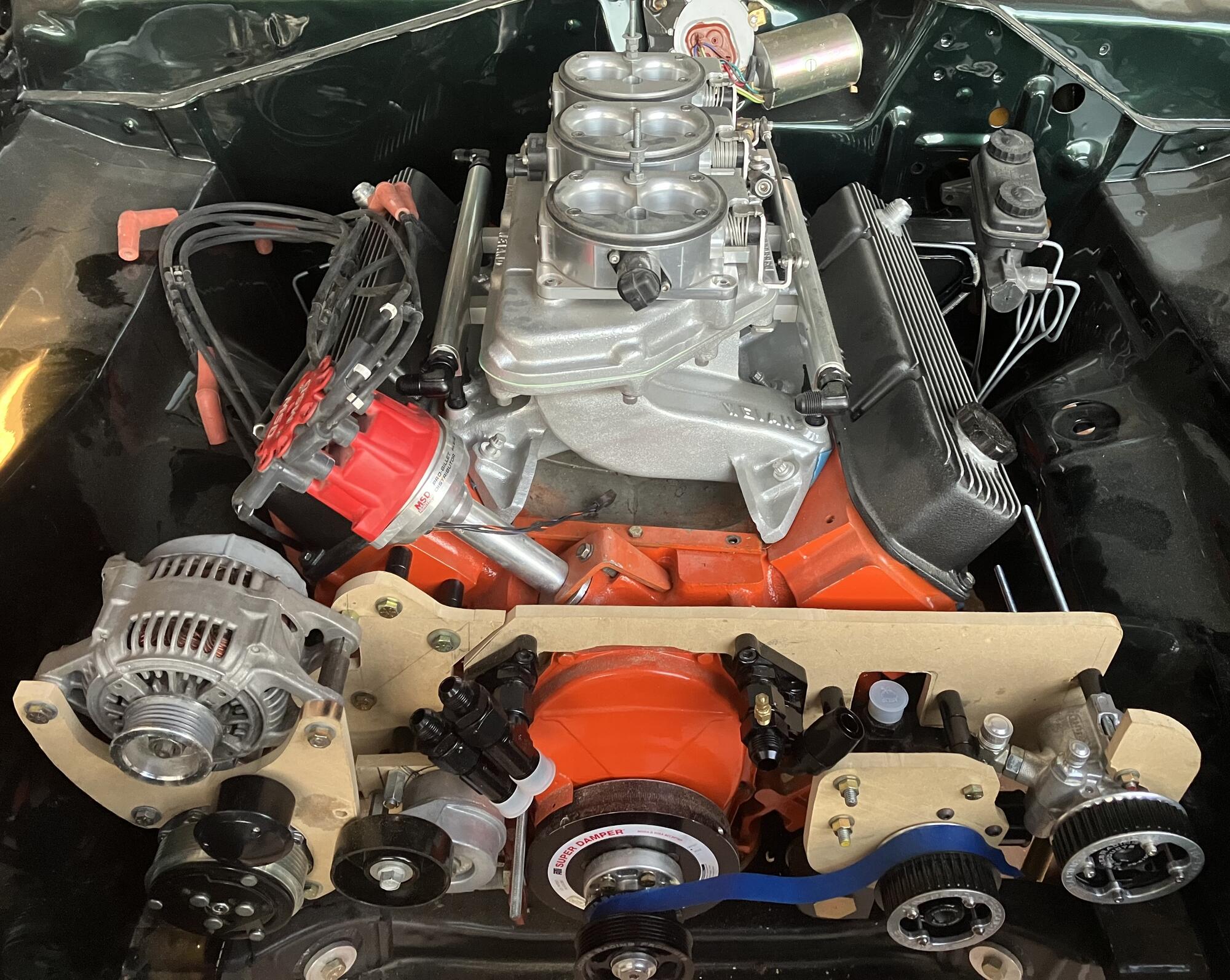

      OK, lots of details are new.
      Found a pair of Mickey Thompson early run non-logo valve covers.
      Modified them to have an o-ring seal fill cap and AN connections over baffles for the oil separator / breather.
      Powder coated valve covers and intake.
      Bought drive pulley setup, water pump pulley, power steering pulley, and alternator pulley from Jones racing.
      Water pump is Meziere belt driven remote. PS pump
      is Corvette large bearing style with bypass pressure set to match needs of the PS box.
      Tensioner for V6 Ford; alternator from a V8 Dodge pickup; belt for a 2023 Corvette.
      Still have some prototype work to finish for the water pump and PS pump brackets.
Size:  420.7 KBName:  IMG_2706.jpg
Size:  359.8 KBName:  IMG_2582.jpg
Size:  471.2 KBName:  IMG_2580.jpg
      Michael Mosley
