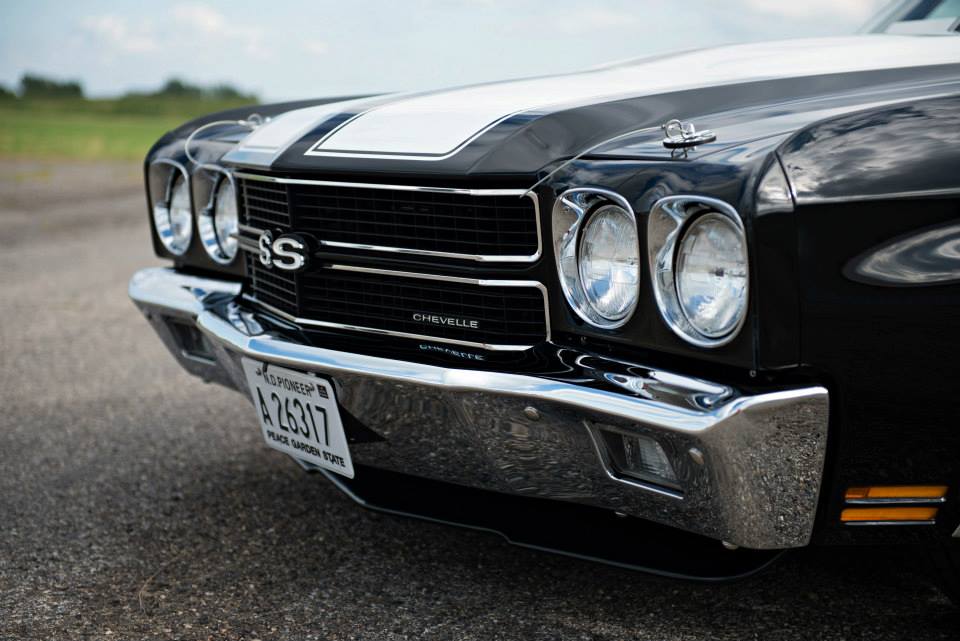

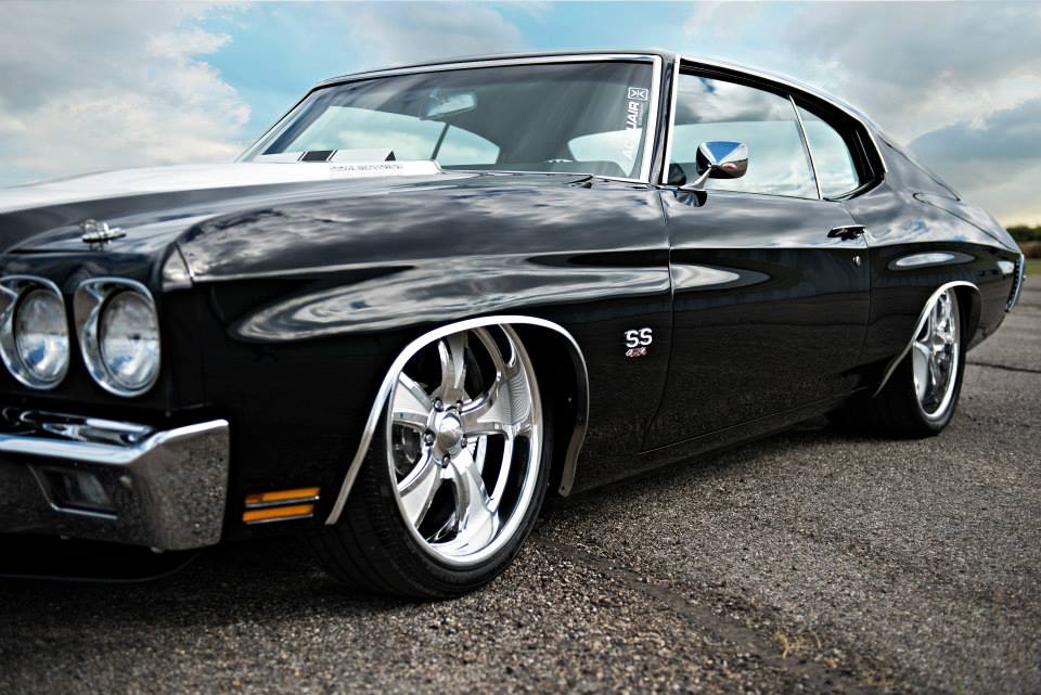

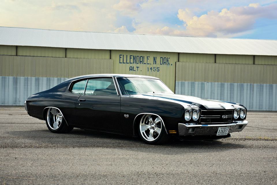

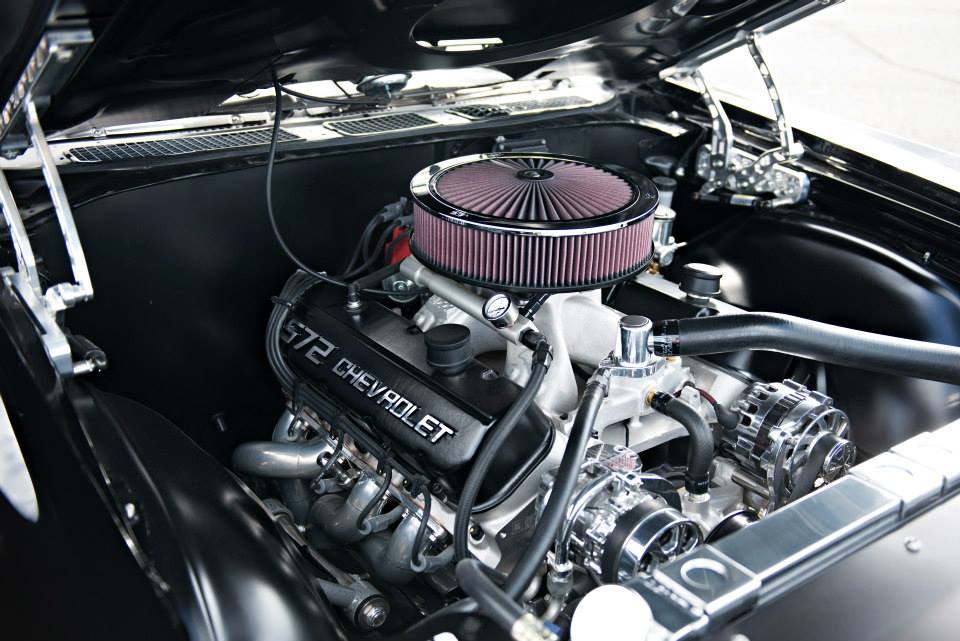

      My name's Mike and I have a body shop in southeastern ND. I have been following the site for quite awhile and finally getting around to putting some pics up Attachment 81712
      Just finishing up my build...Accuair, 572 GM Crate...no expense spared. Thank goodness for understanding wives. Let me know what you think.

      Nice work! Very nice!
      Can you give us some details?
      What is your suspension setup?
      What are the wheels, size and BS?
      Sep 2007
      17
      mini tubbed (narrowed fab 9 rear end)
      Chris Alston Chassis Works suspension
      shock waves
      accuair E level air management
      Sep 2007
      17
      Wheels:
      intro matrix
      20X13 rear
      5" back space
      19X8 front
      5" back space
