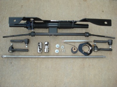

      All has been quiet on the Mustang front lately. I've just been driving the wheels off the car.
      Finally bit the bullet and bought a new toy for the Mustang. I've been contemplating going with a rebuilt, integral box or a rack and pinion. I'm aware that a steering box can be setup to the point where it can perform on par with the rack, but I feel the rack will be more capable out of the box without much tuning. Looking forward to getting this installed and start autocrossing the car.

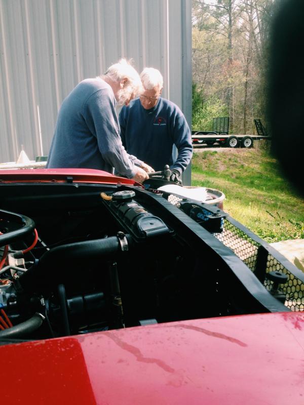

      Finally got the rack installed this weekend!
      I am VERY impressed with the Unisteer Rack and Pinion kit for the early Mustangs. I got the kit from Summit (Part #: UIS-8001110-01). Prior to installing the kit I read pretty much every single thread and forum topic relating to the install so I was ready for any issues that were to come.
      From the time I put the car on the lift, to the time I drove the car off the lift for the first test drive was a short 4 hours. That included removing the old power steering system. I will say, however, that I saved time by simple cutting the original steering shaft with a sawzall in order to make removing the old box/shaft combo easier.
      When it came time to put the rack in I did have to do a little grinding on the lower control arm bracket, but I was expecting that. I have a stock style pan and didn't need to put any dents in it to get the cradle to fit.
      After we got the rack fit I had to trim the threads on the end of the rack 1 inch on each side in order to thread the tie-rods on far enough to get the toe-in ball parked.
      The column modification was very simple - I just had to cut off 3 1/8th inch from the bottom and tap in a new bearing.
      I did have a little bit of play/slop in the steering when I initially put the rack in, but it turns out I didn't tighten the u-joints enough. I originally just tightened them as much as I could with a small allen, but later put a 6mm allen on a 3/8ths in socket and pulled with all my might.
      Driving impressions: Steering slop is gone completely. I went from having 1.5-2 inches of steering wheel movement before it translated into tire movement. I now have about 1/4 inch of play, and I believe that is simply the result torquing (twisting) the steering shaft.
      Going from power to manual will take getting used to, and the rack does have a few tight spots in it, but I only have about 12 miles on it so far. I'll keep driving it and after about 500 miles give an updated report.
      Steering radius seems to be unchanged. I did pretty extensive "before" testing so as soon as I get the rack all worked in I will do an "after" test with quantitative data.
      My father is testing out a new alignment shop on his car this week and if he likes they're work I'll take it to get re-aligned this weekend. I'll also take some photos next weekend when I get it on the rack. I want to make sure the u-joints are phased correctly.
      All in all I am very happy with the install. I am INSANELY excited about now having to mop up power steering fluid every time I take the car out of the garage. Somehow there always seemed to be enough power steering fluid on the ground that a CSI team might be suspicious.

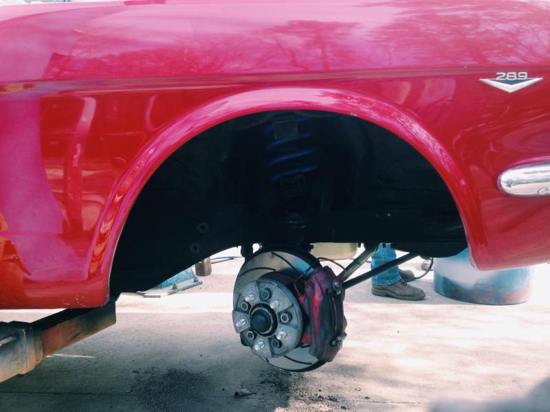

      Spent a little more time weathering the pollen storm that's making its way through the South right now.
      The front end is just about wrapped up after this weekend.
      I was finally able to install new upper ball joints and performed the Arning drop. Lowered the front end quiet a bit!
      The car is off to the alignment shop at the end of this week. Then all that's left is to build a metal rear-seat bulkhead and then the car will but AutoX ready! My aim is to have the car sorted by April 25th for the Summit Autorama show. The American Street Car Series will be on hand working the AutoX.

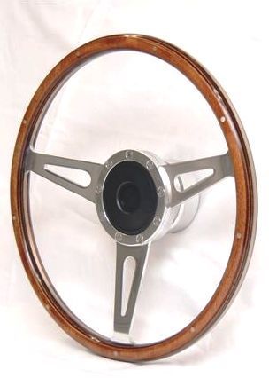

      Finally got the steering wheel installed! Took the car to work this morning and installed it during my lunch break! Overall the installation went fairly easy. I am going to have to take the hub back off the adjust the turn signal cancelling roll pins but aside from that it's a nice quality piece. Not only does it make driving the car more enjoyable as I appreciate the aesthetic, but the increased thickness in the wheel makes the car more enjoyable to drive.
