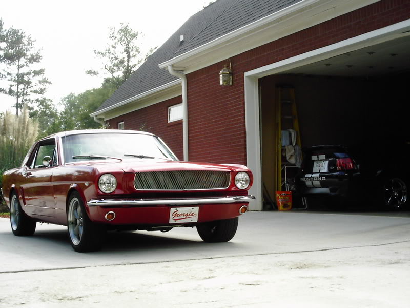

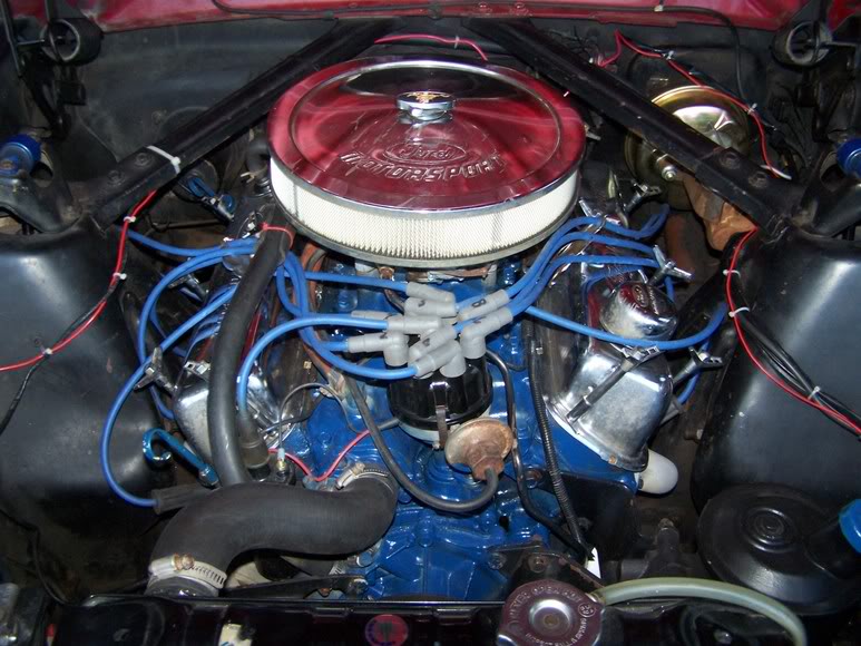

      The car has come quite a ways in the 9 years since I've been tinkering. It was originally built as a 289/2bbl car with a C4 and an open 8inch. That was quickly torn out in favor of a well built (albeit over-cammed) 351W backed by a T5 and a trac-loc 8inch. It was a great little engine, but as stated earlier, I chose a cam that was way too large, but I was in highschool and the cammed "sound" was very important.

      I drove the car with that setup until I left for college. While at college the car stayed in my parents garage, virtually untouched and driven only a couple of times a month when I would come home.

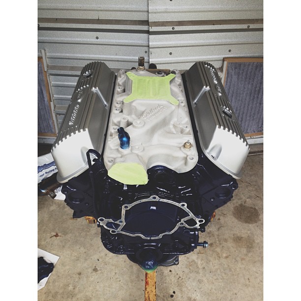

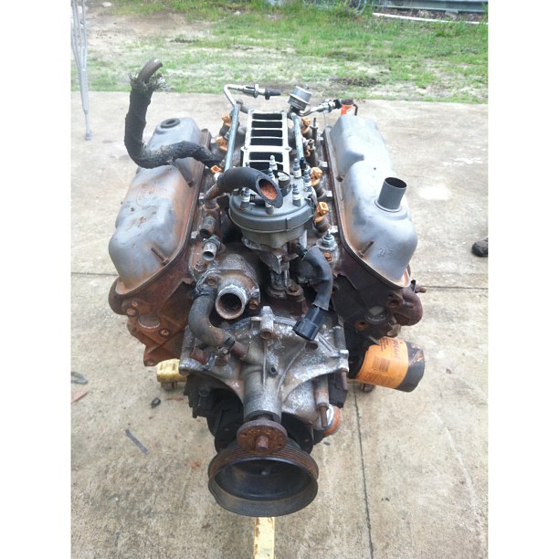

      I had another stroke of luck when a friend offered a roller 5.0 long block to me, free of charge. And with that, I was off to the races. Plans were to build a mild roller 5.0, Ported E7's (It's a bucket list item I've wanted to learn to do for years) with a mild alphabet cam and a simple carb setup.
      Unfortunately, it wasn't until I had spent 20+ hours on the heads that I took the pan off and realized the main bearings had welded themselves to the crank. Not the end of the world, but I really wanted to leave the rotating assembly in tact. I ended up scraping the build in favor of a clean 289 I had lying around.
      Tore it down to a short block, cleaned it up, fresh gaskets, a Comp 262HE cam and some fresh paint and it was ready to go in.

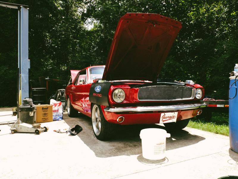

      These valve covers will be coming off and painted Dark Ford Blue but they'll stay until I get the valves adjusted.

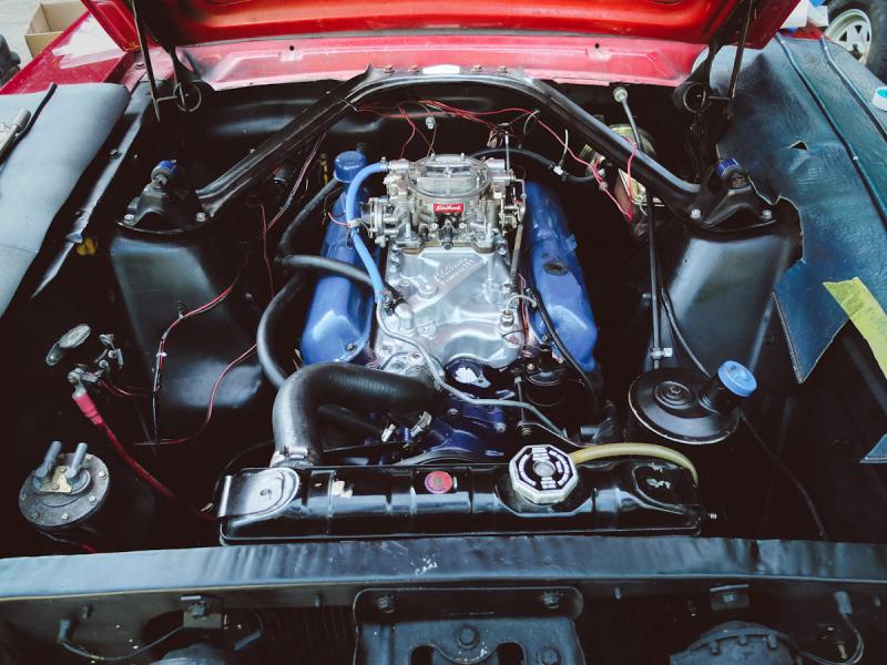

      Everything went together without a hitch - Until we went to fire it. I opted for a pain free Pertronix setup over the old MSD setup that was in the 351W. But I didn't place the plastic spacer between the distributor and the rotor - resulting in no spark. After a frustrating couple of hours we realized the problem and she fired up without an issue.
      Took her for a short drive last weekend. Still need to adjust the clutch, re-bleed the brakes, adjust the e-brake and tweak some other small things. But she's running!

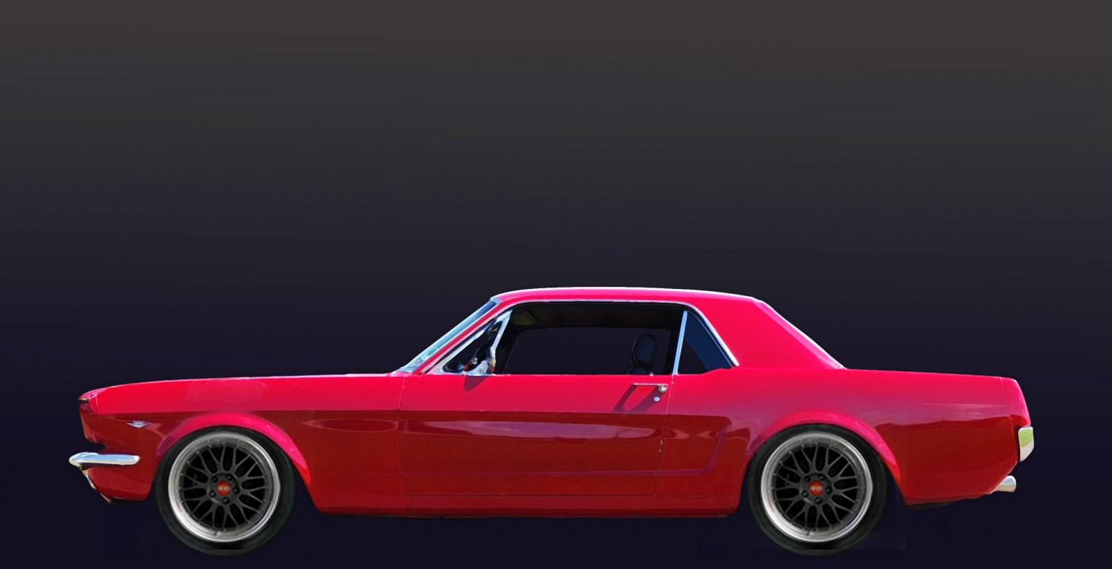

      A quick little idea of what I'd like it to look like

      I've never been overly happy with the wheel selection on the car so I've been mocking up a few options. Let me know what you think!

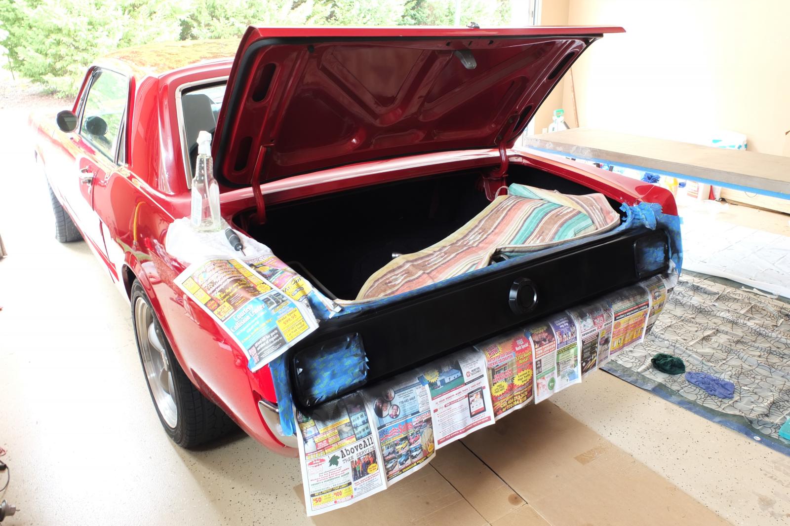

      I've also been throwing a couple of ideas around and I've been wanting to try out some "Plasti-Dip" paint. I figured it would be a great way to concept a few ideas in a temporary fashion since, if I don't like it, I can simply peel it right off. The first idea was simply a blacked out tail light panel.
      It took about 15 total. 10 for masking and 5 for spraying. Not to bad.
