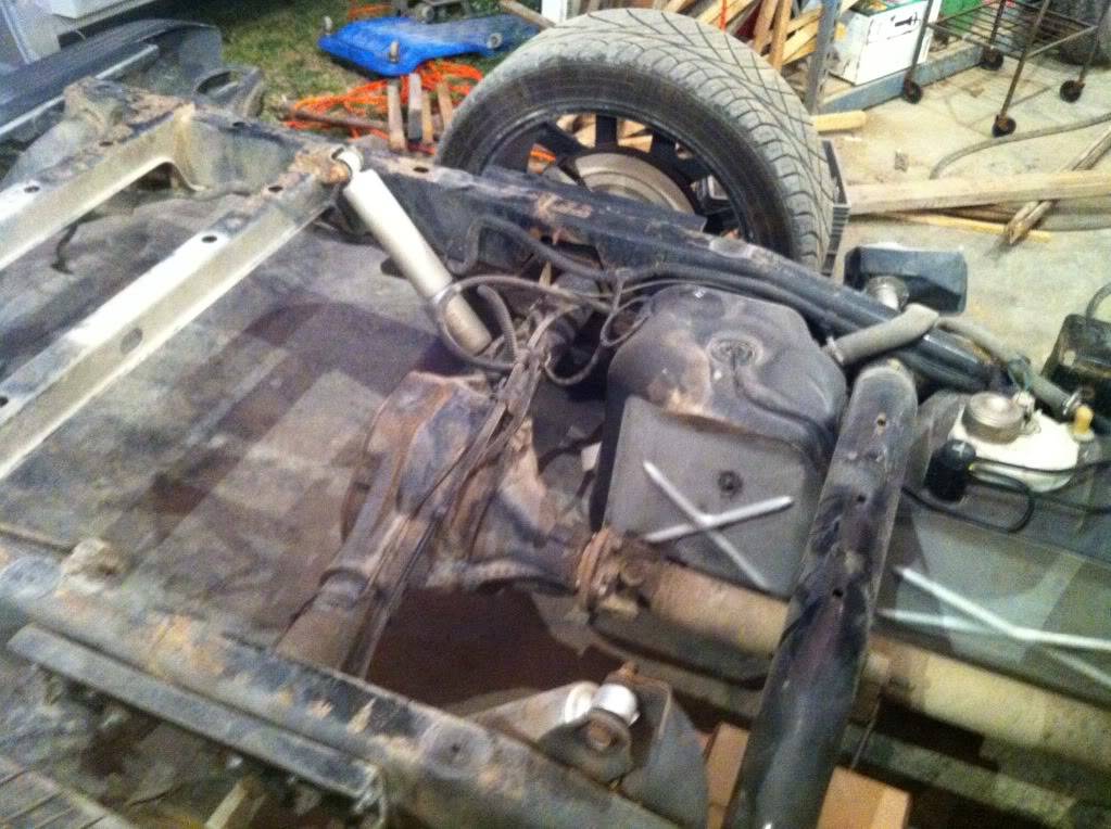

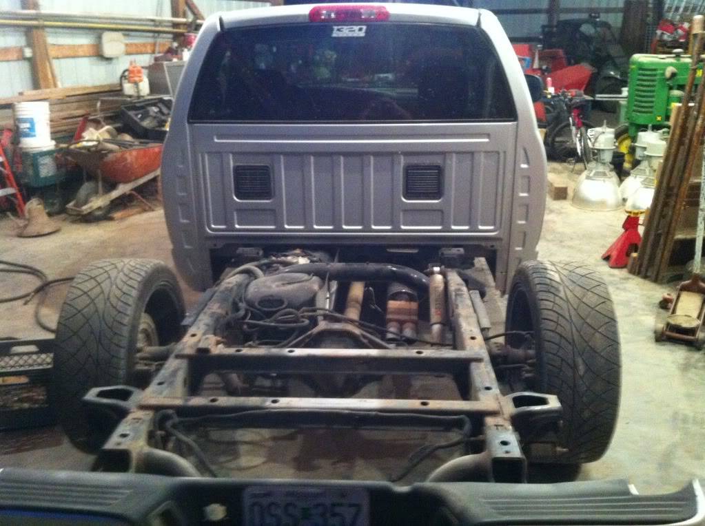

      Hi, the names pat this is my first post. I've been doing quite a few auto cross events over the past year or so and it's time I step my suspension up to the next level. I'm curious as to what type of link suspension to put under it. I've decided to do coilovers in the front, but the rear I'm undecided on. In the pics below the tank will be moved as far back as I possibly can and will be centered, battery relocated, 1.5" taller actual c-notches, helper bags installed on the inside of the frame, and all new brake and fuel lines plumbed. Also, I have another d60 axle which ill be using instead of this one, off of a SRT10 viper truck with the factory bigger brembo brakes(also doing front upgrade as well). I would like the lower links to be on the outside of the frame basically where the leafs sit now, as well as the coilovers in the rear and they'll be at a slight 10-20* angle. I turned below if more are needed I can do that as well. Ill be doing all the fabrication my self. I'm all ears let me know what you think.
      Thanks Pat
