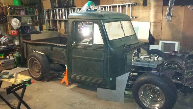

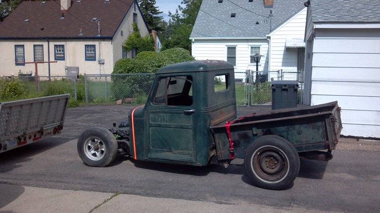

      Here is my project. It's a 1950 Willys Pick up. I was talking with my friend over beers about this Street fighter truck idea I had bouncing around in my head. He promptly offered up the titled body of his stalled project in trade for a case of beer.
      This is to be a budget build, NOT to be confused with a rat rod. I don't plan to paint it, Nothing is going in to it that does not make it go, stop or turn.
      Its now sitting on an S10 chassis I picked up from a friend. Front suspension had been rebuilt, and already had drop spindles and coils. In the rear is a 9" ford with a three link and will be getting coils and weight jacks. Up front will be coil overs and SPC upper arms.
      Keeping within Budget is a 305 chevy (traded another friend a case of beer) and a TH350. The 305 is getting a Summit house brand cam, dual plane intake and I'm going to build a set of small tube full length headers.
      Wheels will be 18 x 9.5 Boss 338's and tires will be somewhere around 285-295's on all four corners.
      I'm going for a street fighter / vintage circle track / Road race feel.

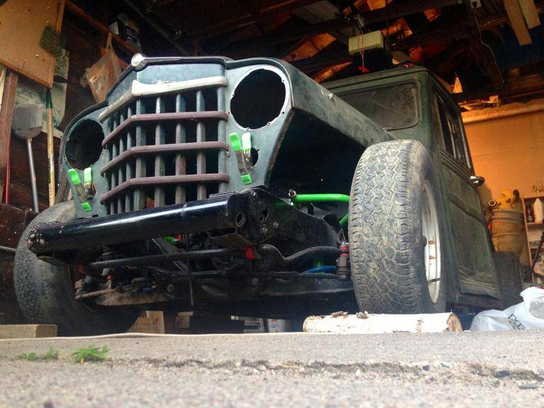

      That's not a Notch, It's a bridge for the springs and shocks. Both sides are now connected. The frame is getting boxed, more bracing is going in and it's getting a cage with bars connected to the bridge.

      Quote Originally Posted by shizzy View Post
      Gatcha, I just notice the material to the left in the pic above.
      Wow caged to, nice. This is going to be good.

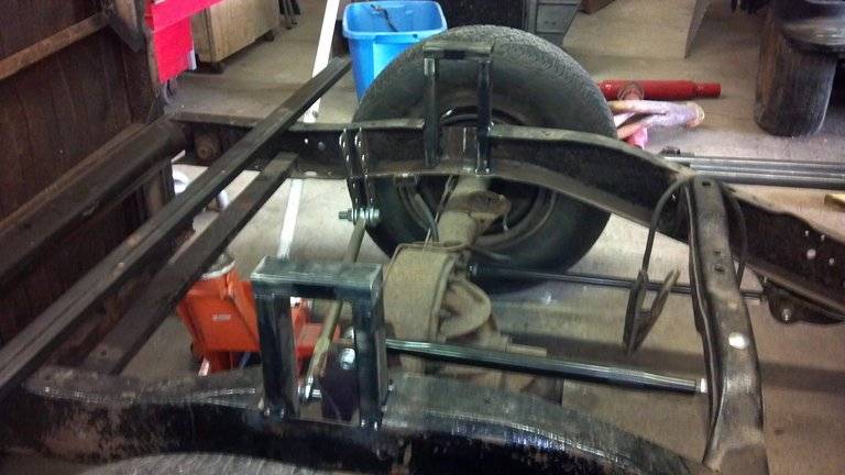

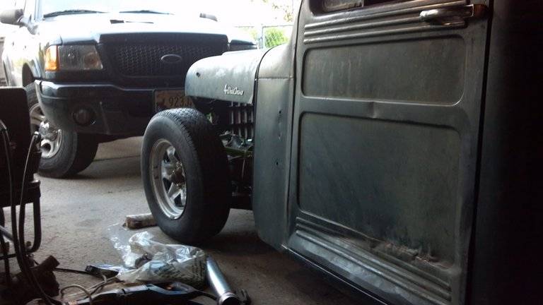

      I've been extremely busy. The rear suspension is all tacked in.
      I ended up cutting the whole entire floor and inner rockers out. The front half of the floor and most of the fire wall was already missing and I decided it was going to be just as much work to try to patch the old as it would be to start new.
      I welded 2 x 3 tubing in to the inner rockers so that I had a solid base to build body mounts to and attach the floor.
      I then spent the next few months building the body mounts and putting in the subfloor.
      then it was on to the floors and the firewall. The engine is set back a good 11" from the stock S10 location so making room for the HEI distributor and the factory cowl vent AND the transmission AND my feet was a challenge.

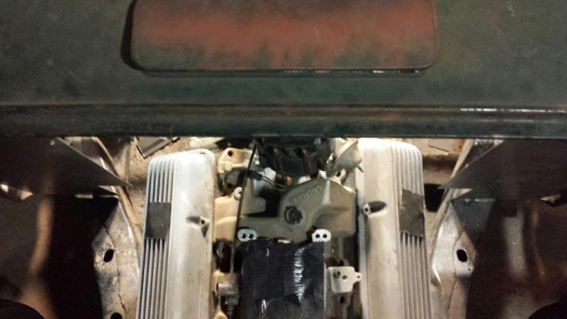

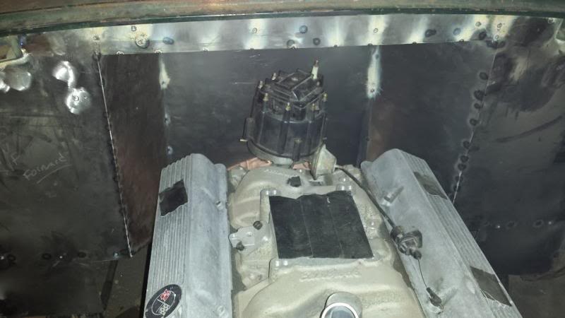

      In the mean time, I picked up a 2004R from a friend and traded the TH350 for a pair of Quadrajets. Another friend gave me a Performer intake he found in his shed. I also picked up a set of Vette / LT1 valve covers at U pull. They are a bit beat up, but for $18, I couldn't pass it up.
      bad side shot, it's cold here in MN, no outside shots for a while.
      With the exception of the tranny tunnel, the floors are in. Despite the doghouse, The factory cowl vent will still work.
      the HEI is still snug, but it will side in and out with the cap and rotor removed.

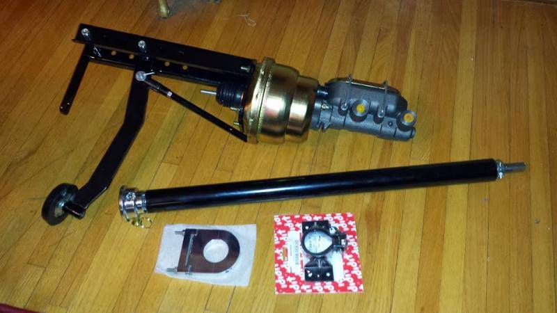

      next to go in are brake pedal assembly, steering column and shifter. Shifter and steering wheel will be here on Monday.

      the rear is a 9" out of a 79 Lincoln. it's a pretty nice rear, 3 link with a panhard and coils. I was able to reuse the S10 front leaf spring mounts for the front mount points for the lower control arms and the stock control arm mounts on the 9". I did have to fab a crossmember and a mount for the upper link, but was able to reuse the OEM one on the 9". The rear has coils and weight jacks, and I'd like to go with coilovers on the front, but that will be dependent on cash.
      The cardboard box is a mockup of the fuel cell. It looks like Ill have everything aside from the radiator between the front and rear wheels. I should end up with a pretty even weight distribution.

      Booster and master in, hole cut for the steering column.
      sure feels good to be able to sit in an actual seat bolted to an actual floor and grab hold of an actual steering wheel mounted to an actual steering column and put your hand on an actual shifter mounted to an actual transmission.
