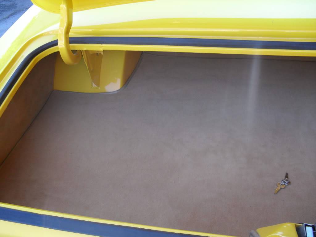

      The idea behind mini tubs is that they look factory when you pop the trunk, and there is less work involved of the interior like you're talking about- not to mention that there's a lot of frame modification if you were to go well over the 335 mark and fully tub it.
      If you wanted to run big tubs it's not a negative.. but there aren't any positives that I see. Most cars I see with full tubs are pro-street cars and the modification isn't that tasteful.. just a big aluminum tub riveted to the sheet metal and looks ugly IMO!

      That is one aspect I didn't note in my post, the trunk view. And I would tend to share your sentiment.

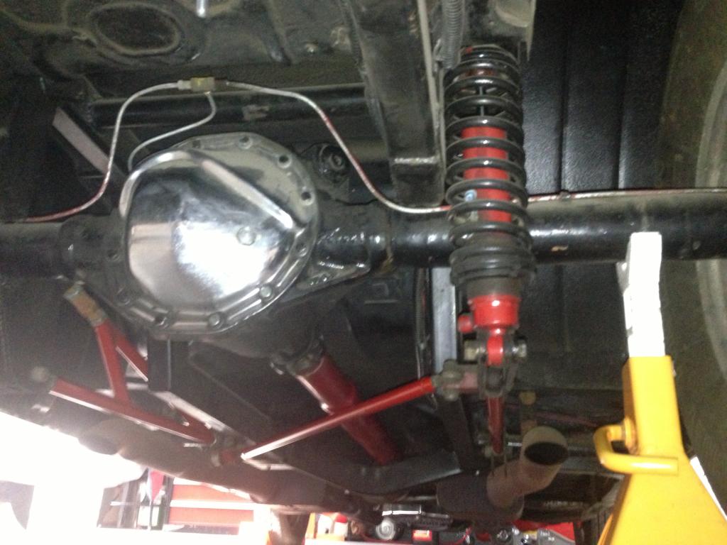

      Guess that is what that extra steal is back there..
      Ahh frame modifications, I didn't think about that. And again I would be buying not doing, just wondering if it's even something I would want to do, convert a clean pro-street to track duty.
      Thanks, had not considered that.

      Yeah, that chassis there has been back-halved, which is typically what pro-street guys do. Most of the chassis i've seen look like they were welded together with an arc welder and eyes closed... so take a good look at the welds & attaching points before you buy. Most pro-street cars also have much different spring rates and suspension types (soft rates, parallel 4-link etc) that are not optimal for .. turning! So don't dive into something that requires more work to change, rather than modifying a car that has not been modified yet.
      -Dale

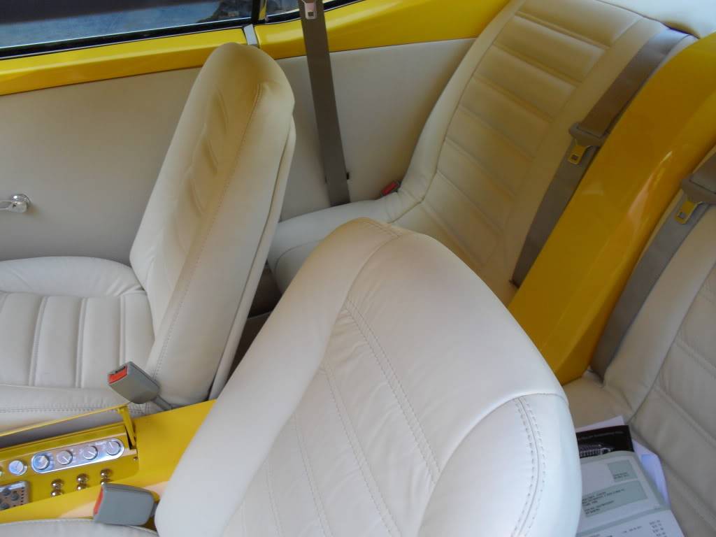

      here's mine, cross between pro-street and pro-tour. It has custom sheet metal tubs. 390x40x17 rears that fill the guards (I like sidewall) and runs a rear seat.
      I see no probs with what you want, but as others have said check quality of work, it can be tasteful and well done and deliver good track performance.
