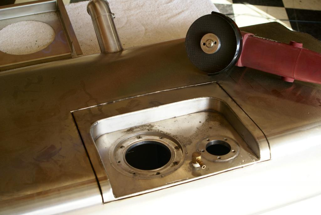

      So..... I found myself with an extra Ricks first gen tank. I had already proto-typed the exhaust corner clips as well as the corner clips for the shackles when you mini-tub. Next obvious step was to install one of Carl's Retroworx http://www.vaporworx.com/ kits. The scariest part about installing the kit was carving one big azz hole in the top of my nice shiny expensive stainless tank. A 4 inch angle grinder and 5 minutes and the old was gone and ready for the new tray.

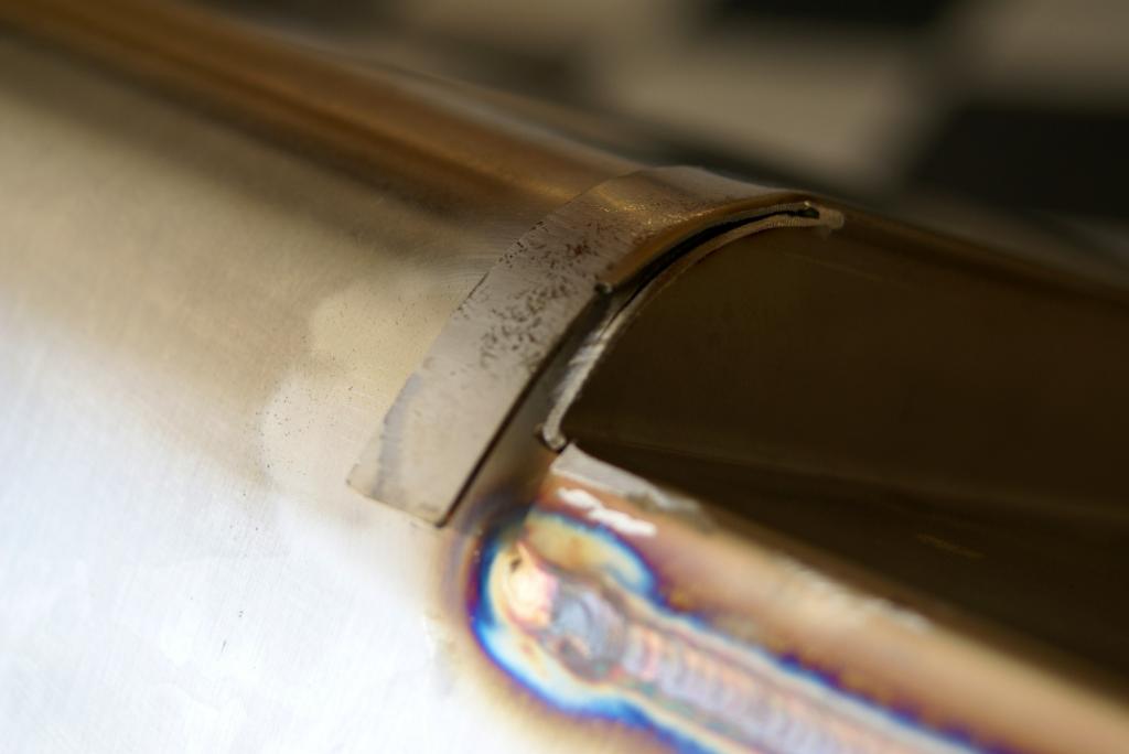

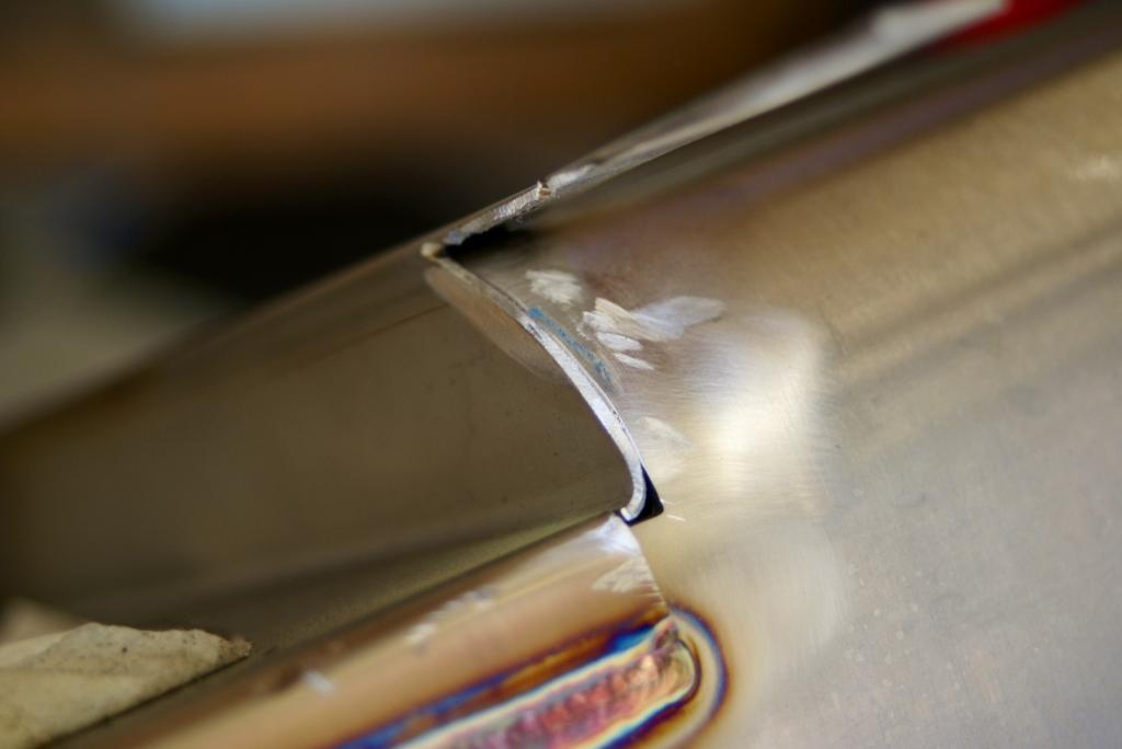

      The only tricky part of welding the new tray in is the corners on the radiused front edge. The following pictures show how I did it.

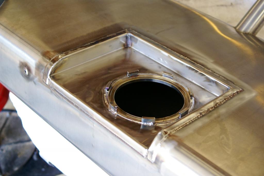

      The installed tray:
      I'm not the best TIG welder in the world but I did pressure test it to 10psi (the point at which the tank begins to bulge) and there were zero leaks first time. I was very happy with that
