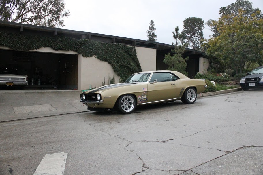

      Hi all. Happy Holidays, hope everyone is well! I took out the Camaro after a month or so, haven't been feeling too hot. The alternator fan came loose and did some nice damage to itself and the upper bracket on the ride home in the rain. Its time to replace this sucker with something nicer. No idea how many amps it even is. It was an over the counter autozone special...
      Setup:
      Check out the fan damage. After verifying it was nothing major, I had to drive home 90 miles in the rain. Didn't sound all too good
      Sure is fun driving in the rain though
