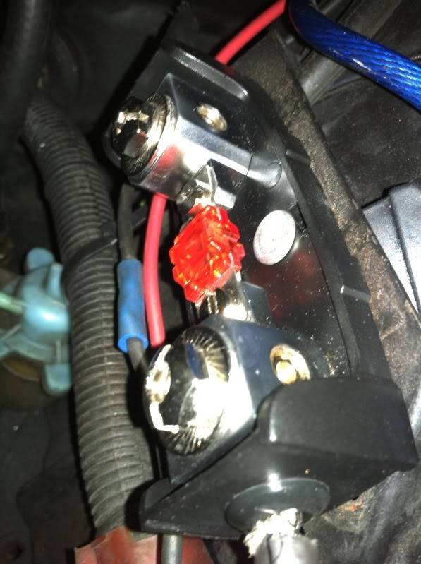

      so i replaced the old fuse box with this new one (same exact box just newer obviously) and made sure all the screws were nice and tight and reconnected to battery and amp doesnt power on...radio works but no sound because no power to amp. anybody got any suggestions?

      Test light will tell you a lot. If the power is getting back to the amp. Check out your remote turn on. It is the small wire in between the power and ground. Hope it helps.
