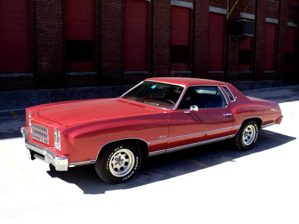

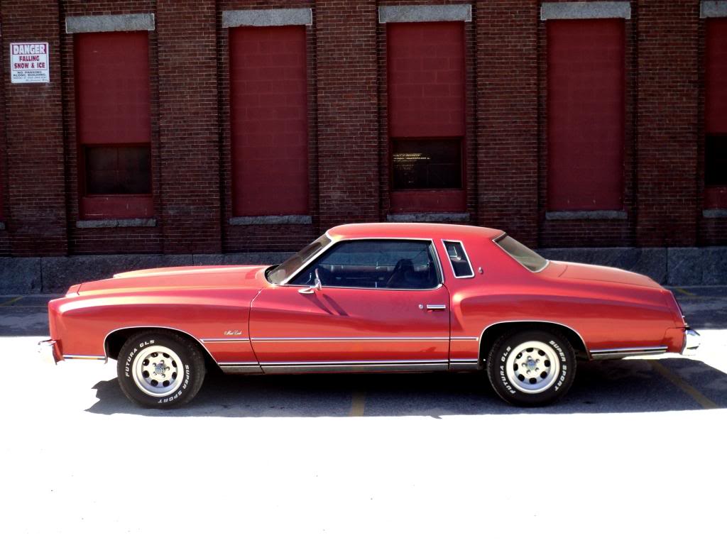

      I picked up this '76 Monte Carlo as a Slo Touring cruiser. It needs a wheel/tire update. I am having trouble finding information about these cars. I am the only one in the world with one of these not trying to fit 26's. Anyone have any idea what the bolt pattern and offset is? How wide can I go?
      Also, I would love to hear some opinions on reasonably priced wheels. The biggest I want to go is 17. I want a traditionaly styled wheel with a little......zaz.
      I searched and found no answer to my quandry.
      Thanks for looking!
      Picture this with a 2" drop;
