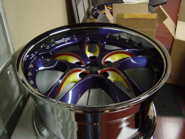

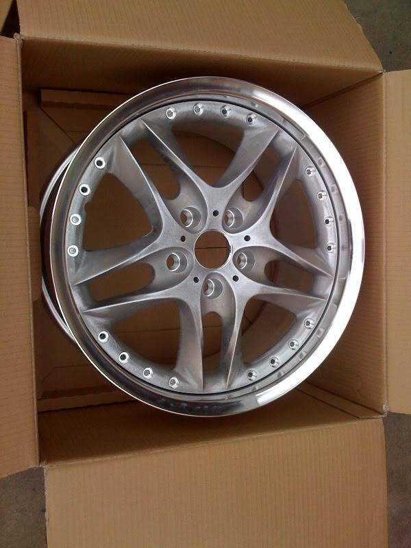

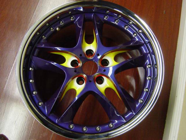

      This is the rim I think I'm going with. 18x9.5 with 5.25 backspace. I already have a set of 275/35/18 tires for the front, and 285/35/18's for the rear.
      I thought about the Bosses.....and the Vision Legends.....had good reasons to consider both. But the wheels you see in the pic are actually a german made 2 piece wheel. And I'm getting them for LESS than the Bosses or Legends. Not as much lip as I'd like, but......budget is important right now, as I have WAY overspent on everything else at this point.
      Literally 2 piece...can remove the center if I want and send it out for coating later. Here is a pic of a set that went on an anniversary vette over in europe. Anniversary vettes were always a bit gaudy, but I think these wheels have potential. I might even get them widened later.
      What do you guys think?

      Ohh god please don't paint them purple. Painted they look like flowers and that ***** only works for beetles not vettes. Other than that I like them in the first picture

      LMAO.....nooo, no, no.........just showing those pics because they show the nature of the shape on the spokes. Although that color scheme does work for that anniversary vette. Dont think I could ever drive one of those....lol. Later for example I could hit the recessed area of the wheel center with a charcoal grey or black. I'm thinking the car may end up House of Kolor Galaxy Grey, but not sure yet. I like their Tangerine too, though its VERY bright.

      Ronal wheels. They arent really here in the states any longer. German make, and technically these are BMW wheels. But I have access to the machinery, so I'm just going to redrill my hubs AND use a set of aluminum hubcentric rings I just picked up for $20. From my research the 5 and up series of BMWs have workable backspacing/offset combos for many of the GM muscle cars. Right around 4.5-5.75 backspacing. So with careful choosing...
      2.54 cm to an inch.......so 25.4 mm to an inch....so a +25 offset means add an inch of backspacing to whatever half the wheel width is. In this case, the wheels are 9.5" Half of that is 4.75"......the offset on these wheels is +13mm (just over half an inch), so total backspacing is 4.75 + .5 = 5.25".

      My research indicates that the GM hubs are 70.3mm, and that the 5 series BMW wheel hub opening was 74.1. Some of the others like the 7 series are less, and you could end up with a wheel that wont fit over your hub....so you have to be careful if you are buying a REAL BMW wheel to know what the hub size is. Most of the aftermarket wheels went with the 74.1 and offered a hubcentric spacer to the BMW guys looking to put them on the cars with smaller hubs.....but this way they fit any 5 series or up.
      Either way....just make sure whatever wheel you buy has the 74.1 hub, not the smaller one. Also, it wouldnt hurt to double check my research for yourself before jumping. LOL
      So according to that research you want a spacer with an outer dimension of 74.1 and an inner dimension of 70.3. Here they are, or you can get them from any internet company that specializes in hubcentric rings.....just have to tell them the size you need.
      http://cgi.ebay.com/ebaymotors/ws/eB...=STRK:MEWAX:IT
      They have a nice chamfered inner edge, and I'm going to lube them liberally with anti-sieze so I can hopefully get them off if necessary.
