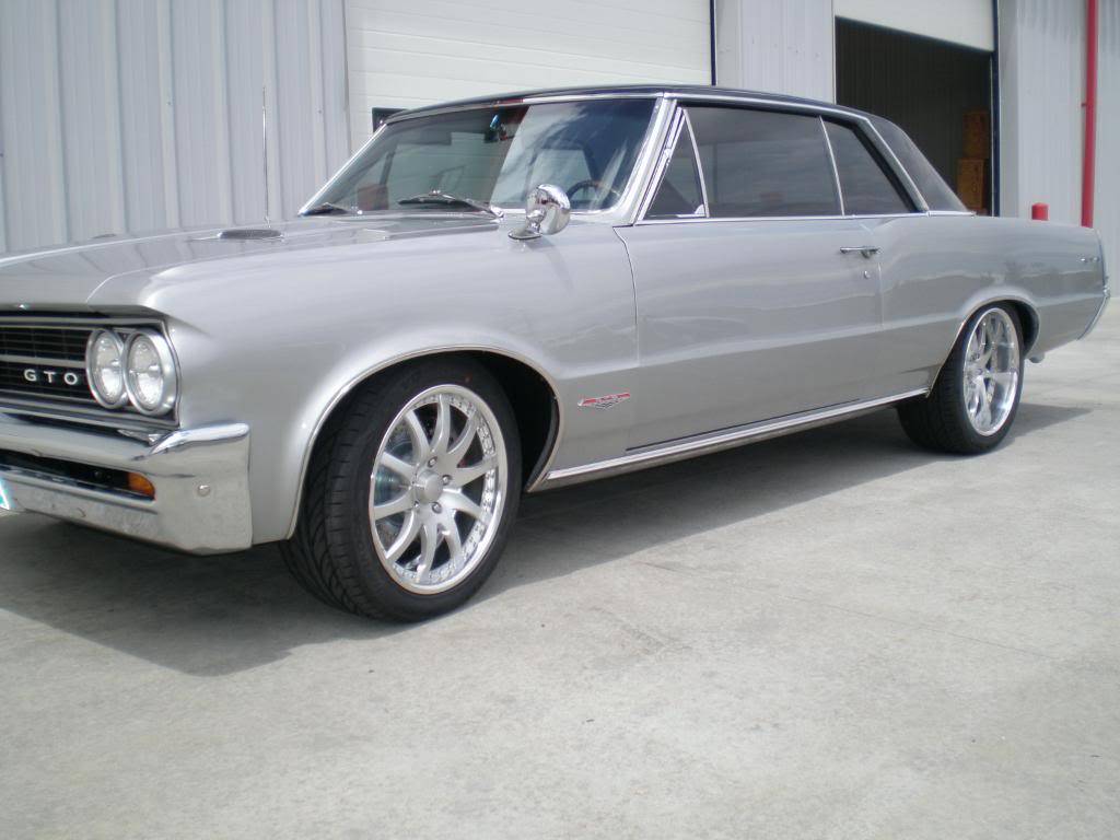

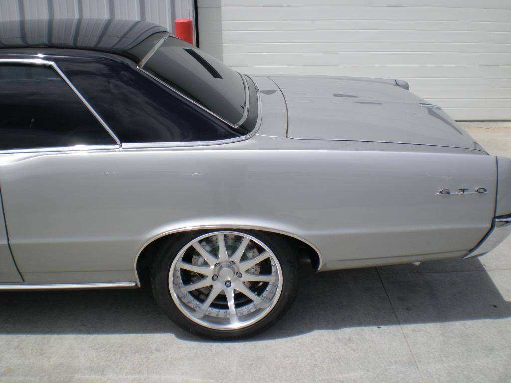

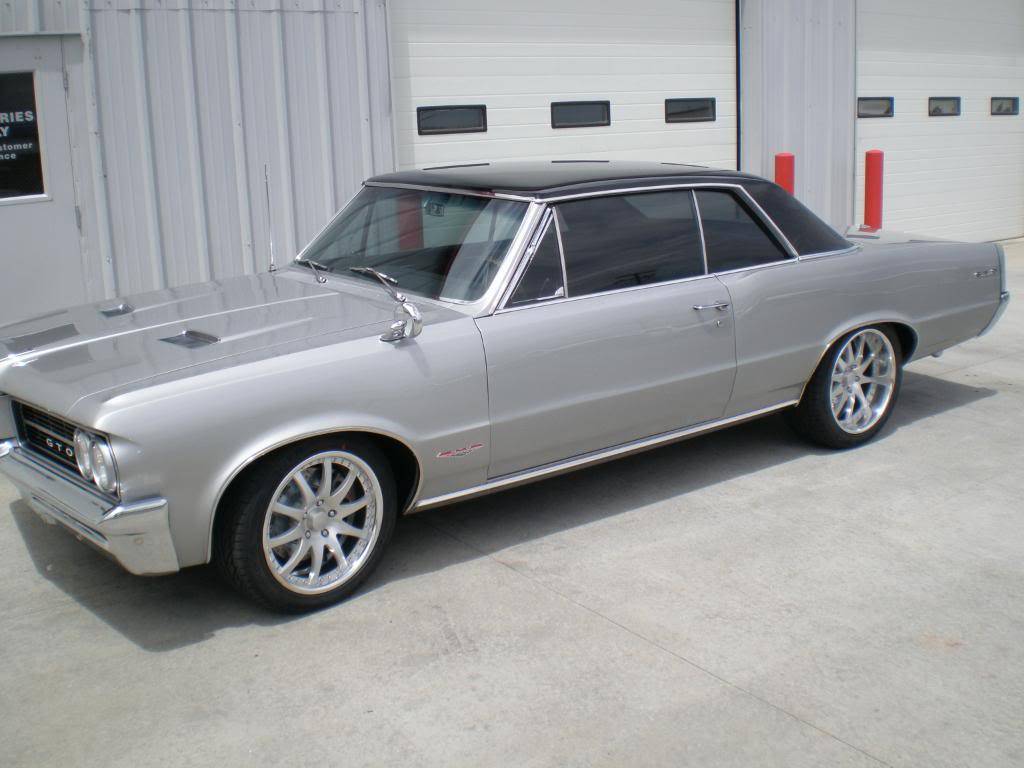

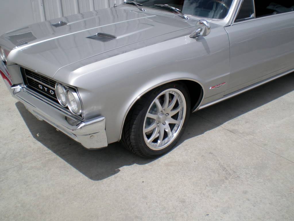

      That sounds so suggestive, doesn't it? Maybe it will pick up some odd Google hits?
      Here is a set of 18 and 19" Rated-Xes we just put on a client's 64 GTO with a full Hotchkis suspension and Baer Brakes. 18x8s up front and this little goat actually holds 19x10s on the back!

      Do you know if any mods had to be done in the back to fit the 10s in the back?

      So can we ask what backspace was used front and rear?.... and is the car tubbed out back?... and is it using the factory width rear axle?
      I just acquired an A-body (1964 Oldsmobile) and would love to put a 10" rim out back- I just don't see enough room back there.

      No problem. The fronts are 5.625" backspace and 6.0 in back with stock axle width and wheelwells. No issues but all A-bodies are not alike so what works on this car does not work on my 64 A-Body and may not work on your Olds.

      What Size are those tires?? it looks like a decent amount of tire out back!
