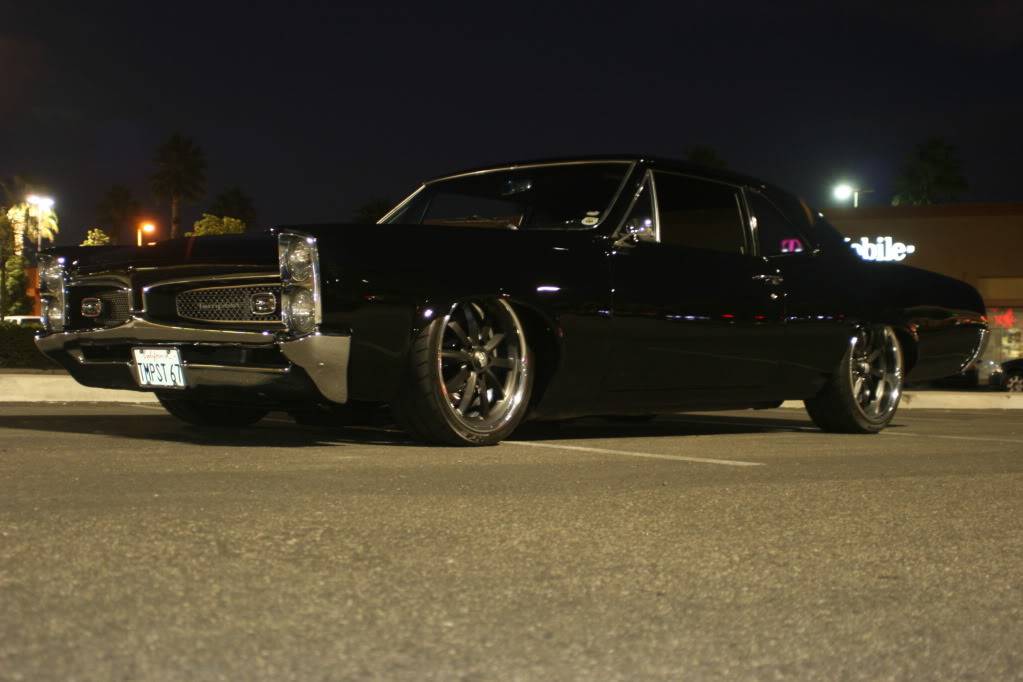

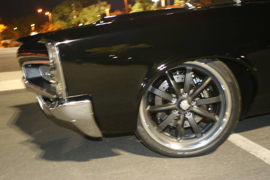

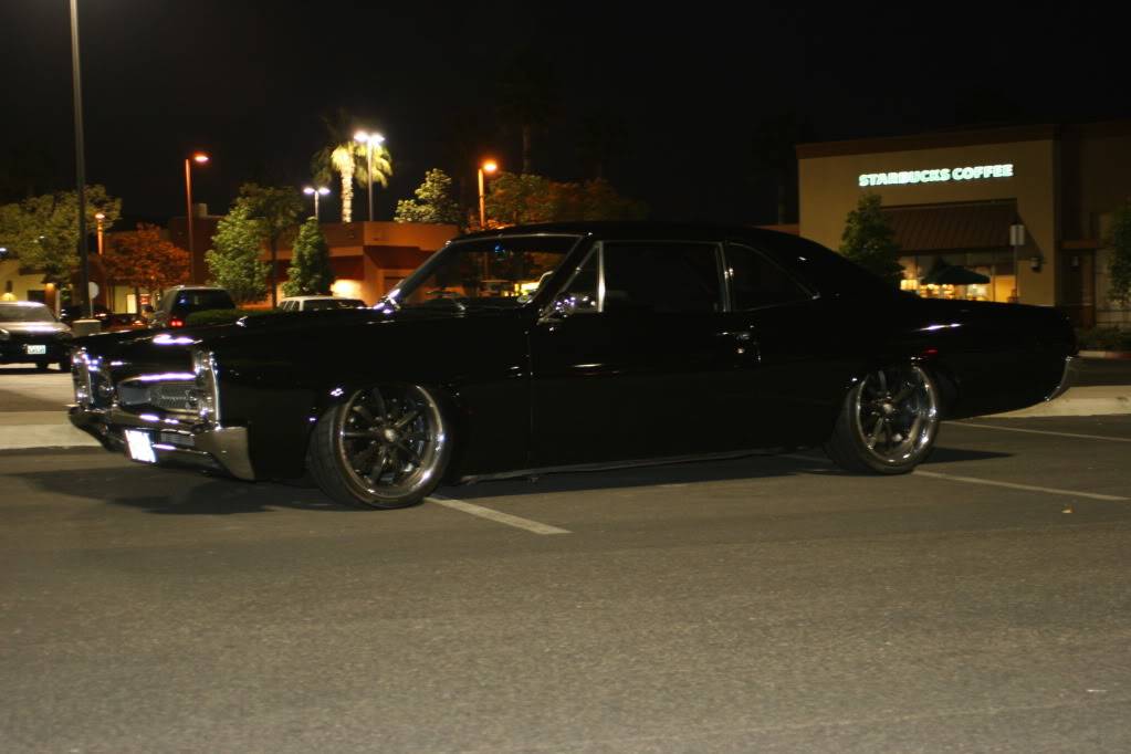

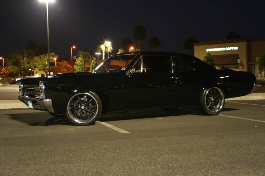

      Here are some pictures of my New Gen Decenio's on my 67 Tempest. Sorry the pictures are a little blurry. I took them at night and the camera flash didn't do so well. I'll take some more pictures in the daylight and post them up. But for now take a look.
      Hey Jon can you post up the specs on the wheels? I know the sizes 19x8 and 20x10, but I forgot what the backspacing is.

      Love the look! What kind of backspace did you need to clear your Wilwood brakes? Gotta get my project back on track after seeing yours.

      I really did not care for the look of that wheel until you guys powdered the center black! That looks great!!!!!!!!!!!!

      Digging it Johnny! We need to get some good shots for the website, so when you get a chance, that would be awesome!!!
      Wheel specs are:
      19x8, 5.5" backspace with 1.5" caliper clearance to clear his brakes and center hub length.
      20x10, 6.375" backspace, with only a .50" pad to help with wheel depth with that backspace. Pad will easily clear the rear brakes Johnny is planning on doing eventually.
