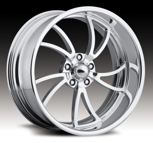

      I have the wheels picked out for my '82 Corvette and am ready to order, but I am running up against tire issues.
      I plan on going with 18x10 in front and 20x12 in rear (adding flares). Going with Pro Wheels Scorpion w/ black center (car will be black)
      However, I am having troubles finding tires for that combination. Stock diameter is 25.6 and I want to go about an inch or so larger to fill out the wheel wells once lowered) I found the Nitto Invo for the rear in 345/25/20 (26.6 diameter) but there doesn't seem to be an 18" for the front with anywhere near the same total diameter or profile. There is a 285/30/19 (25.8 diameter) that will work, but I really wanted to go with 18's up front rather than 19's. Any suggestions? I can get the Nitto combination for around $1500 and sort of want to stay around that budget.)

      That's why I am looking for advice, I am new to this stuff. So, tell me if you think this combo would look fine. Nitto doesn't list sidewall height in the their specs it would appear..
      Front - 19x10 - 285/30/R19 25.79 diameter
      Rear - 20x12 - 345/25/R20 26.65 diameter
      factory tire was a 225/70/15 with a 27.4" diameter all around. I would like to be closer to that diameter, but the rear tire for the 20x12 seems to have really limited choices.
      Here is my other option - Michelin PS2
      Front - 19x10 - 285/35/R19 26.9 diameter
      Rear - 20x12 - 335/30/R20 28 diameter
      Which would look better. Is it worth the few hundred extra for the Michelins?
