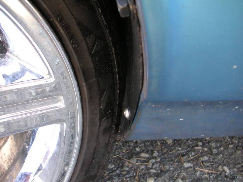

      I need some help wheel and tire gurus! I'm stuffing 18's under my Nova, and having no luck getting them to work. The car itself has been lowered 2" in the front, 1.5" in the rear with a complete Hotchkis TVS kit - including the TVS tuned Bilsteins. Wheel specs: ghetto IROC knock-offs, 18x8 with 4.5" BS. Tire specs: Kumho 245/40/18s. I tried 245/45s... wayyyy too tall.
      Keep in mind, these ugly wheels are my "around the shop" rollers that I picked up for $200. Curbed, peeling, and all around just not my style... but I think they saved me a ton of cash on my new wheels by pointing out that 4.5" BS on an 18x8 ain't gonna work with a 245/40 tire.
      As you can see, its rubbing on the rear of the wheel wells. This rubbing happens on both the inside and outside of the tire when turning either left or right. I'm wondering what will help or hurt:
      • Increasing the BS (I think this is the right thing to do) to 4.875 or *gulp* 5"
      • Going to a 35 series tire? I'd prefer not to have a rubber band for a tire
      • Goind to a 7" wide rim (would rather not) with a 235 or 225 width
      • Take my purse off, and beat in the wheel wells with a deadblow hammer for a little more clearance
      From what I've read, my current set-up should work on a slightly lowered Nova such as mine... but real life is not the same as what you read on the internet...

      Have you changed your brakes on the front also? That could have you out a little farther than stock-sometimes up to .25 to .50 inch. 8's are a little funny on those cars, you need more backspacing, but you have to be careful about hitting suspension parts when you put in that backspacing. I know everyone is into the widest possible--but 7's work well on those cars!!

      Id go 5" BS or if you got room till it hits the tie rod, 5 1/4"

      On my 71 I'm running 18 X 8's with a 40MM offset with a 235/50R18 cuz that's what the tire shop had used and cheap. I get just a bit of rubbing on the frame when I turn hard left I think it was. (Haven't driven yet) LS1 brake conversion, probably needs alignment, Hotchkis 1907 springs and 2207 swaybar.

      check your alignment and find out what your caster reading is. Reduce to gain clearence
      Loosen your subframe and slide it forward, set your alignment.
      modify your wells to fit.
      get rims that fit.

      Oh, I know the alignment is screwed. I made sure of that when I fully rebuilt the suspension with Moog components, Hotchkis suspension, and SpeedTech control arms!
      Subframe... ugh... don't want to. I set it in there using the factory wheelbase specs, and the Alston method for squaring up the frame. Plus, the exhaust, steering box, drivetrain, etc are all in place. No thanks.
      Wheel wells... I might "massage" them with a deadblow hammer just a bit to get me rolling down the road for now.
      Rims. Hell yeah! Waiting for the VWW V40's to come out in 18s... waiting... I may have to settle for something else.

      The Speedtech arms add caster which pushed the wheel back in the wheel opening a bit. Increased caster is a good thing, but too much causes issue to and yours look like it is alot right now. Get the alignment done first. I would go to 4.875 BS and get a alignment, and use the 245/40/18 tires.

      Question: how do I reduce the caster enough to get it so I can drive the car? My alignment shop is only 1/2 mile away. Toe in/out is set by the tie rods, camber in/out is by adding/removing shims... how is caster set?

      but adding more shims to the front or rear bolt move the wheel fore and aft.
      Everett, WA
      501
      Quote Originally Posted by ProdigyCustoms View Post
      Gotcha! Let me try jamming some more shims in the front.
