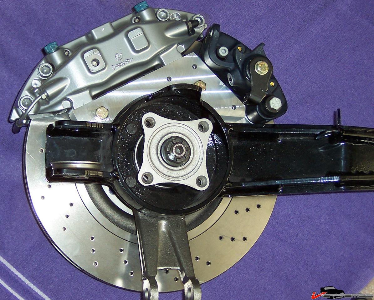

      Hi, I just scored some front fixed calipers from an '04 Viper and some floating rear calipers. Can anyone give me a website that gives rotor/bracket specs to adapt these? I would like them to go onto my 1970 Camaro dropped spindles but need to research further.

      I adapted some 05 Viper Brembo's to a 68 Corvette and have some dimensions. Sorry no dimensions to adapt to the 1970 Camaro. Do you have the caliper mount dimesions for the Camaro?
      http://www.vettemod.com/forum/showthread.php?t=2350

      Wow! those brackets look sharp! Let me check the C to C on mine.

      Thanks, The hardest part was putting the rear brakes together. It was a tight fit with the Brembo parking brake.
      The Viper Brembo calipers are 130mm (5.118") center to center with 12mm bolts. If you can get the exact diameter of your rotors I would be happy to help you come up with a drawing for your brackets.
