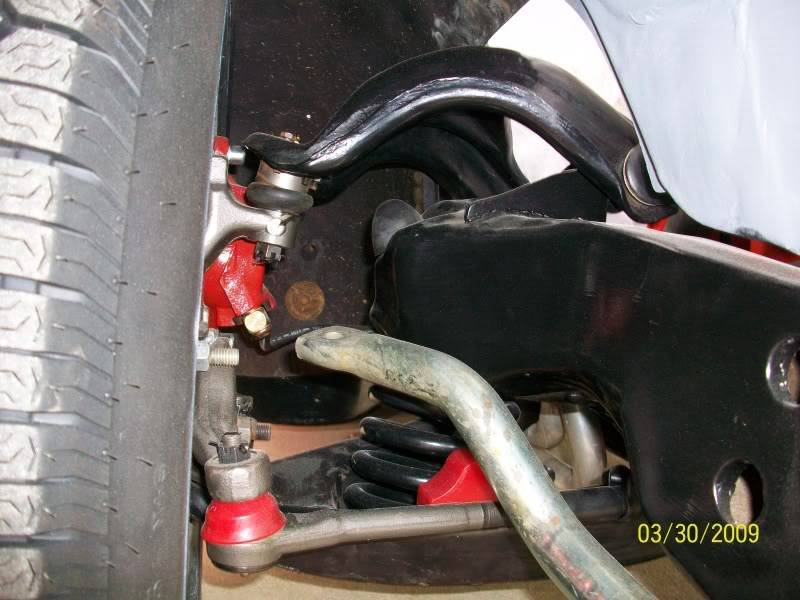

      lowered the stance on my elco. Need adjustable uppers?
      Well, I love the stance on my elco and I really want to keep it that way. Just curious if you guys think that they will be able to align it at the alignment shop?
      If not I was looking at the SC&C stage 2 kit that everyone recommends but I am pretty low already and wondered what the difference would be with
      Just getting the SPC adjustable uppers and getting the kit?
      The tall ball joints make a big difference with the uppers?

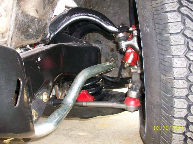

      Anyways here is a pic of the stance first, and then pictures of the upper control arm angle on each side.
      Thoughts? I am assuming I do need to atleast get the adjustable uppers

      Are those 9.5 inch springs if so you definitely will want the adjusters
      Yeah, they are the 9.5 inch springs.
      would you recommend going ahead and spending money on the whole kit?
      or will the uppers do the job, and correct alignment issues?
