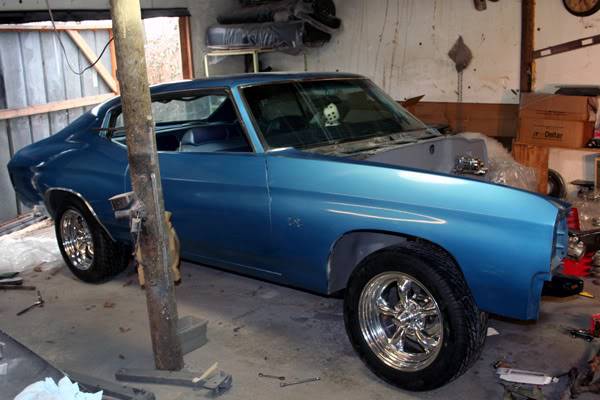

      after months of research i found a wheel tire combination i like (budget included) i wanted 17 inch wheels but i didnt want really low profile tires, this is what i came up with! i figured some one could find it helpful for project!!!
      this is my project....
      Car: 1972 chevelle ss clone
      Wheel Make: american eagle
      Wheel Model:211
      Front Size:17x8
      Front Backspace: 4 inch
      Rear Size:17x9.5
      Rear Backspace: 5.5 inch
      Front Tire Size:255.50.17 nitto 450
      Rear Tire Size:275.50.17 nitto 450
      Suspension mods: stock big block moog springs stock rear springs
      there is no motor or trans or hood so its sits high in the front, and the car is on jackstands on the drivers side so its not level

      nice doesn't look half bad with a 50 series

      Sweeet! You did good.

      I have the EXACT tires on my car now. I think they are perfect for a big A-body car like your Chevelle... but for my smaller 79 Monte, they are too big. Sooooo if anyone wants them they are for sale!
      thanks, it took me a while to come up with the combo, the 40/45 series just seemed a little too small, they would probably look good if the car was lowered but mines going to ride stock, so i went with a muscle car look but still with the modern wheels,
      yes stance is the key! that is one sweet monte carlo! i dont belive i've seen one that year with t-tops! i'm a monte carlo man at heart, had an 84 ls in highschool, a guy hit me and totaled it but now its a big bad boy at the local dirt track... love the way those cars ride! i will own another one! if a grandnational doesnt get to me first
