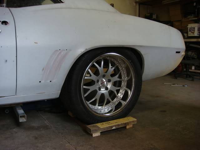

      Just getting the tires up in the wheel wells so I can order my rear housing and snapped a few pics. This is the only one that wasn't blurry! 19x11 Forgelines from frank at Prodigy, tires are 345/35ZR19 Bridgestones. I'll try to post a better one tomorrow.

      Looking cool. Is that a type-o though? 19x11 and a 345 tire?

      and the other centerline in the background looks on with sadness.. ahha

      The Centerline was doing it's best to stay on but it just couldn't do it! No typo on the tire size. I think they look good. Bridgestone recommended a 11.5 rim as the smallest so I thought I could get away with the 11.

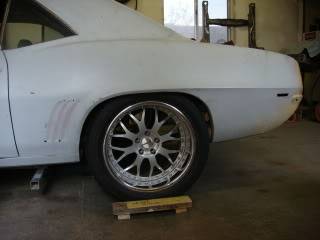

      few more pics. looks like the rear will be around 53.5 inches flange to flange. sounds narrow to me but i measured it three times so far.

      Man those things look good! I almost ordered the WC3P's or the MD3P's from Frank, but instead I went with VR3P's (all chrome).

      53.5" sounds about right to me with that backspace.i'm run 9.5 with 5" backspace and my rear will be 55" axle flange/axle flange and 55.5" rotor/rotor
      my guess is those 19x11 are around a 5.5" backspace?

      Those wheels are sick!!! That is a tall tire any clearance issues? I had to narrow my rim to 12" to get a 345/30/19 to fit.

      Really? I guess I have a misunderstanding of how tire sizes work. I've got 11" wide wheels and am running 315's.
      Oh well... who cares. Looks really cool.

      I got confused with the tire size stuff also, just kept going to the manufactuer to see what they wanted for wheel width. When I saw Bridgestone recommended a 11.5 through 13 for this tire figured i'd try it and see what it looked like. I'm pretty happy with it. I don't normally like the real short sidewalls with the big wheels but these ended up being around 4 inches. Backspacing on the wheel is 5.5, good guess!
