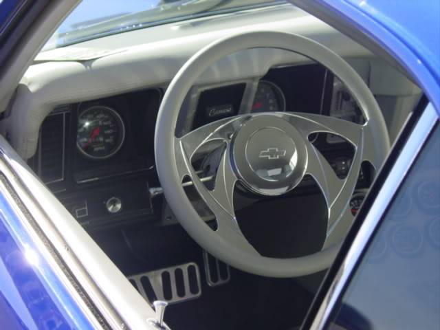

      I took these pictures at a goodguys show a couple years ago because I'm looking at doing the same thing. The guy said he just epoxied them in there. Not sure about any specifics beyond that though...
