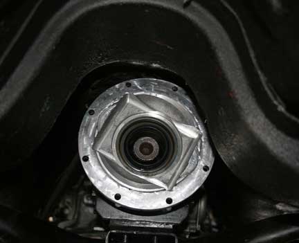

      With the AC in the car I figured it was time to move on to the Gear Vendors. Well, after spending the weekend removing the exhaust, drive shaft and tail piece I'm proud to report that I will be selling a Gear Vendor unit.
      I got as far as installing the adaptor that replaces the tail piece. That's when the problem became really evident. I knew this was an issue but didn't know how bad until I got this far. You see, my drive line has always favored the passenger side of the tunnel. It's enough that you see it when you're under the car. It was really evident with the additional 3-4 inches of the adaptor.
      End result is that the Gear Vendor won't fit unless we cut the car up and section the floor pan. That's not an option for me, especially this late in the game.
      It does appear that, if you were perfectly centered, you could make it fit an F-body. You would have to cut the center seat belt support brace and even then it would be very close.
      So I'll either run the HRPT with 3.42 gears or I'll swap to the other rear end with the 2.41 gears.
      Pics:
