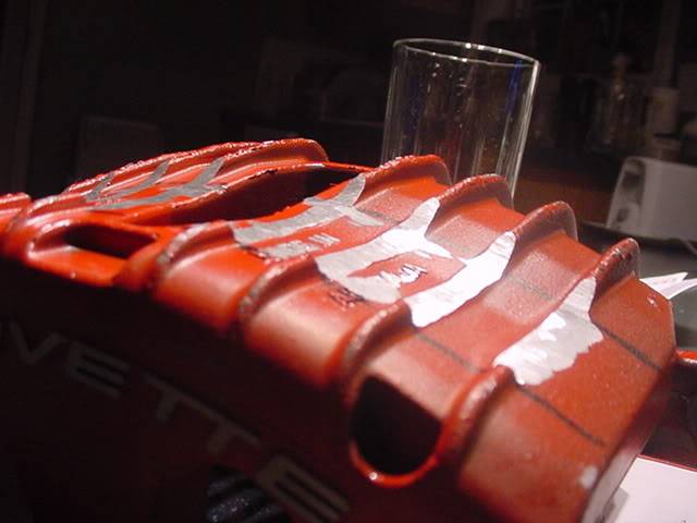

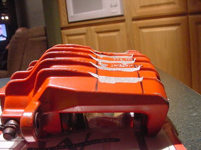

      Well started assembling the wole setup today only to find that I have a clearance issue with my Coys and the c5 calipers. So I had to make some room.
      This little guy was touching the fins on the calipers.
      The overall clearance is very tight. I'm thinking maybe those 18's would not have been a bad idea after all.

      Ouch! Those fins are not cosmetic, they are actually the stiffening ribs to support that already fairly thin caliper throat. You may wind up with a fair amount of caliper flex on hard braking...worst case maybe a broken caliper.
      155
      Yeah I know they are for strength but I dont really have a choice...
      I dont think it will be that bad because I was looking at a set of ls1 calipers I have laying around. They are also made by PBR and the look very close to C5 caliper except the fins do not reach the front of the caliper.

      Aren't C6 calipers the same design but without fins? Could be wrong on that one...
      155
      Quote Originally Posted by matthimself456
      Interesting.. maybe I shoulda gotten those...
      1970 chevelle - awaiting heart transplant
      Rochester, NY
      177
      If Im right it just means they should be ok with the fins ground like you did. I certainly wouldn't buy whole new calipers. With a fresh coat of paint I think theyll even look ok.

      155
      I got spoke clearance alright. About 1/4 inch all around.
      The "hidden" valve stem is the problem here. Even with the fins gone, I cant use the protecting cap on the stem.
