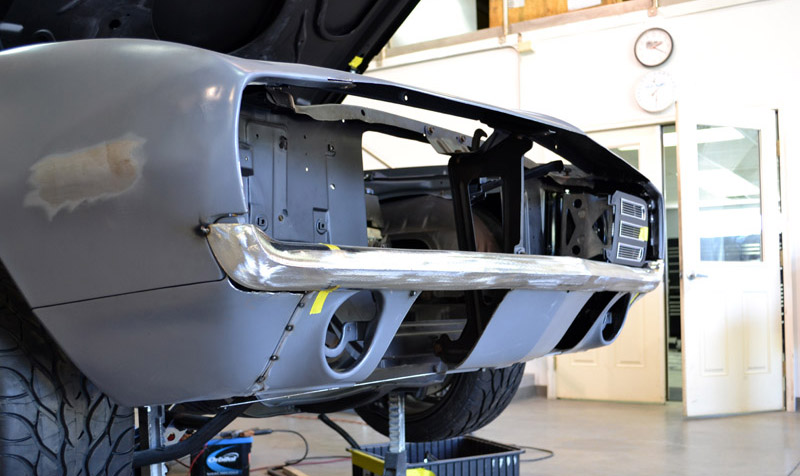

      Getting the doors flush were an initial priority. Kurt (one of the builders) decided to put the rear bumper flush along the sides, should look really clean.
      Ringbrothers hood hinge

      A few more updates on the Camaro.
      The car got tigercage'd
      Picture of the original bumper being modified
      Working on the lower half of the rear end, exhaust ports

      Bumper laying flush with the sides
      Extending the lower sides a couple inches for a more robust look.

      Yeah slightly, the rear exhaust ports were changed but everything should remain pretty close to the original
      Here's a little more recent shot of the rear end:
      Changed up the side vents, this picture doesn't show it but we cut a tunnel out through the wheel well so the vents are actually functional.
