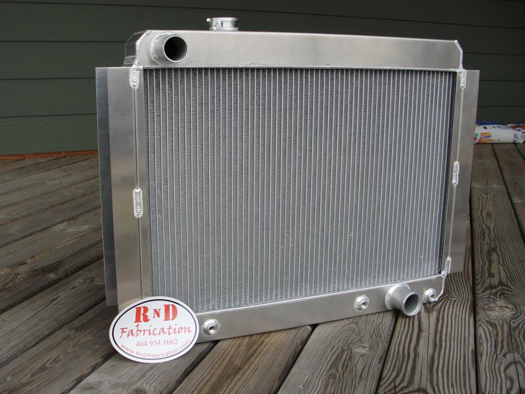

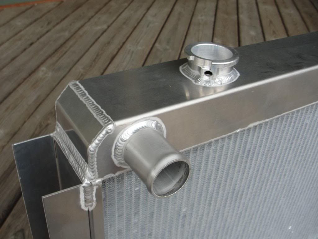

      This R n D Fabrication radiator is a thing of beauty! We're honored that Sparky is allowing us to test fit and put it to the test in Deb's wagon.
      Check out the welds.

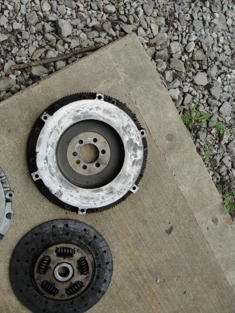

      Well, the wagon sure has taken a back seat to the 66 over the winter but absolutely needed a few things done before taking it to the Heidts event next weekend. Obviously after running it fairly hard at four events last year it needed a thorough bolt tightening and general inspection, oil change and lube, new harness bar built, new front tires (had been rubbing on the inner fenders) and most importantly, have the flywheel resurfaced and replace the clutch disc and pressure plate.
      All was going pretty well until we pulled the transmission and noticed that the throwout bearing guide tube was broken off and just flopping around on the input shaft. After an emergency text message to Mark Bowler on Sunday I realized we had a problem. Note: Important smart people should never give me their cell numbers... Make a phone call to RPM transmissions in Anderson, Indiana this morning and they had the part. Ran up there this afternoon and should get the trans back together tomorrow afternoon. Hopefully back in the car too.
      New harness bar so Sam and I can confortably drive the wagon. Deb was fine with the old one...
      I think Deb and Sam ride the clutch ride the clutch too much and this is the result. Easy to blame other people!
      It was hard to tell the guide tube was broken.

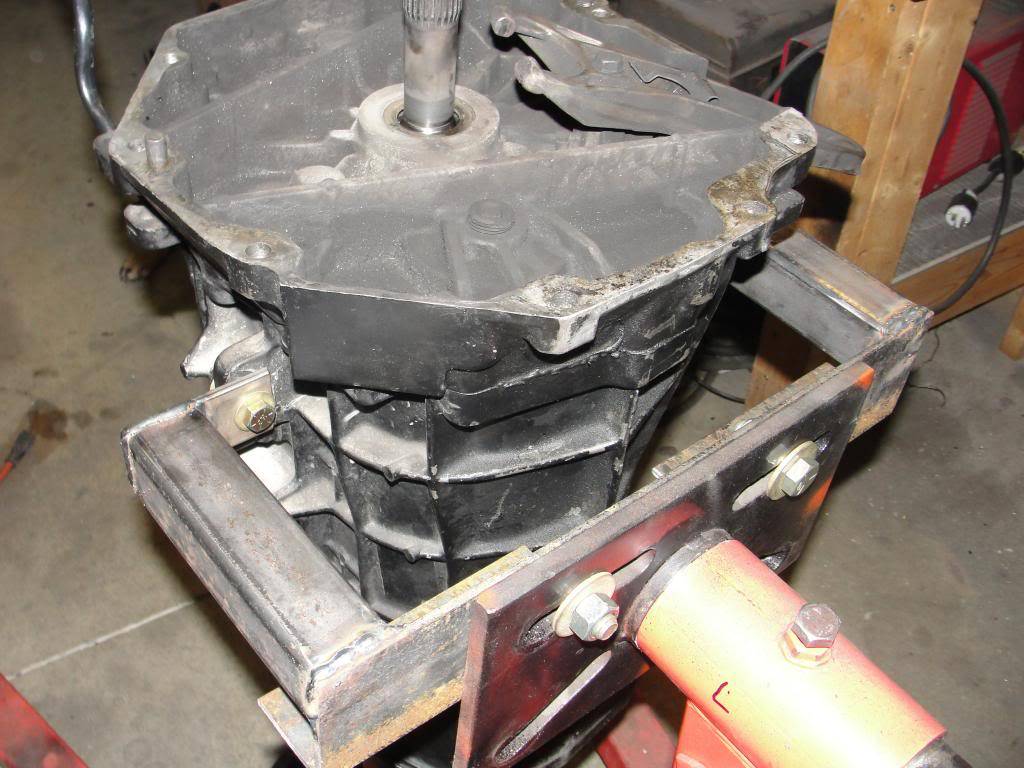

      I built this bracket to hold the trans while we took the mid-plate off. Normally special tools take way too long to build, but this one was fairly quick.
