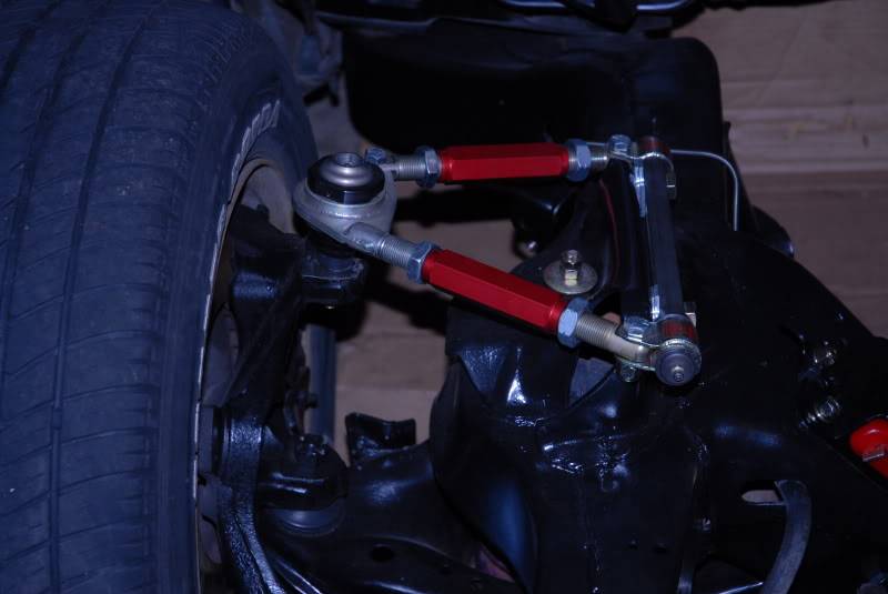

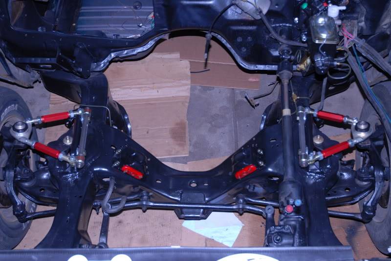

      SPC adjustable upper arms (2nd gen Camaro with longer adjuster sleeves) with tall ball joints (thanks to Mark at SC & C)

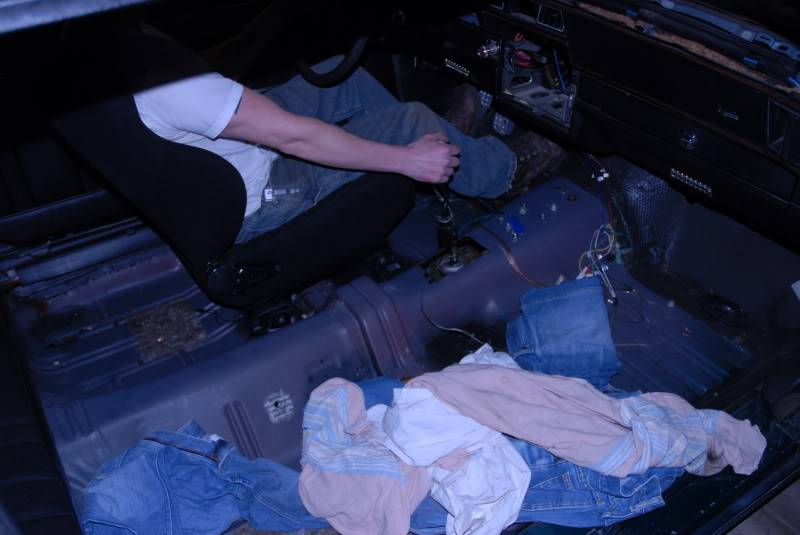

      Interior with bucket seat mounts welded in

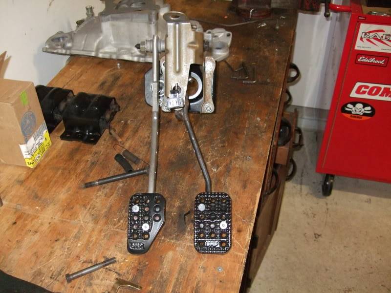

      Pedal assembly as put together on the bench

      Engine bay with SPC arms and suspension in
      Close up of the tall ball joint

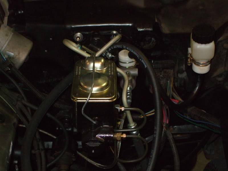

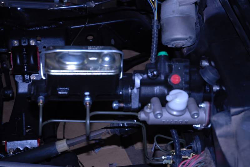

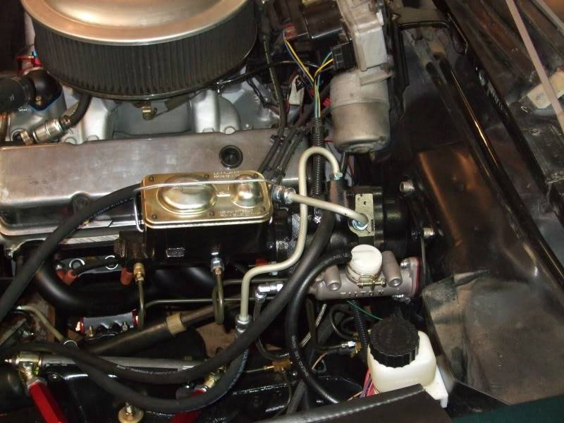

      Hydraboost and clutch master cylinder in final location

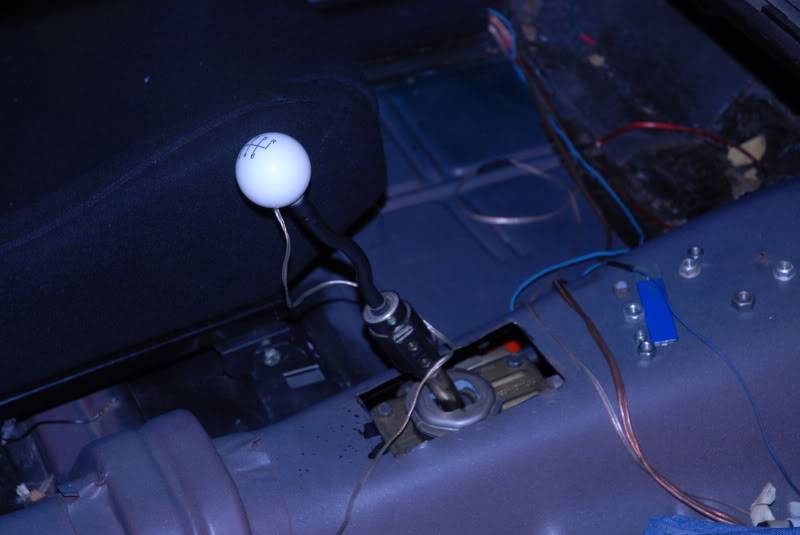

      Here are the pedals in the car and the shifter location

      this body style never came with a manual trans option (GM's mistake) I made the pedals to work with the factory style hydo-boost and mounted the clutch master on a bracket that piggy-backs on the hydro-boost mount.

      I would love to hear more about the Hydraboost and how it works. I have considered making my Custom Cruiser manual. I have both a New Venture Gear 5spd and a Muncie M20. The New Venture Gear would reguire modifying the bellhousing to mate to my Olds engine but thta's no biggie. It's kinda cool seeing anothe B-Body on here. It's a great build. Keep us updated.

      These are the stock floors we just cut out the bucket seat mounts from a donor car in a junk yard. That way we could just weld the factory style mounts in on the original floor. We positioned the seats to determine where to put them and the seats dropped right in.
      The floors are pristine. Not a spot of rust and solid.

      the floors are original and really that clean. Its one of the reasons
      I decided to build this car. I'm not sure where to get replacements but any B-body floor through '96 should work. My bucket set studs came out of a '93 and the floor pans look the same.

      Were did you get the pedal set from? i used a set from a 90 camaro for mine. I also have a spare a/c delete heater box.
