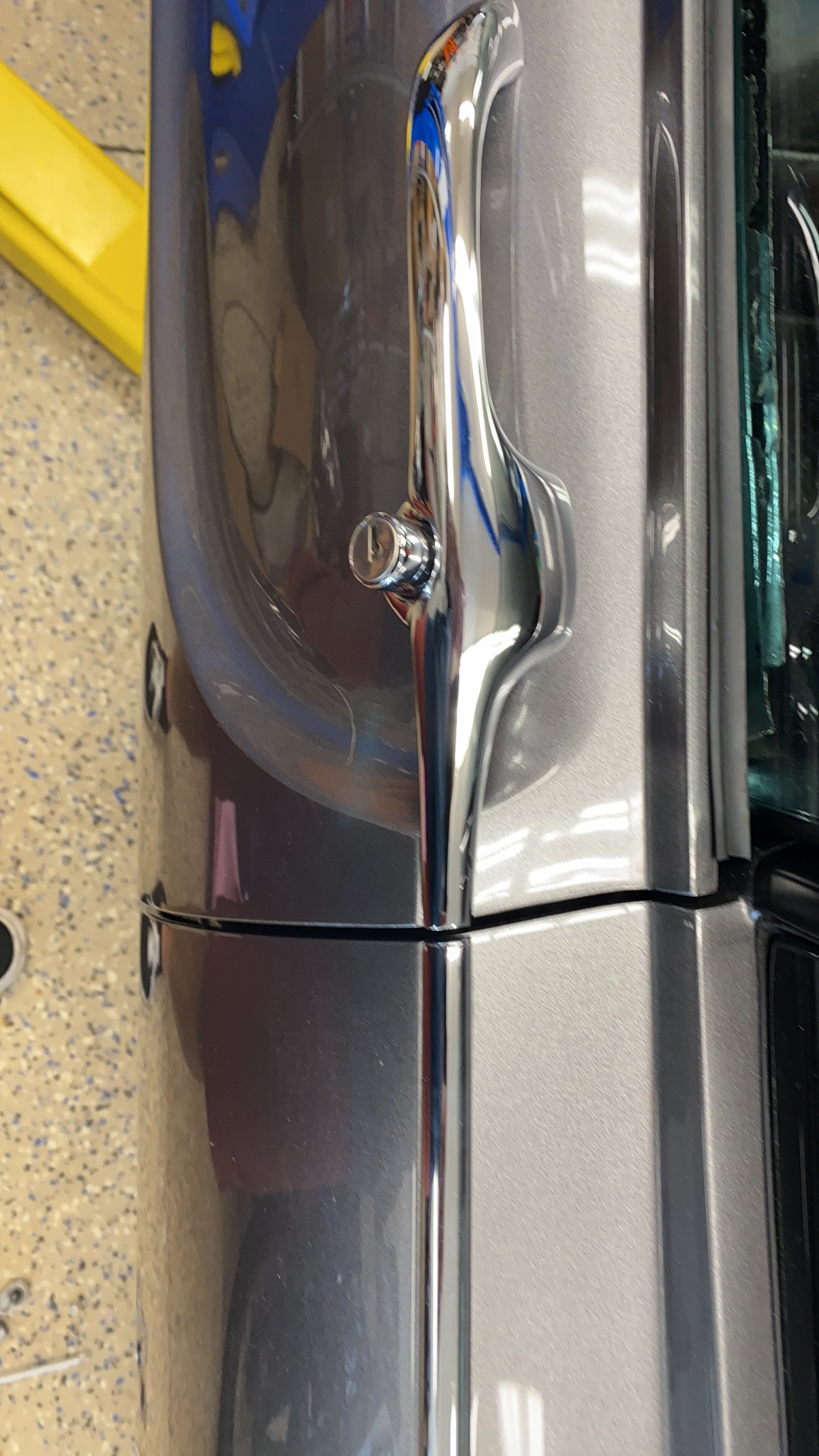

      This may be the last update until I get the car running. I got my door handles installed again and the fit is much better. The transition from the new trim to the original handle is much better now.
      I have a couple small item to do now then the car is ready to go to the tuner. I need to adjust the steering linkage. The u-joint on the column just isnít getting enough engagement. I also need to set the pinion angle and put in some fuel. If I get bored I will start working on setting up the track monitoring setup and the computer side of the ABS.
