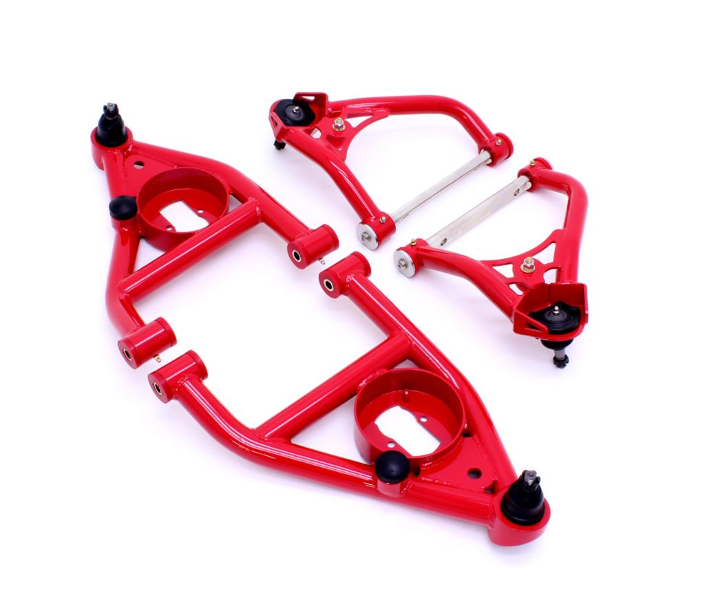

      BMR Releases New Product: A-arms for 67-69 Camaro, Firebird, 68-74 Nova (AAP001)
      BMR Suspension
      A-arms for 67-69 Camaro, 67-69 Firebird, and 68-74 Nova
      Improve handling and front end stability in your 67-69 Camaro, 67-69 Firebird, or 68-74 Nova with an A-arm Package from BMR Suspension. Manufactured from 1.25” and 1.5” DOM tubing and laser cut 3/16” mounting plates, both arms feature low-deflection, internally-fluted polyurethane bushings with easy-to-access grease fittings. Upper A-arms feature offset CNC machined cross-shafts to provide a shorter shim stack for lowered vehicles. These A-arms feature 4 additional degrees of positive caster for increased high speed stability and increased camber gain while turning. The BMR A-arm Package (AAP001) will outperform the OE arms in every aspect – weight, function, strength, and durability. Upper A-arms (AA005) and Lower A-arms (AA006) also sold individually. Available in red and black hammertone powdercoat finishes. Installation time of 4-5 hours.

      Just wanted to point out that we will also have an upgrade option for the upper arms available in a few weeks that comes equipped with Delrin bushings and Pro-Forged tall ball joints.

      Hi I'm considering your lower arms for 70 Nova. Do I understand correctly that the lowers have some additional caster built in by moving the lower balljoint forward some? Are these compatible with both stock springs and coil overs?
      Called and confirmed the lower ball joint is moved forward to add 2deg built-in caster and the shock mounting is designed to support both stock springs or coil overs.

      I bought these lowers for my '70 Nova and installed. Build quality and finish was very nice. The preinstalled ball joints were ProForged. The frame pivot poly bushings are greaseable, but the zerk fittings could not be reached with a standard straight grease gun. I found a 90 degree fitting that slides on from the side of the zerk that works great. I had one major issue, however, which is that the spring pockets are metal-on-metal. My coil springs (600lb/in AFCO 5x9.5 w/ AFCO hidden adjustable adjusters at the frame) rubbed the insides of the pockets and made a horrible, very unacceptable noise. I found a local friend with a set of take-off coil spring rubber isolators from his Hotchkis arms. They did not fit the BMR lowers due to being about 5.5" diameter while the spring pockets are about 5-1/4" ID on the arms, so I cut the outside diameter using a vertical bandsaw and then split them (like a split washer) so they could be installed down into the BMR lower pocket. Once installed the noise was eliminated, however the rubber isolators did lift the car some, so I took it apart again and adjusted my spacers to get ride height back where I wanted it.
      Also when combined with Global West uppers (which add all the caster into the top arm while BMR's system is to add some in the lower and some at the top), the least caster I can achieve with shims maxed on one of my cross shaft studs is +8deg with -1.5deg camber. I actually really like how the car drives down the road with this much caster (lots of return to center tendency, extremely hard to steer it without the power steering going), but we'll see once I do my first autocross event. I'm curious to see if there will be noticeable bumpsteer or other ill effects. For what it's worth I also have done the Gouldstrand mod.
      Ultimately I think these arms are a good option if you want to use coilovers, but based on my experience you might risk some major noise if you use conventional coil springs.
