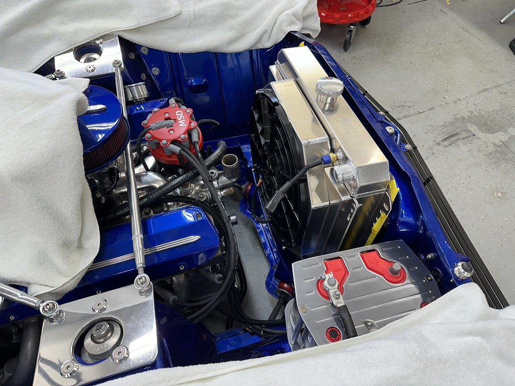

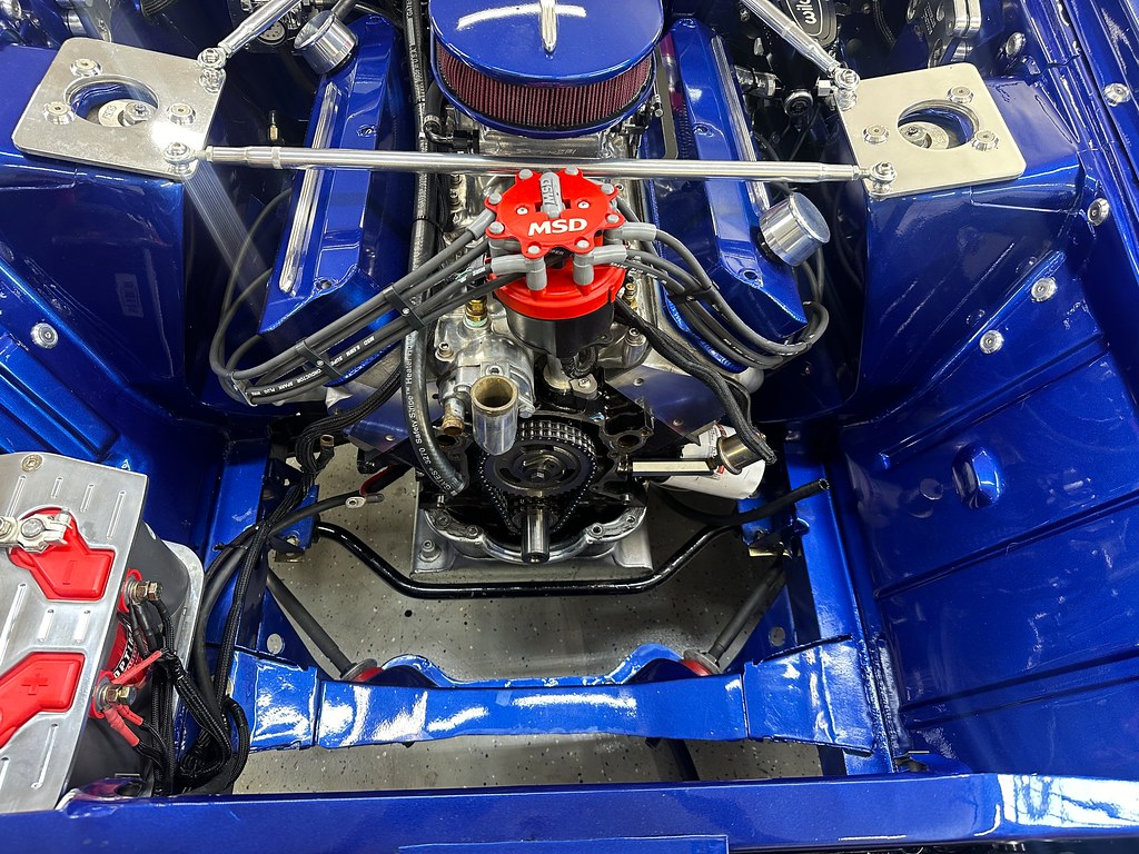

      Finally finishing up the strut tower brace project I started a good while back. These cars had factory supports from the firewall to the towers. Those were deleted when the car was built. The towers are notched. Guess they thought that was good enough. The guys at RRS suspension were pretty adamant that the car needed bracing so I fabbed up supports from the firewall to the towers and across the towers. Thankfully enough room to fit the swedged rods between the Sniper and the distributor. The swedged rods, heim joints, spacers and nuts for the rods from Speedway. Couple chunks of 1/4" 6061 off Amazon and a bunch of stainless bolts and such from my local bolt and screw supply.

      Finally got around to making up some new plug wires. Not my favorite thing to do but 3 of the old ones were pretty toasty.

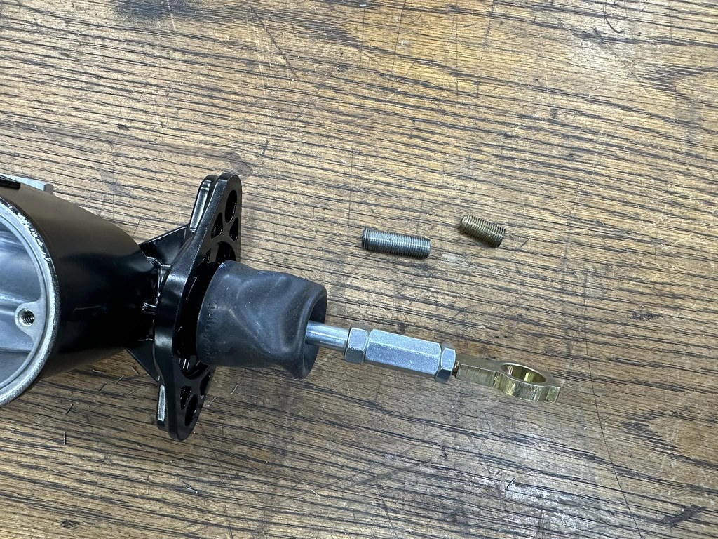

      On to the next weird issue with this car. The brakes have never seemed right. It stops but not like it should. Figured out that it has a 1 1/8" bore master on it. Called Wilwood and went over the brake components on the car. RRS stage 2 discs on the front with Wilwood Forged Dynapro discs on the rear. They suggested a 7/8" bore to match up with what I have. Still has the stock 5:1 pedal in it.
      Changed that out today. Bought and adjustable pushrod kit. Had to cut 2" total off the rods and thread the rod in the master 1 1/4" more to get it dialed in. Took way too long to get the master bench bled but finally got everything swapped over. What an amazing difference. Nice to have brakes that work as they should now!

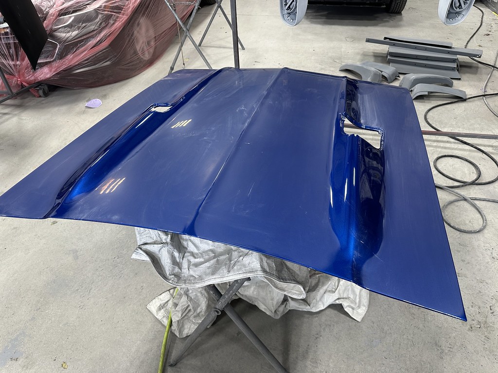

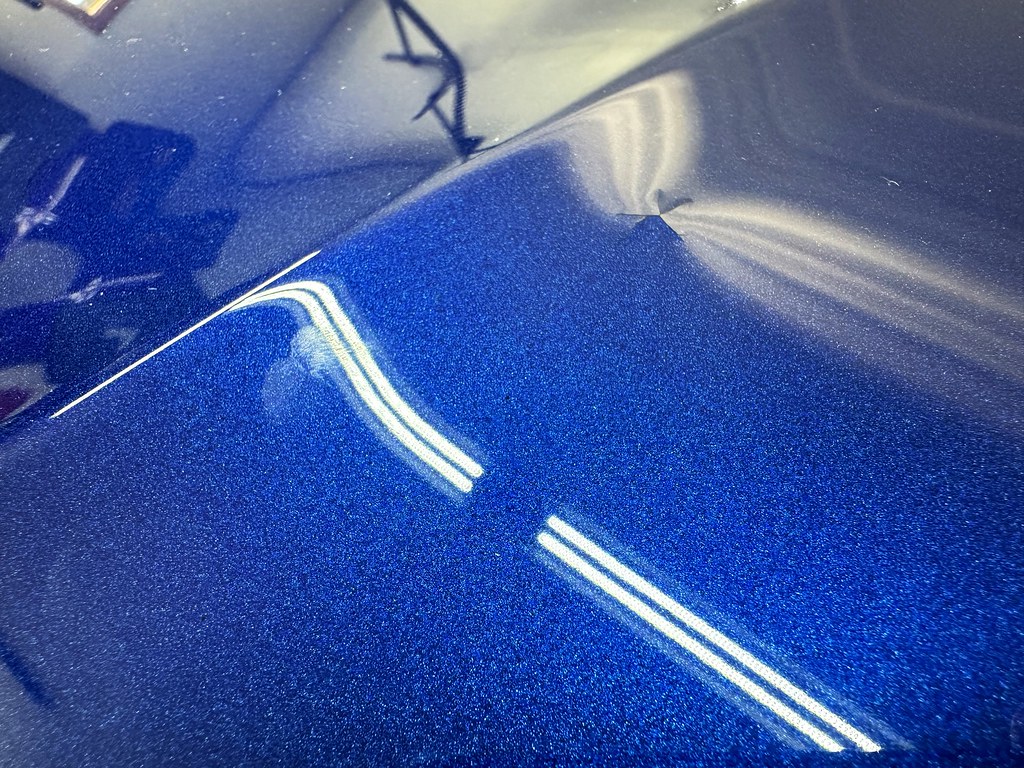

      Well, it's been an interesting week. Started out with a total idiot move on my part. I was working under the hood and forgot that my pocket flashlight was laying on the air cleaner and shut the hood. Result was a pump knot outie that cracked the paint on both sides of the hood.
      Sigh...
      Thankfully my buddy and my ex painter when I was running a shop came to the rescue. The car had some existing chips on the left side of the hood and the left fender also had chips and what looked like an elbow dent that someone had tried to PDR and failed on the top when I bought it. I had touched up the chips already and planned to get all of this taken care of over the winter but apparently winter came early.
      Big chip on the cowl fixed and in primer.
      Everything repaired and ready to go in the booth.
      Shot and color sanding under way.
      Back together and polishing.
      Everything back together and final polish on the new paint and a polish refresh underway at another buddy's detail shop.
      https://youtube.com/shorts/QxoD1f26m...zoGCqwrPjP-IAw
      The plus to all of this is it made the car much better overall. Still feel like a total idiot though. Anyway, back to your regularly scheduled programming.

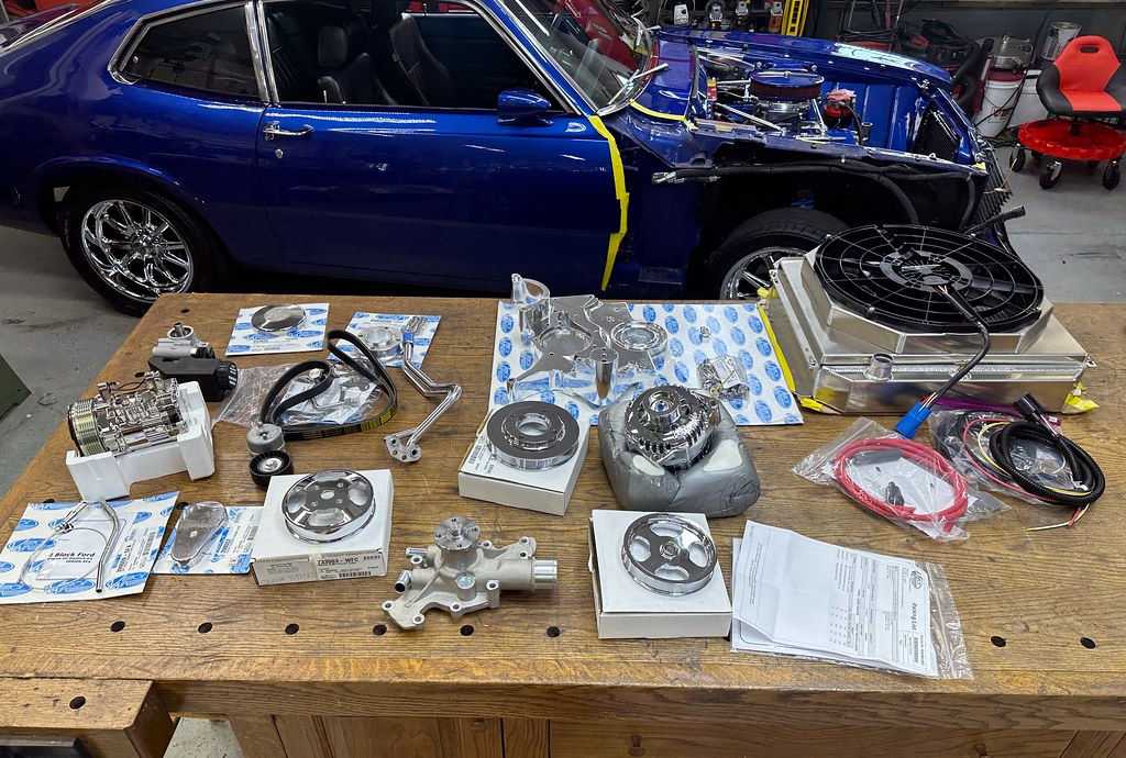

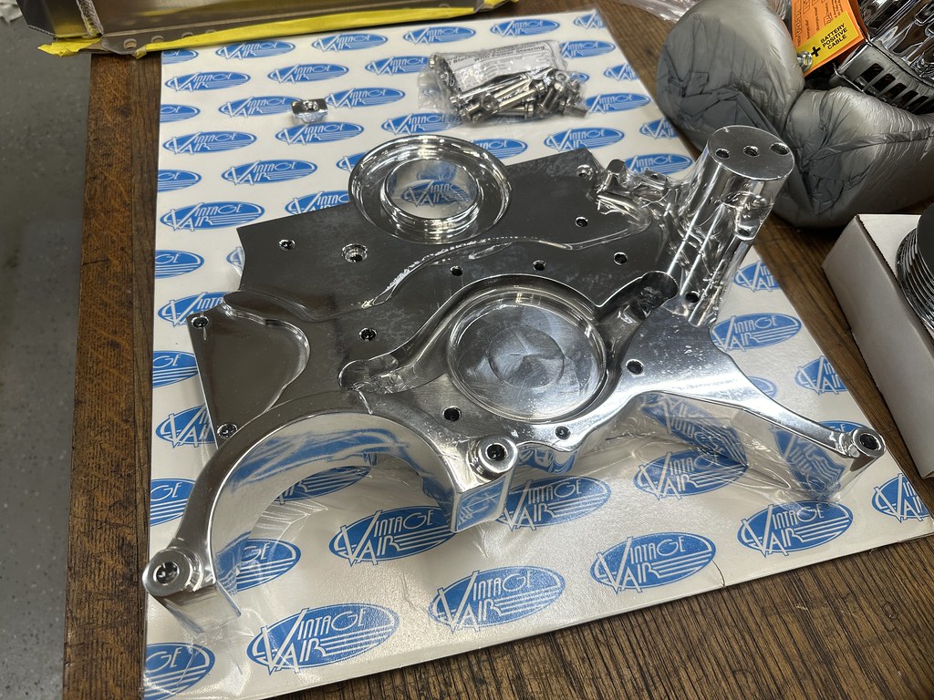

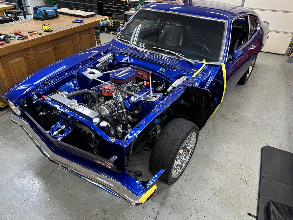

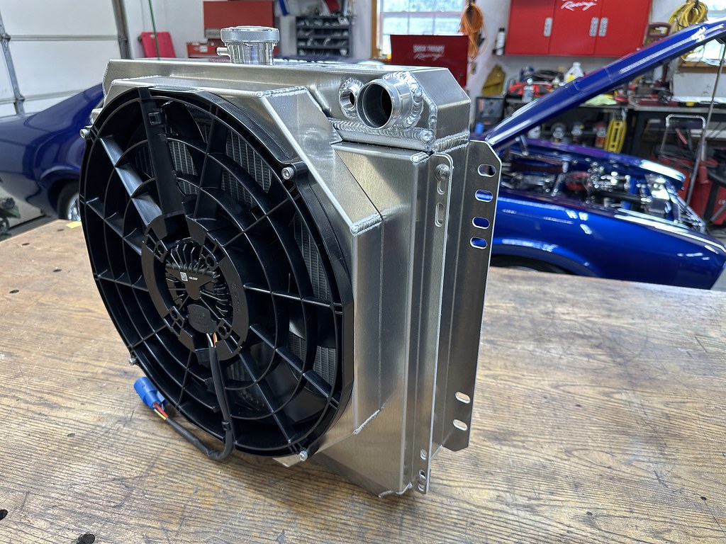

      On to the next projects. The car does not like traffic and temps over 90. Even without running the A/C it's up around 220. I am determined to be able to drive anywhere, anytime and run the A/C. Been waiting for 2 months for these parts. Have the max cool Wizard radiator, shroud and brushless fan. Took 6 weeks bu that was expected. What wasn't exactly expected was the Vintage Air front runner that's been on backorder for 2 months. Finally got a tracking a couple days ago and began the disassembly.
      FedEx dropped the front runner off today and I must say, it was worth the wait. what a super nice piece of engineering and parts. I chose the VA kit becasue it is much shorter than any other front drive for the small block Ford. They use a huge back plate that replaces the timing cover and everything bolts to that. They also use a mid 90's Explorer water pump which is also way shorter than the typical SBF pump.
      I've been cleaning and touching up under the hood. Pulled the hood and the right fender to aid with the install and the rerouting of the A/C hoses and heater hose for the VA kit. I'm shooting video so will have that up once we get all these parts in and functioning.
