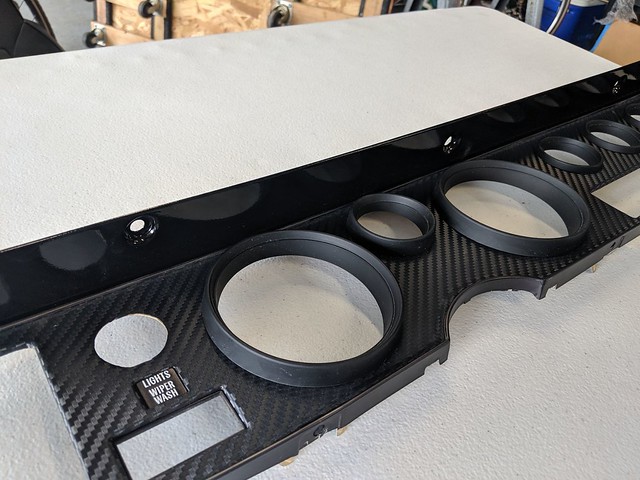

      Close up of dash bezel.
      IMG_20190901_134428 by Rob Armstrong, on Flickr

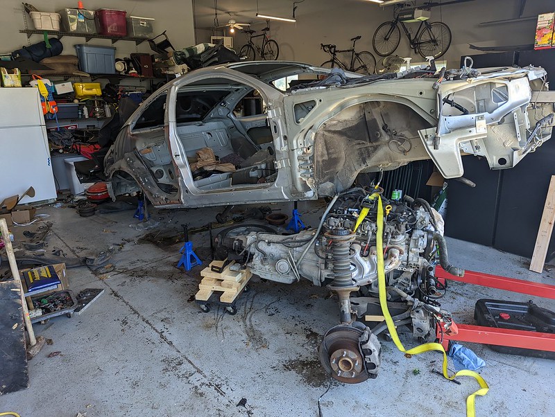

      In February of 2022 I changed directions with my build. Again.
      Picked up a 2004 GTO with only 70K miles and bone stock. Plan is to swap the LS1 and 4L60 into the T/A, along with the seats. My Holley Sniper system was still on backorder from Holley so I was able to cancel that order and ordered the Holley Sniper EFI tank and Holley engine and transmission mounts.
      Here is the GTO when I got it home.
      PXL_20220224_142604663 by Rob Armstrong, on Flickr
      And here it is mostly picked over! :shock:
      PXL_20220426_175341879 by Rob Armstrong, on Flickr
      I did some sketchy **** and pulled the motor and trans out from underneath the GTO using my engine hoist and some jack stands under the back end. I was pretty happy with how easily it came out, but my wife was less than impressed with my creativity. Something about how she would finally get to cash in that big life insurance policy when it fell on me .
      Got the chain hooked up to the top of the radiator support to start lifting it. Engine and transmission were supported by a couple of furniture moving dollies.
      PXL_20220617_202110263 by Rob Armstrong, on Flickr
      That worked fairly well but I couldn't get the front end high enough so there was some more sketchy **** involving a 2x4 supporting the those thing while I reattached the hoist arm to a lower anchor point.
      PXL_20220617_205033597 by Rob Armstrong, on Flickr
      I finally got the body high enough to roll the engine/trans combo out from underneath it!
      PXL_20220617_210010511 by Rob Armstrong, on Flickr
