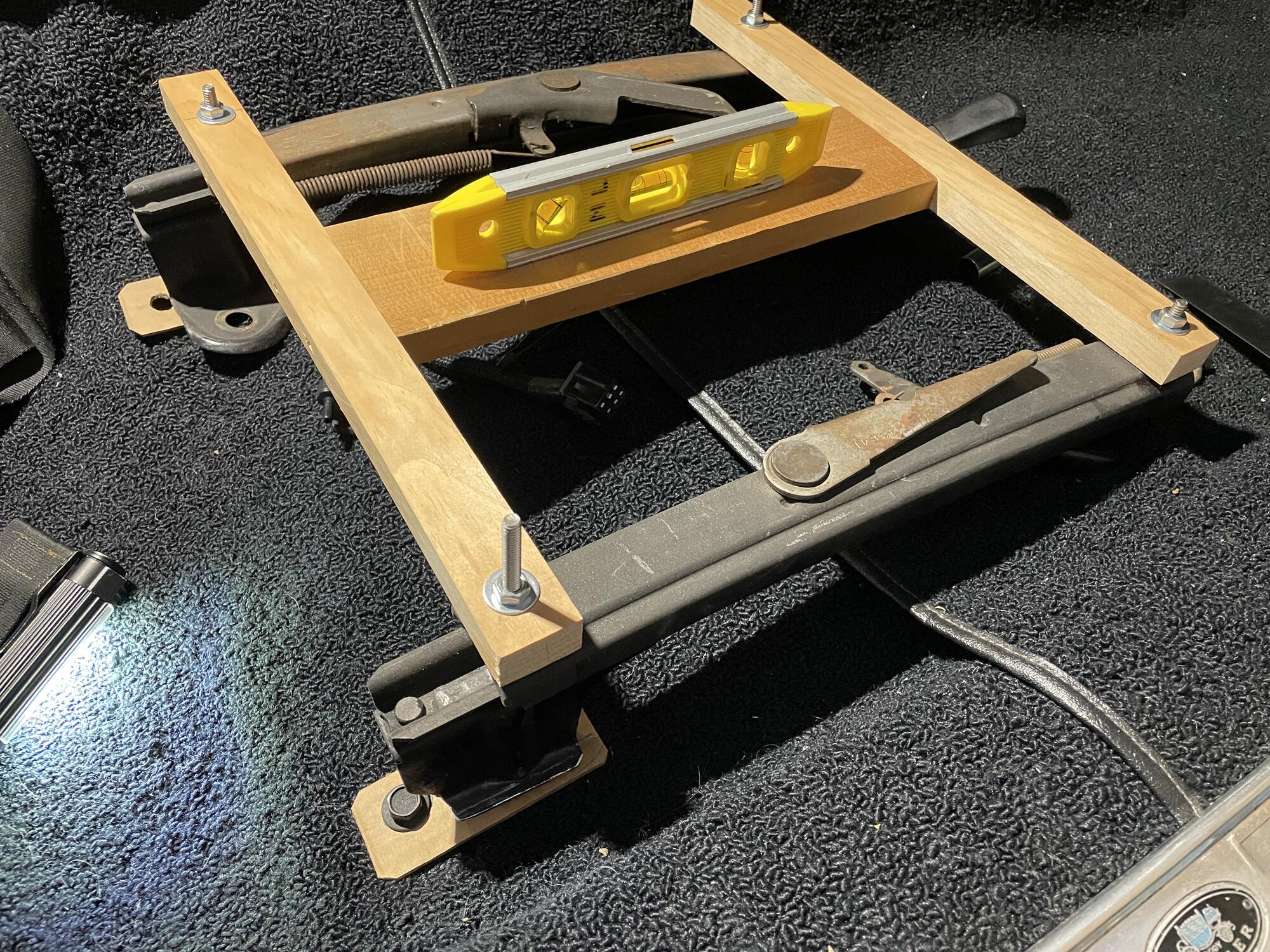

      Donny’s right about this. Once you’ve established that the seat generally fits where you want it for optimum driving position, you then would be best off modifying the Chrysler seat frame so it bolts down to the chevelle’s four seat mounts. I did this with 2000 Pontiac TransAm seats in my ‘69 Camaro. I removed the entire power seat track assembly and built a simple wooden frame to square up the left/right side of the seat tracks. I cut the rear legs off the tracks and made cardboard patterns of new legs that would line up with the original Camaro floor pan mounting. Used a level to keep things honest left right and fore aft. Welded up the new legs and then welded them to the lower tracks. The upright sections of the new shoes are welded on both sides of the original leg stump. Lines right up and I know that my new seats are in there as solidly as the OEM seats.
