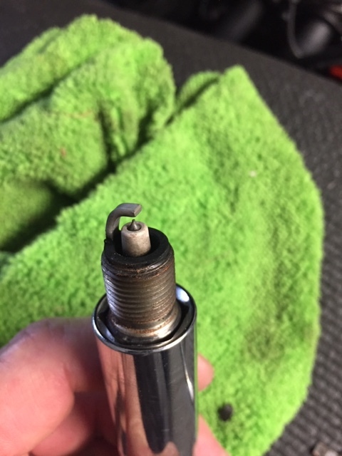

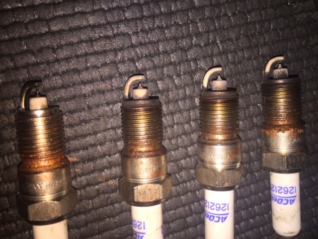

      Took the plugs out for an inspection and the pics tell me that #1 cylinder plug looks pretty clean with not really any signs of carbon, the rest look pretty much the same. If you guys think differently chime in.

      I'm going to get a new plug for #1 and change # 1 injector and see if this cure's the enriching drivers bank otherwise I'm open to suggestions.

      A little update as I believe things are okay now. Started off by getting a new spark plug for #1 cylinder, got a new 42Lb injector, swapped around D510c coils and plug wires to see if it would follow or make any difference, then swapped o2 sensors to see if the problem would follow the bank. All of these remedies didn't alter things.
      As worst case scenario I was starting to think maybe coolant was seeping into the the #1 cylinder and steam cleaning the plug and dreading the fact that the head would have to come off for inspection, or possibly a faulty ecm.
      Last week I changed the coil harness and added a ground strap to the drivers side cylinder head. Well when I first started it up after this the fuel trims on the drivers side started showing 20-15% minus upon startup. Don't know which one helped, my tuner thinks it was the ground. Boy was I happy to see #1 plug start to get carbon fouled. So far so good just have to adjust the fuel table on the upper end as the computer started adding fuel at 5806 rpm to the tune of 11.7% after I downloaded a fuel log last Friday. Thanks for all the suggestions.
