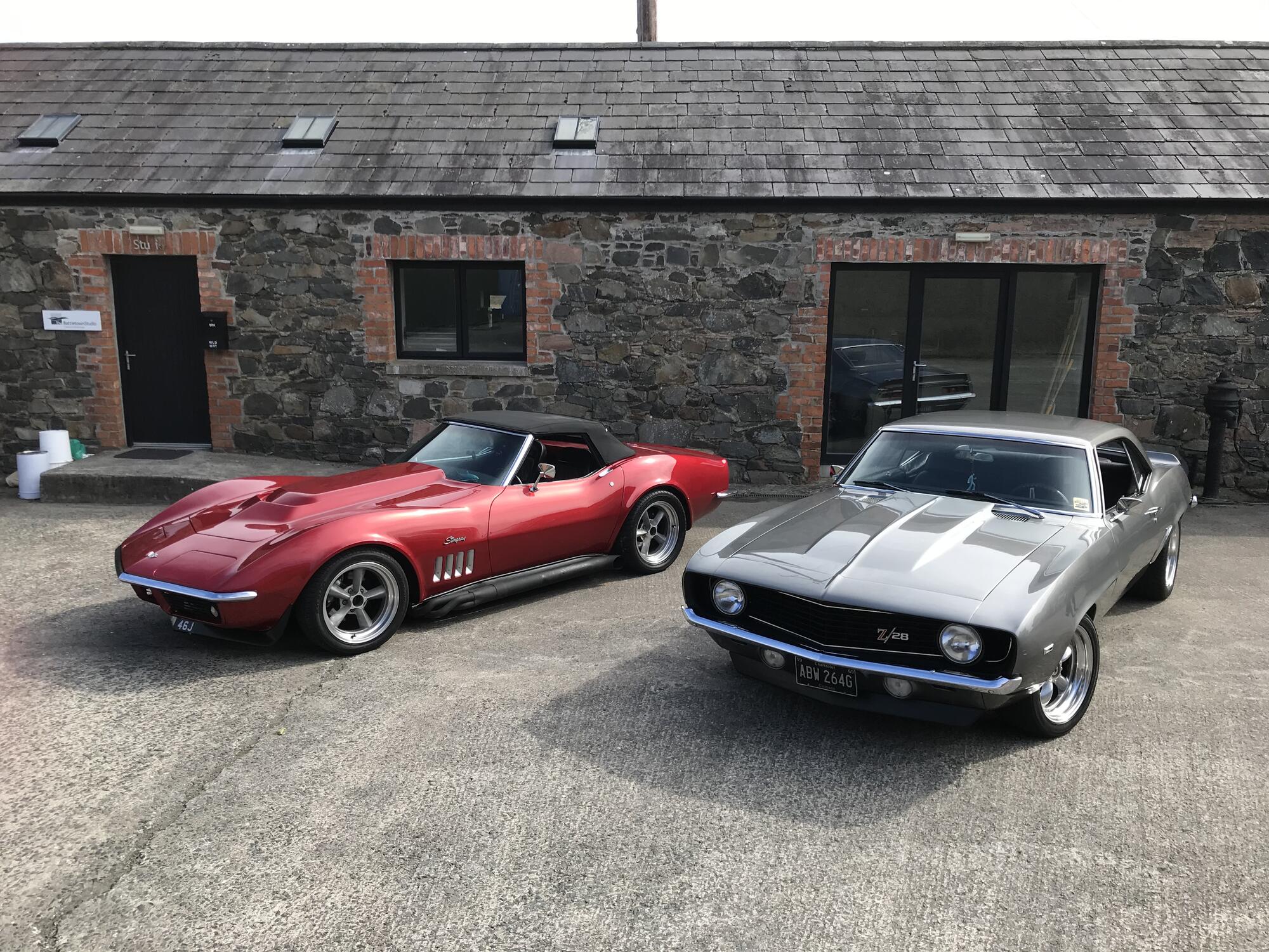

      Not sure if i'd ever shown a pic of the cars before so here we go!
