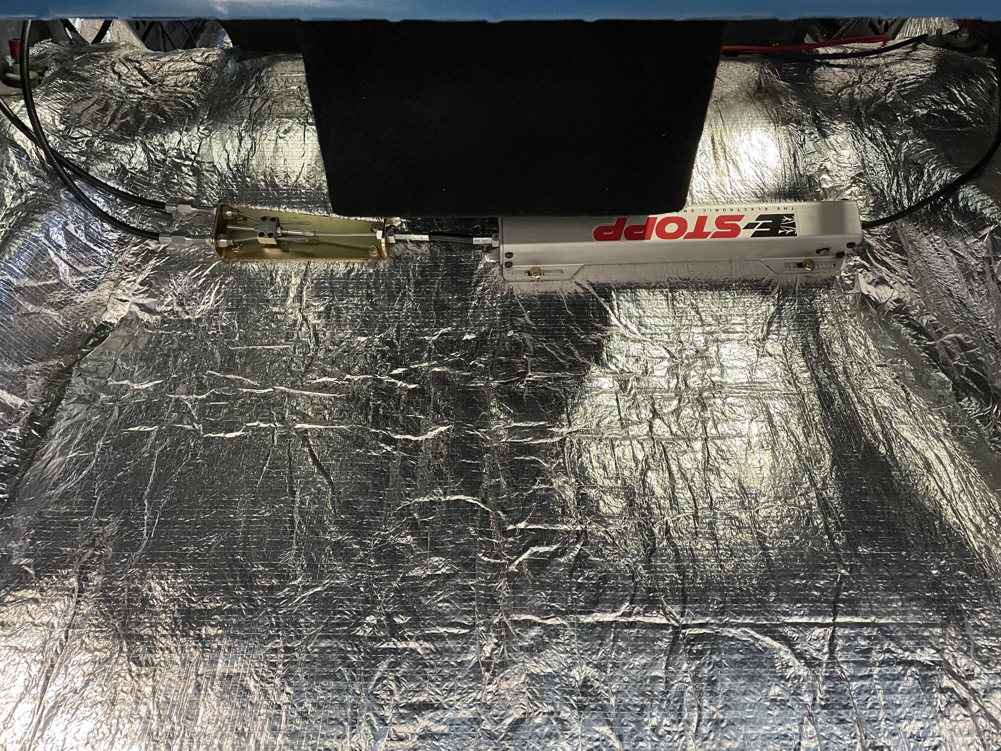

      I mounted the E-Stopp in the trunk. My first controller was bad but they made it right very quickly. Works great now.
