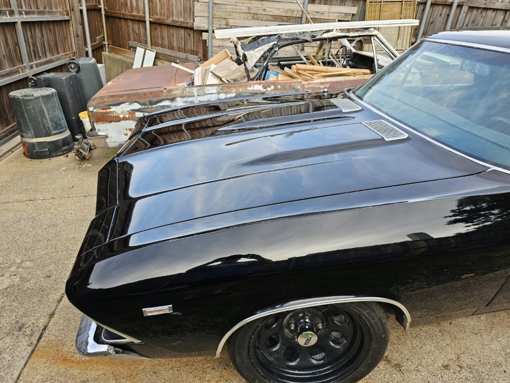

      Time to cut in door jambs, hood edges, tailgate edges, and the shiny part of the dash.
      It came out really shiny!
      Here too.
      And on the hood edges. This then prompted another round of 400 grit over the entire car as overspray got *everywhere*.

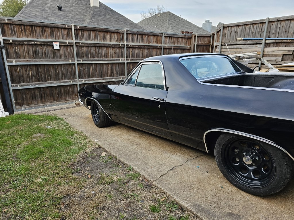

      I knew the easiest way to keep dust out of my paint was to close off everything else away from the painting area.
      Have to leave the air intake for the water heater, of course.
      The garage is slightly too small to squeeze past the front of the car when the door is closed, so framed out an extension of a couple of feet.
      The one screw attaching this extension to the house is in this corner.
      Tarped off the rest of the area.
      Here's what we're working with. Most of this is the high-build primer; anywhere that it looked like I'd burned through to bare metal got some reduced epoxy primer to seal it.
      The opening near the fridge wasn't to be closed up until spray-time; the garage door won't close with the plastic in the way there.
      2
      The bed got taped off too, it'll get some sort of spray-in bedliner.
      The loose parts got hung from the ceiling.
      The sealer (SPI) is applied. It's ~102 outside so probably 110 in the garage.
      The fans do a good job of pulling overspray out, but not in keeping me cool.
      Not pictured: I got the sleeve from the bunny suit stuck in the sealer on the pass side rear. Had to quickly fill with glaze and reshoot. Hopefully it's not noticeable.
      Then comes the fun part: the basecoat.
      3 coats of SPI black.
      Laid down smooth.
      And then, the clear.
      Of course I had a lot of orange peel. It's shiny but it's not flat.
      Sand with 2000-3000-5000-8000, now it's flat but not shiny.
      And then with some buffing (3M 36060 with their 33037 pad, and then their 06068 polish with a 05733 pad)
      n.b.: The 33037 pad on Amazon says it comes two to the bag - it lies; they're individual.

      The sanding and buffing and polishing continues with more 2000 grit sandpaper:
      Nice and flat
      nice and shiny
      shiny, all around.

      Roof is polished. And dusty.
      So much compound landed on the package tray.
      Buffed the gas door too..

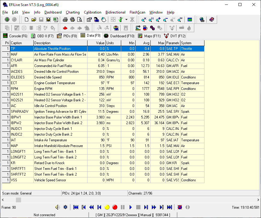

      Next up: I was idling high with the LS, and now again with this one I'm having the EXACT SAME ISSUE.
      This one is also chronicled here for the full detail
      I started with the whole vacuum leak thing, and waggled an unlit propane torch around everyting while idling, looking for something to change. Nothing did.

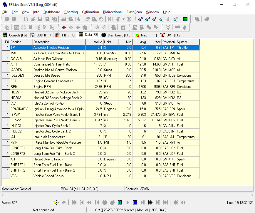

      An initial capture with EFILive (because that's what I have) showed the IAC gradually moving to zero. Here at 310 and I'm idling at about 814 rpm.
      278, about 15 seconds later. RPM is up to 1500
      IAC goes to zero, RPM goes up to 2200.
      It just doesn't get better; RPM now up to 2486.
      I could hear a sucking sound as the IAC closed and the RPM went up. Don't know what that was about.
      Did notice something odd though: my MAP was consistently 1.5PSI through this (and also if I turned the car off). Let's troubleshoot that.
      Well, certainly looks like I didn't forget to put the MAP sensor in.
      Step 1: Throw money at it (bought a new sensor). No change.
      Verify the wires. Access is very limited. 12v is 12v and ground is ground, no issues there.
      The signal wire, however, shows an open.
      Oh. That would explain it.
      Replaced the connector.
      Well, MAP values are more realistic now, at least. I'm still at 2129 RPM and IAC at zero, but MAP is right. So next up is to validate the wires going to the IAC (sorry, you get no pics here).
      Verified the four grounds for the ECU.
      On the IAC: Pins 77, 78, and 79 to three of the four IAC pins showed between 0.7 and 0.9 ohms. Pin 76 (IAC Coil B High) didn't even have a wire in it.
      Found that missing wire in pin 76, and now everything idles correctly. The sucking sound is gone too.

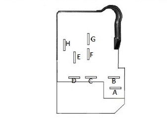

      Next up - pulling the headlight switch out and tracing through what I expect to happen and what is happening.
      (circuit numbers match the 2000 F-body circuit numbers):
      #9 is park lamp feed enable, providing +12v there turns on the parking lamps (and the ding-ding-ding)
      #44 is IP light fuse input, giving +12v there turns on both turn signal indicators and the high beam indicator
      So in my application (the malformed hybrid of a 69 El Camino and a 2000 Camaro):
      A: Connect to ground to enable dome lamp
      B: This is the main power-in to the switch.
      C: This is #44, the dash light output. This goes through the dimmer rheostat.
      D: (not connected)
      E: This is #9, the park light feed. It's internally connected to D but that doesn't do anything since D gets no wire.
      F: Headlamps out. With the switch pulled all the way out, this connects to B.
      G: (not connected)
      H: This is #240, "Fused Input Feed". When the park lights are on (switch in first or second position), it's connected to E and to then to C via the dimmer
      This required some thought. Moved on to the driver's taillight. Bulb was obviously burned out. Replaced, still no joy.

      With the wipers done, I could put the hood back on.

      Got the vehicle insured.
      Today's plan was a trip around the block, then if all was well take the car up to get it inspected.
      All was not well.
      • The clutch is not fully disconnecting. This actually got worse as the drive continued, because:
      • The retainer for the clutch pedal had fallen off and gone .. somewhere.
      • At temp, it won't idle. The clutch not disconnecting doesn't help there, I imagine.
      • The parking brake worked great, until I got back. Something popped and there was suddenly a lot of slack on the pass side cable.. Took up the slack, and the pass side now gets much tigher than the driver's side, and the parking brake is completely ineffective. After cleaning up and coming in, I suspect that the pass side cable came free from the caliper, and it's catching the stop - so no braking from the pass side, and can't get tight enough on the driver's side to add any either.
      • The driver's exhaust tip is not in the right place. I need to adjust everything after the muffler.
      • I dropped the column a few months back to adjust the high beam switch, and something got tweaked. There's some binding in the steering - not in specific places, but in all of them the steering doesn't turn freely.
      • The alignment is SO wrong.
      • There's a whole bunch of things rubbing and rattling.
      • I didn't even think to verify that the speedometer was reporting<
      So the afternoon was spent in the driveway wrenching:
      • I had a spare clutch pedal retainer in the attic. Successfully installed. Still insufficient clutch disengagement
      • Tried to adjust the clutch rod to let it stroke the slave a little further, did not help. Think maybe I need a 1/4" threaded sleeve that's ~1/2" longer than what I have now.
      • Also tried to re-bleed the clutch slave; had a hard time getting the pressure bleeder set up
      • As described above - spent a lot of time trying to get the parking brake adjusted with no joy.
      Plenty to do before the next attempt... but I can say I did drive the car today.

      Another issue while it was apart was on the way back from the inspection, the turn signal lever stopped "latching" in the right-turn position.
      I could not figure out how to get this apart so will worry about it later.

      • Played with EFILive a little and got it where it'd idle.
      • Then I went to set up for wideband tuning - dug out the Innovate LC-1 that I've had for ~20 years (goes well with the 20 year old EFILive hardware, I imagine)
        • Hooked it all up, and EFILive says 0.0 AFR or 0.0 volts on the external, depending on how I ask it
        • Went to look at the raw data through the LC-1 software, and my USB-to-Serial cable has failed. Ordered a new one.
        • New USB-to-Serial, now I can get to the LC-1 software. Wild fluctuations - 7-to-20-to-7, etc. Assuming it has failed (although that could be perfectly normal).. ordered a new one, and LC-2 since LC-1 is out of production.
        • New LC-2 with new USB-to-Serial, go in and tell the hardware to report 2v on channel 1 and 3v on channel 2. Confirmed output with a multimeter.
        • EFILive reports 0.0v. Lots of back and forth with the EFILive support folk... and the result is that my hardware has apparently failed, and the upgrade path from the FlashScan v1 to vx closed years ago. Ordered an HP Tuners HPVI3, with ProLink - not because I think it's better, but because almost all of the tuning tutorials I see on YT are with HPT and not EFILive.
        • Now I'm getting to learn how to use HPT.
      • I got a steering column tool to get to the bolt for the turn signal.
