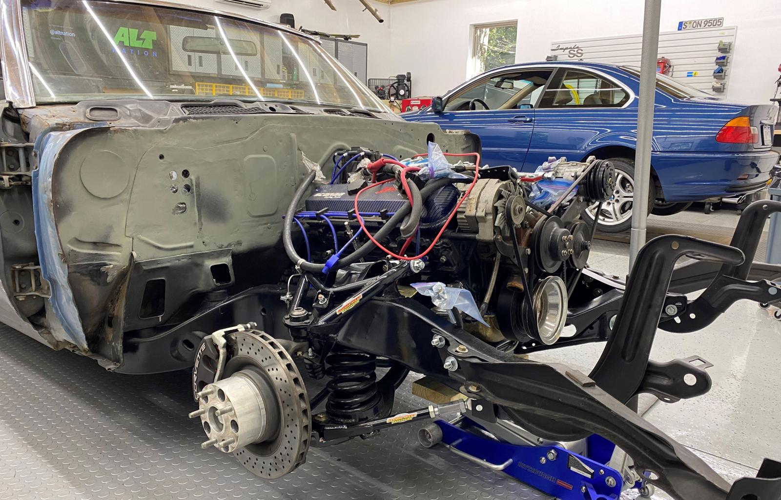

      The four holes on the passenger side are my Vintage Air pass throughs. The one below that is the bulkhead terminal for the trunk battery.

      You can technically run them anywhere you want. Also keep in mind the firewall picture is my 69 Impala so the scale is somewhat different. My AC hoses run inside the fender and those holes are where they need to be for the lines to exit the fender and go through. If I ran through the large vent hole they'd cross out midway through the footwell.
      Unfortunately the car is apart at the paint shop right now and I can't show you how it looks assembled.
