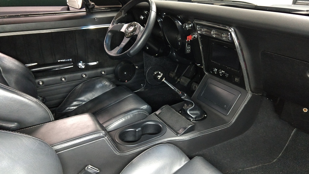

      I have a few pictures in my build thread of the same console. I extended the top with fiber glass so that it would fit snug under the center dash and I made a "U" bracket that's located under the cup holder. This way the center console doesn't move around at all. I found using an oscillating multi-tool cuts through the fiber glass the best. Here's an updated picture as I redid the phone tray to tilt the phone up so I could see it better when using Andriod Auto I also refined the flip lid box as I didn't like the gap I had around the original door.
      I also brought the storage box, one improvement that I could of made was to cut the top of the box a little further down as I felt that the storage box would have fit a little better. I used a piano hinge to mount the storage lid and I 3d printed a filler piece with an alignment block on the top of the lid so keep the lid from shifting side to side when it is closed.
