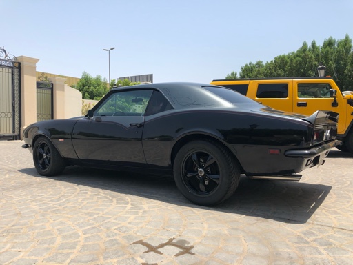

      Hey guys. Sorry last advice before I place an order.
      Which REAR tire size to go with. Wheels are: 17x8 , 4.5b/s, 0mm offset
      Keeping fronts the same: 235/45/17
      Rear Tire options (with adding ridetech 2" drop springs front & all shocks Streer Performance):
      1) 255/40/17 (NT555 G2 or BF G force)
      2) 255/45/17 (NT555 G2 or BF G force)
      3) 265/40/17 (Bridgestone Potenza)
      again, goal to even out ride height as much as possible without having the rears noticeably higher than front.
      This is how my car sits now (stock springs, KYB shocks 235/45 & 275/40)
      Much Appreciated!
