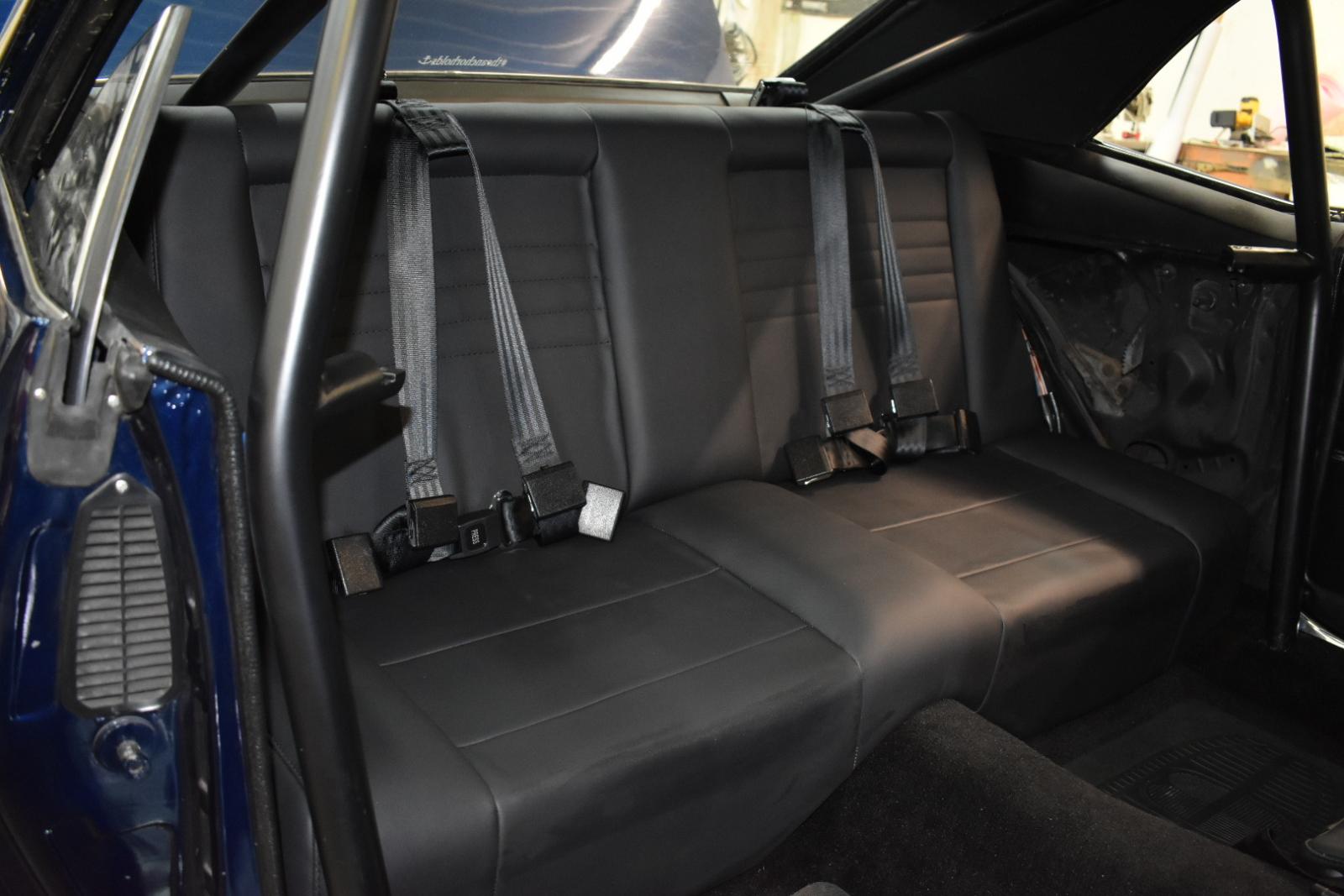

Size:  131.8 KBI’ve got Recaro Specialist M’s in my 68 Camaro and I LOVE them! Got them thru Renee at Northstar Motorsports in record time. They sit low, are super comfortable (been on two 8 hour road trips) and hold you in place during autocross events. They have all the adjustability you mentioned, you can get them in black vinyl or leather and the Planted seat brackets make the seats a direct bolt in. I’ve seen some similar designs by other companies that have the same appearance as the Specialist/Specialist M that may be less expensive as well. On mine, I had the back seat stitched up to match the fronts.

      Shane I have been looking at a bunch of rear seats stitched up to match recaro fronts for my car (which I still need to order from Dale) , yours are exactly what I have been looking for. Nicest job I have seen so far! Chad.
