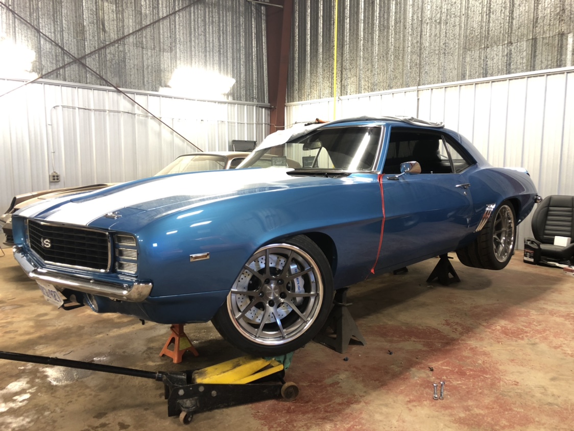

      Anyone have tubular control arms hit inner fenders ?
      Just installed the front fenders on my 69 Camaro with speedtech pro touring subframe.
      I have not set the car on the ground yet but the drivers side upper control arm is rubbing the inner fender. Passenger side lots of clearance.
      Wondering if this is common or not.
Size:  89.2 KBName:  IMG_8201.jpg

      Is the new frame square to the body?

      I have to measure.... looks good by eye and the bolts for the subframe were very tight and don't think theres any room for movement.

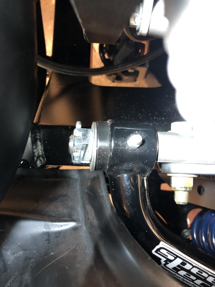

      After remeasuring and reinstalling the drivetrain with the adapter plates Blake mentioned, and putting the fenders back on I found plenty of room available at the control arms. The passenger side is a little less than this picture. I have 2 different brands of aftermarket fenders with the original 50 year old inner fenders. That is where I assume the difference is on my car.Name:  thumbnail camaro 9.jpg
