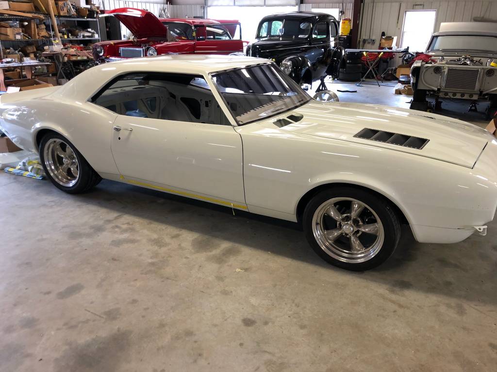

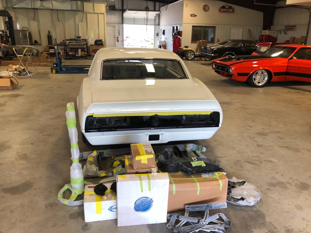

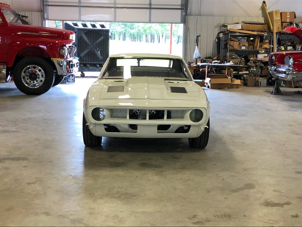

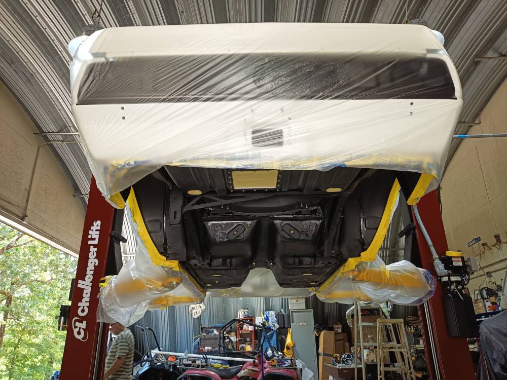

      And this is the white ghost with coming home bags packed.
      Holy Moly
      It's actually going to be my car lolName:  IMG_3290.jpeg
Size:  100.1 KBName:  IMG_3292.jpeg
Size:  96.8 KBName:  IMG_3291.jpeg
Size:  91.6 KBName:  IMG_3287.jpeg
Size:  97.0 KBName:  IMG_3288.jpeg
Size:  96.5 KBName:  imagejpeg_0-4.jpeg

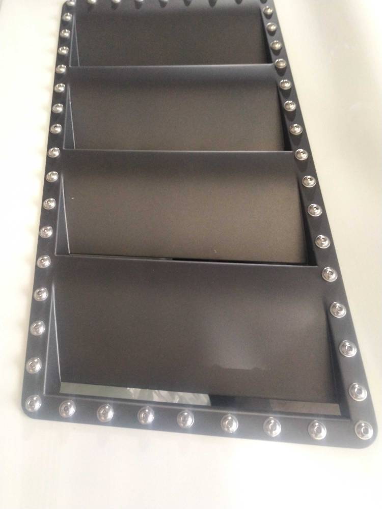

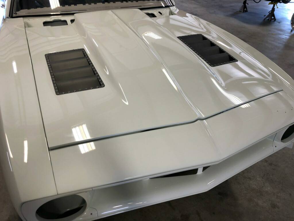

      Installed my headlight bucket mounts today. Both vents . And a few emblems just for the heck of it.
      So glad this car is he so I charge ahead with it.Name:  IMG_20210529_174313.jpeg

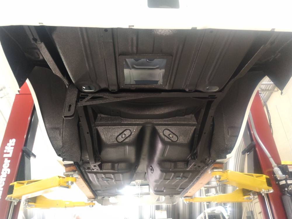

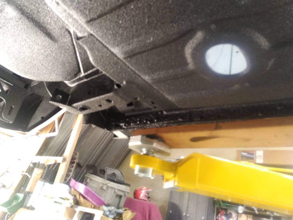

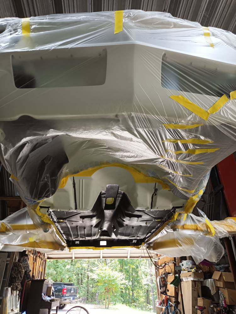

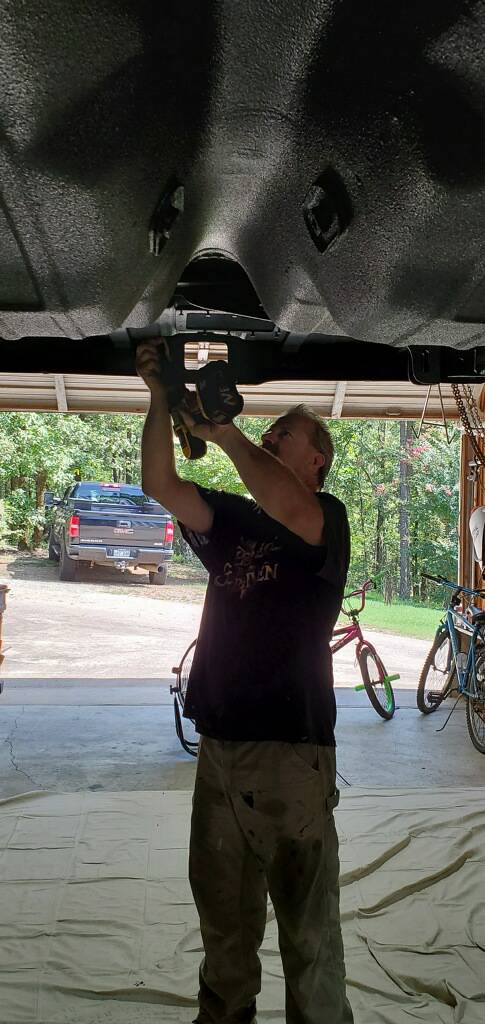

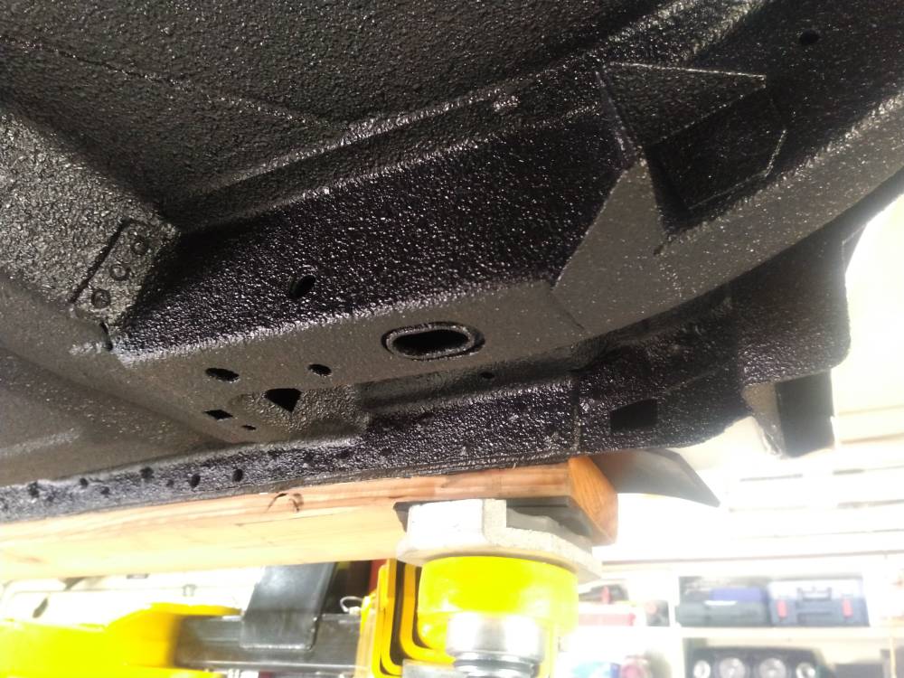

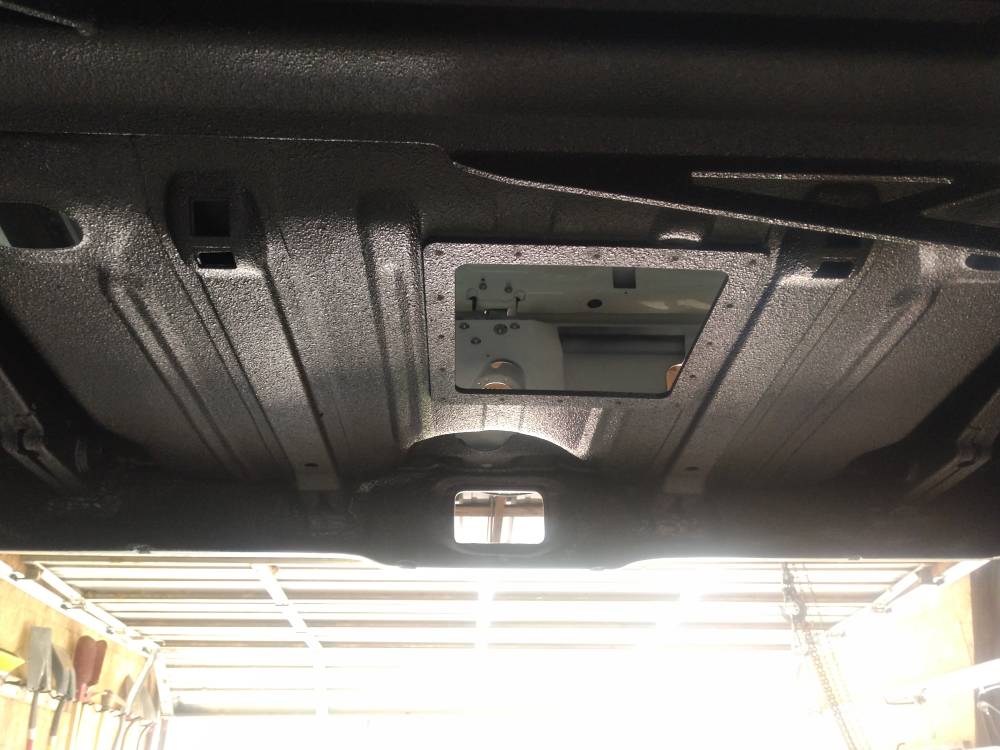

      Ok so I am super happy with the paint job from the rockers up. However the bottom I was not. It wasn't seam sealed but they applied raptor. So I sanded it all down, seam sealed with 3M heavy bodied urethane, and re shot with raptor. Now I'm happy with it.Name:  IMG_20210724_160215.jpeg
Size:  67.0 KBName:  IMG_20210724_160206.jpeg
Size:  85.8 KBName:  IMG_20210724_160130.jpeg
Size:  88.0 KBName:  IMG_20210724_160141.jpeg
Size:  78.2 KBName:  IMG_20210724_160328.jpeg
Size:  114.3 KBName:  IMG_20210724_160258.jpeg
Size:  67.1 KBName:  IMG_20210724_131501.jpeg
Size:  126.3 KBName:  IMG_20210724_131446.jpeg
Size:  116.6 KBName:  IMG_20210724_174808.jpeg
      TANKMASTERJ

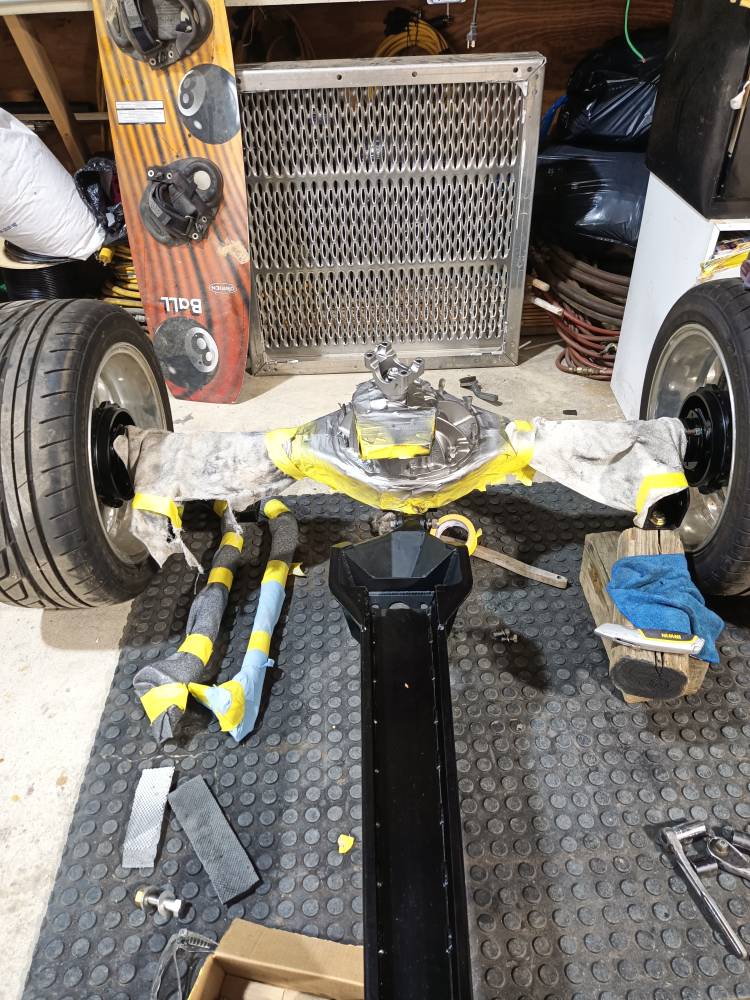

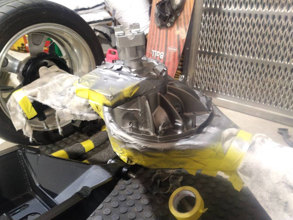

      Today I painted center section on my torque arm 9" setup. Painted it Stainless Steel so it would match my coil overs.
      I also cut my transmission mount apart, shortened it by 1/2" to give clearance between my t56 and tunnel. I used the speed tech tunnel raise kit but it was still tight so I figured that was better than shimming my billet subframe mounts.
      Also re shimmed driver door to front fender because when I took the Subframe back out after returning from the body shop it closed up to tight to open the door.Name:  IMG_20210725_142003.jpeg

      I am run the process of scarping the old undercoating off with plans to spray Raptor on it eventually. How many bottles of the Raptor did you use?

      War eagle scott I used a gallon or 4 one liter bottle that they send .
