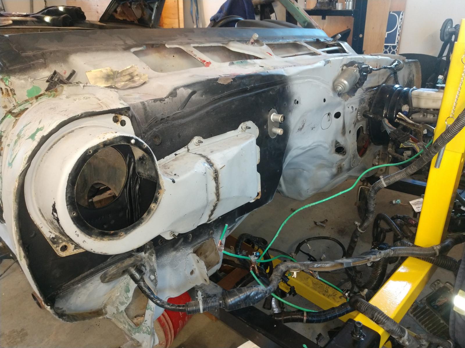

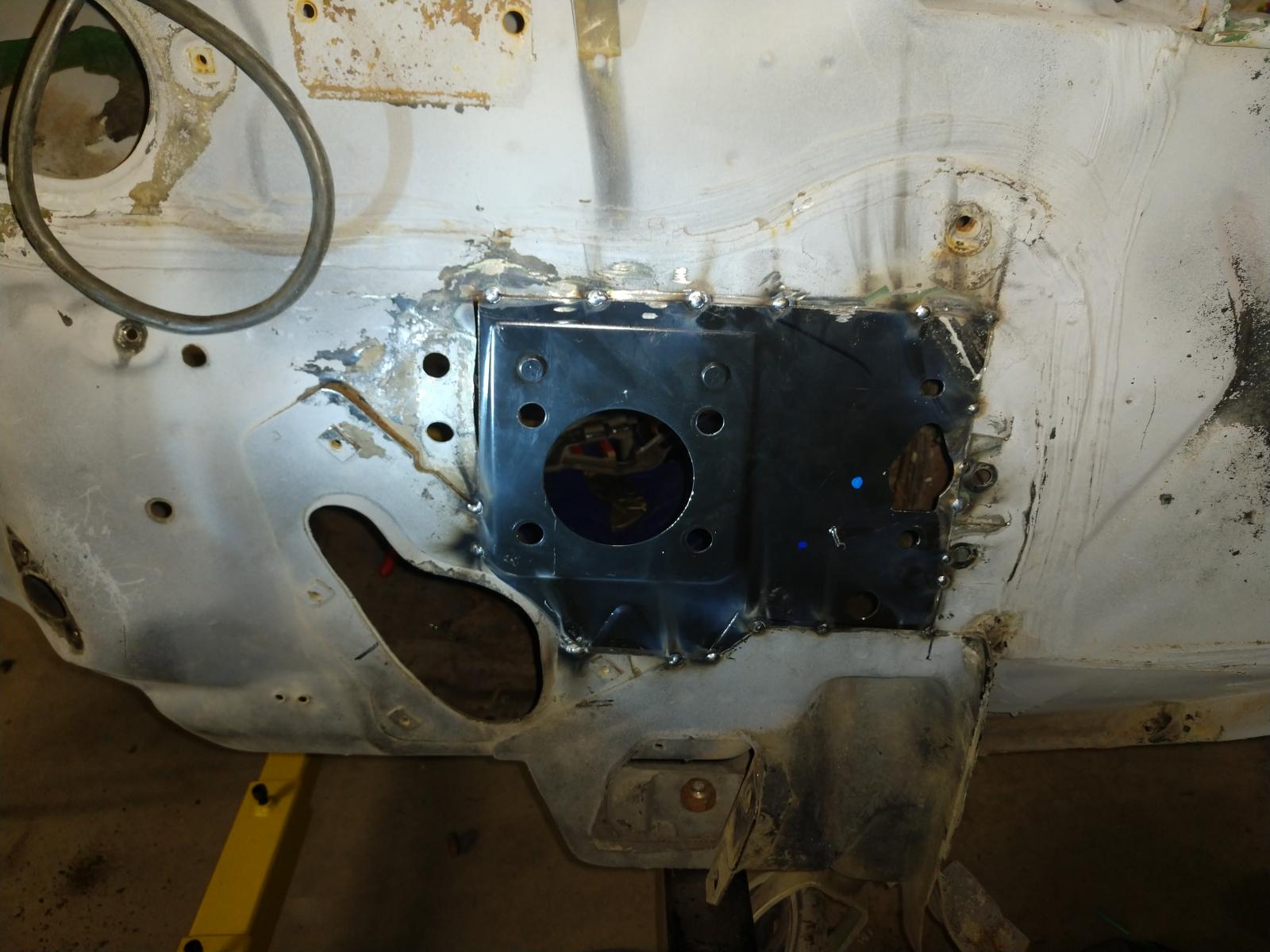

      Thought I would share my latest build. A very badly wrecked 2013 ZL1 camaro is reborn in a 69 body.
      2013 ZL1 components include, Engine, Transmission, Main Harness, all Electronics, Dash, HVAC, console, Seats, ABS, TPMS, Brakes, Onstar, XM, Mirrors, Door Handles, Latches, etc.
      1969 Camaro Body, Art Morrison Front and rear IRS assemblies.
      My build plan is to integrate everything possible from the 2013 into the 69 body, Utilize Art Morrison front clip and IRS
      in the rear allowing me to retain wheel sensor hub assemblies for the ABS, traction control etc. I have the pedals, Dash, HVAC unit & main
      harness installed and so far it is turning out better than I could have hoped. I am currently trying to sort out how i'm going to feed this
      baby with fuel...I got myself a RestoMod tank from Rick's that utilizes the ZL1 fuel pump, but my dilemma is how to best deal with the evap
      system...delete it or retrofit it. I haven't been able to find any info on how to delete it and keep the ECM from throwing codes. I have always

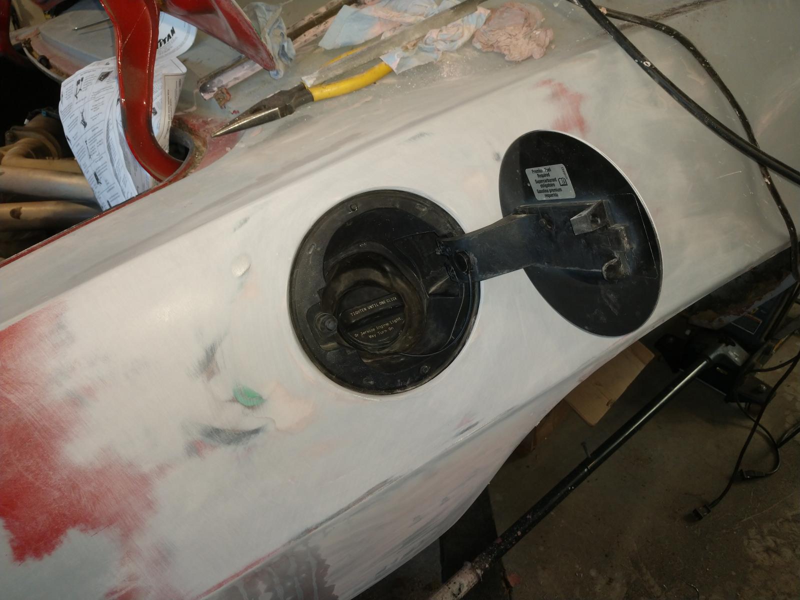

      hated where the stock fuel fill is on a 69 so I decided to add the 5th gen fuel door as well ;)

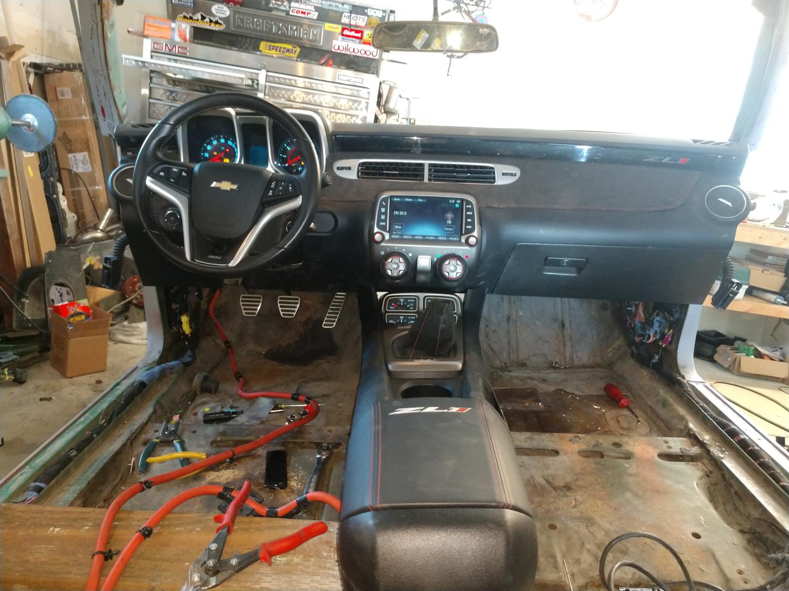

      Some pics of the dash install...

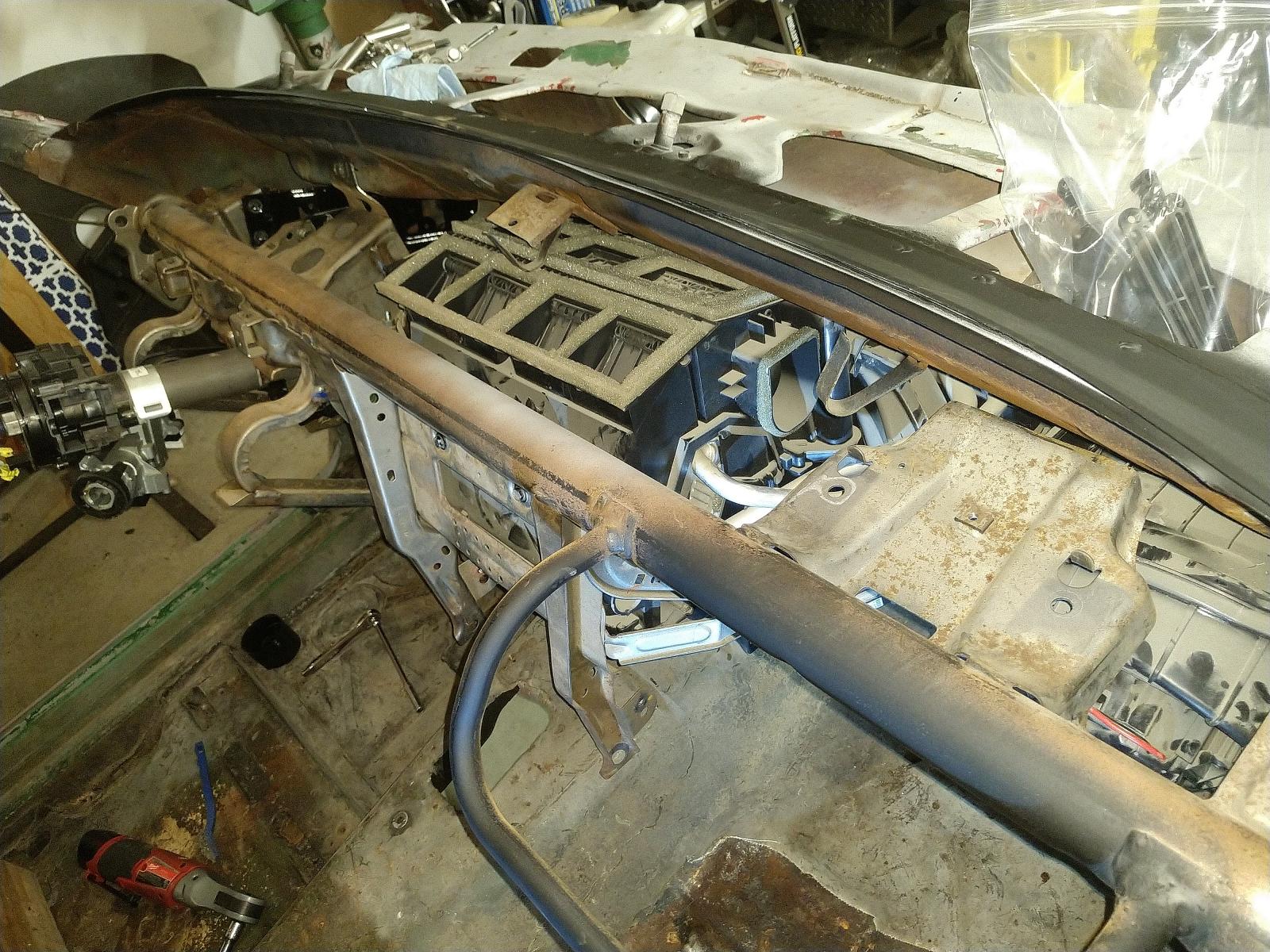

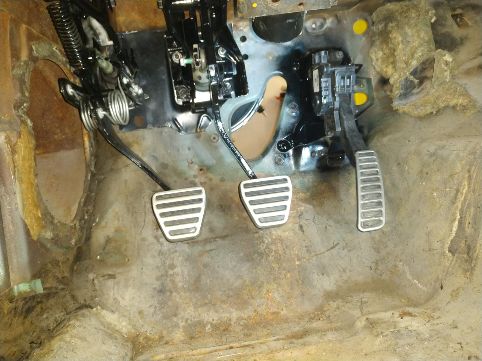

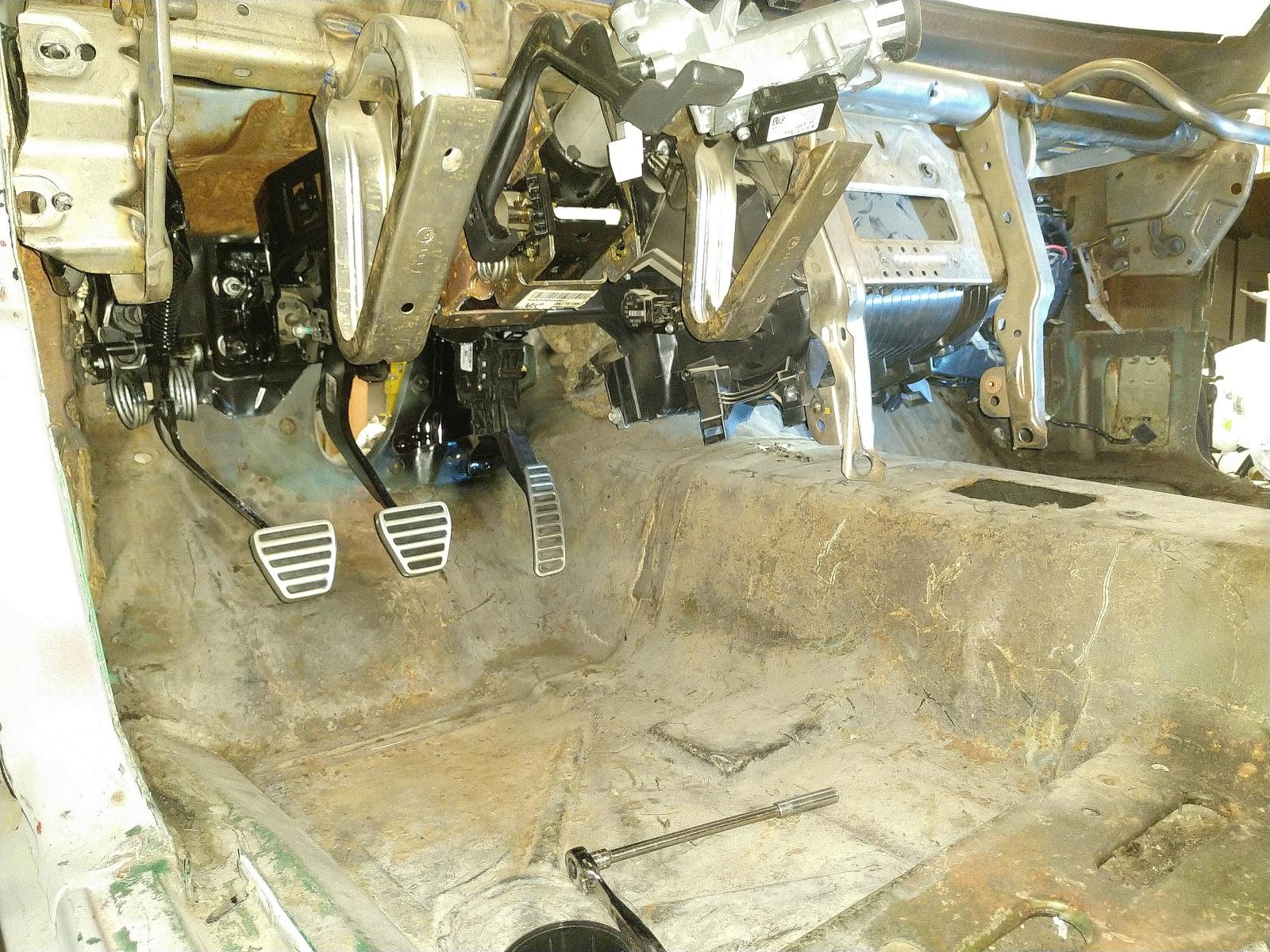

      Installing the pedals....

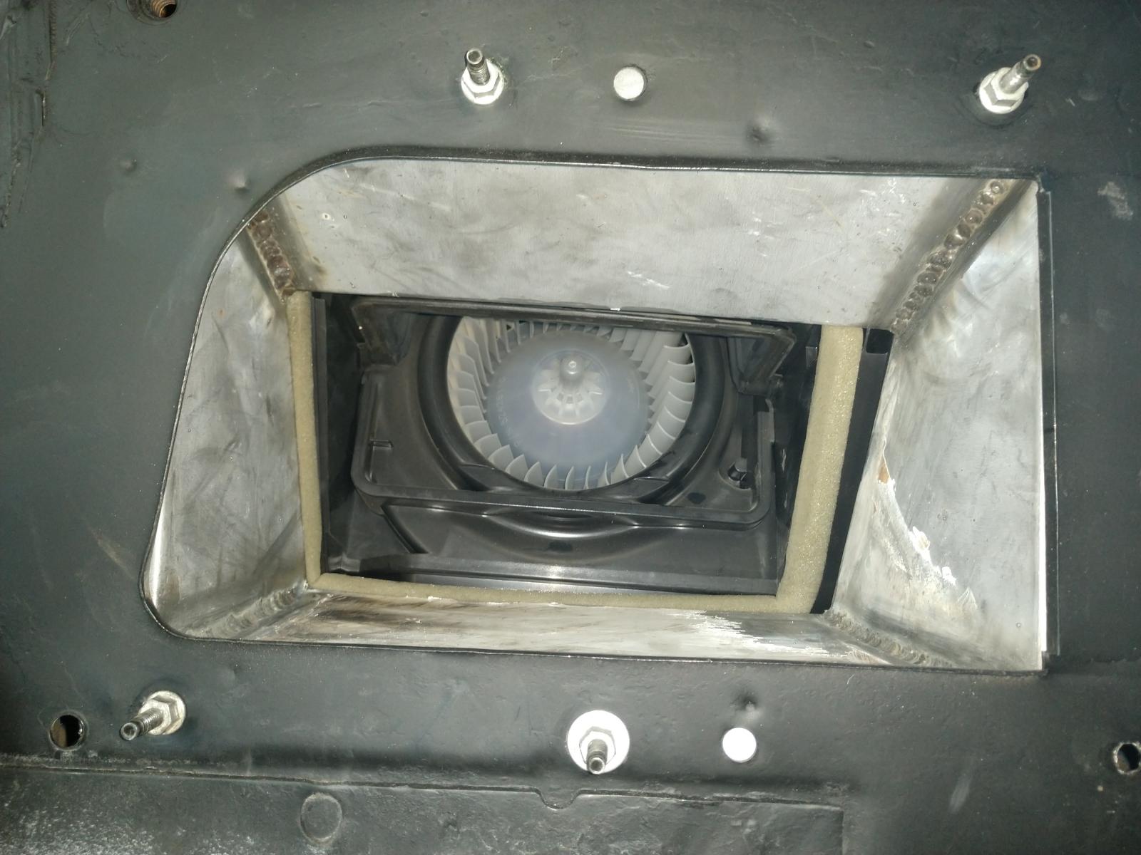

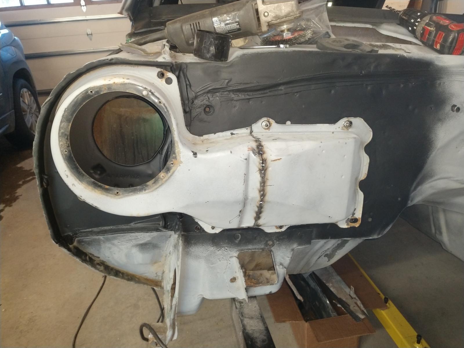

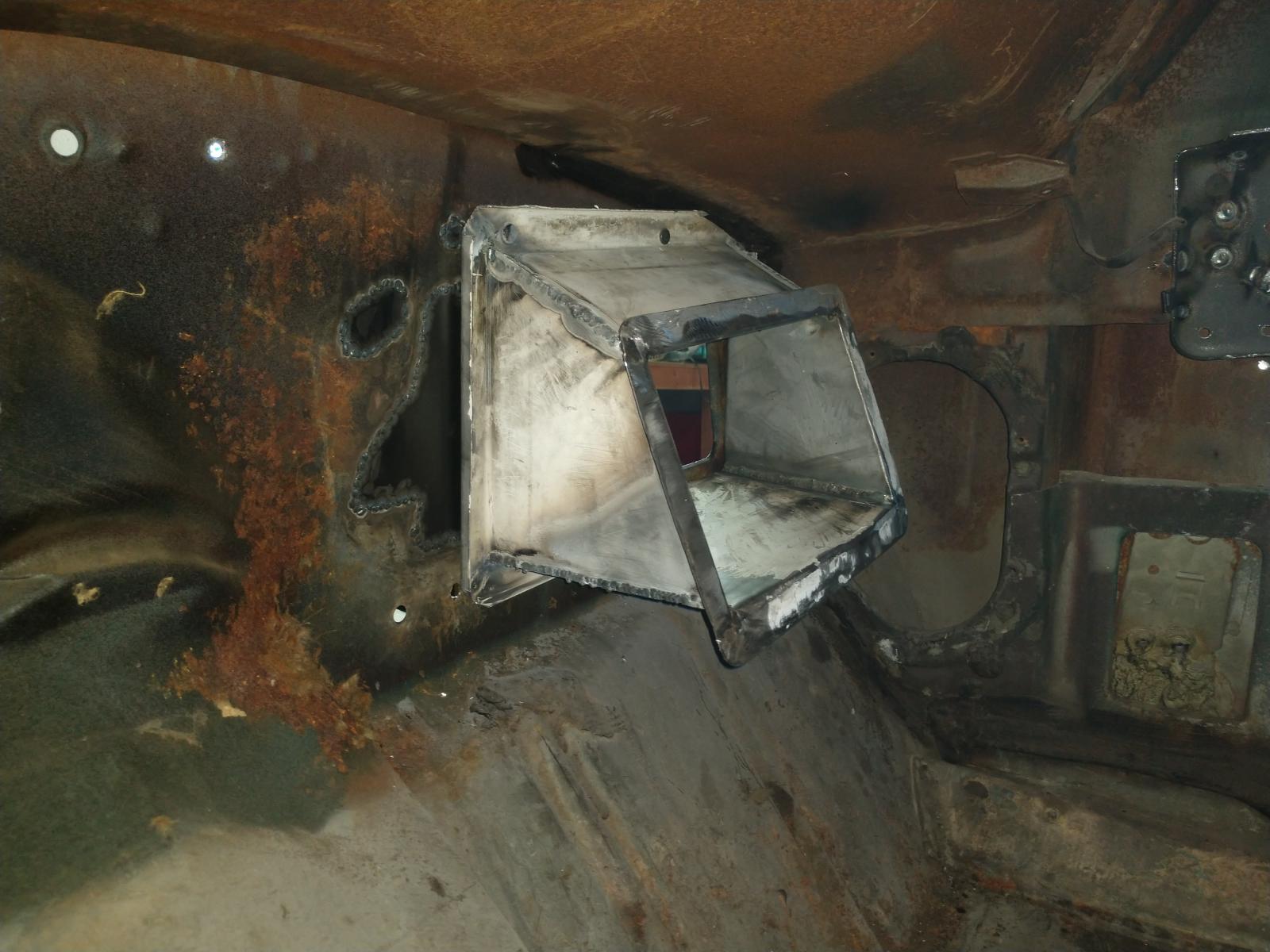

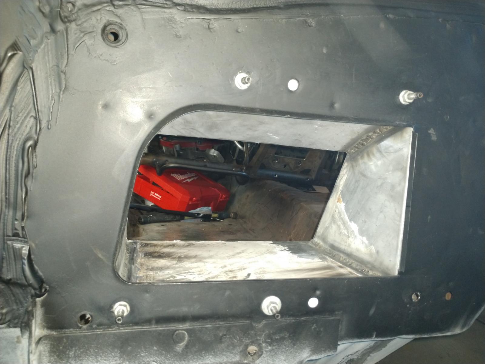

      Installing the HVAC unit...I was very surprised it actually fits in there.
Size:  247.4 KBName:  IMG_20190225_175208734.jpg
Size:  441.7 KBName:  IMG_20190225_175233095.jpg
Size:  393.9 KBName:  IMG_20190225_175244150.jpg
Size:  239.9 KBName:  IMG_20190302_170359578.jpg
Size:  164.6 KBName:  IMG_20190302_170426209.jpg
Size:  179.9 KBName:  IMG_20190302_170806084.jpg
Size:  174.8 KBName:  IMG_20190302_170925849.jpg
Size:  174.5 KBName:  IMG_20190303_124829893.jpg
Size:  128.2 KBName:  IMG_20190303_130437451.jpg
Size:  121.9 KBName:  IMG_20190303_131139901.jpg

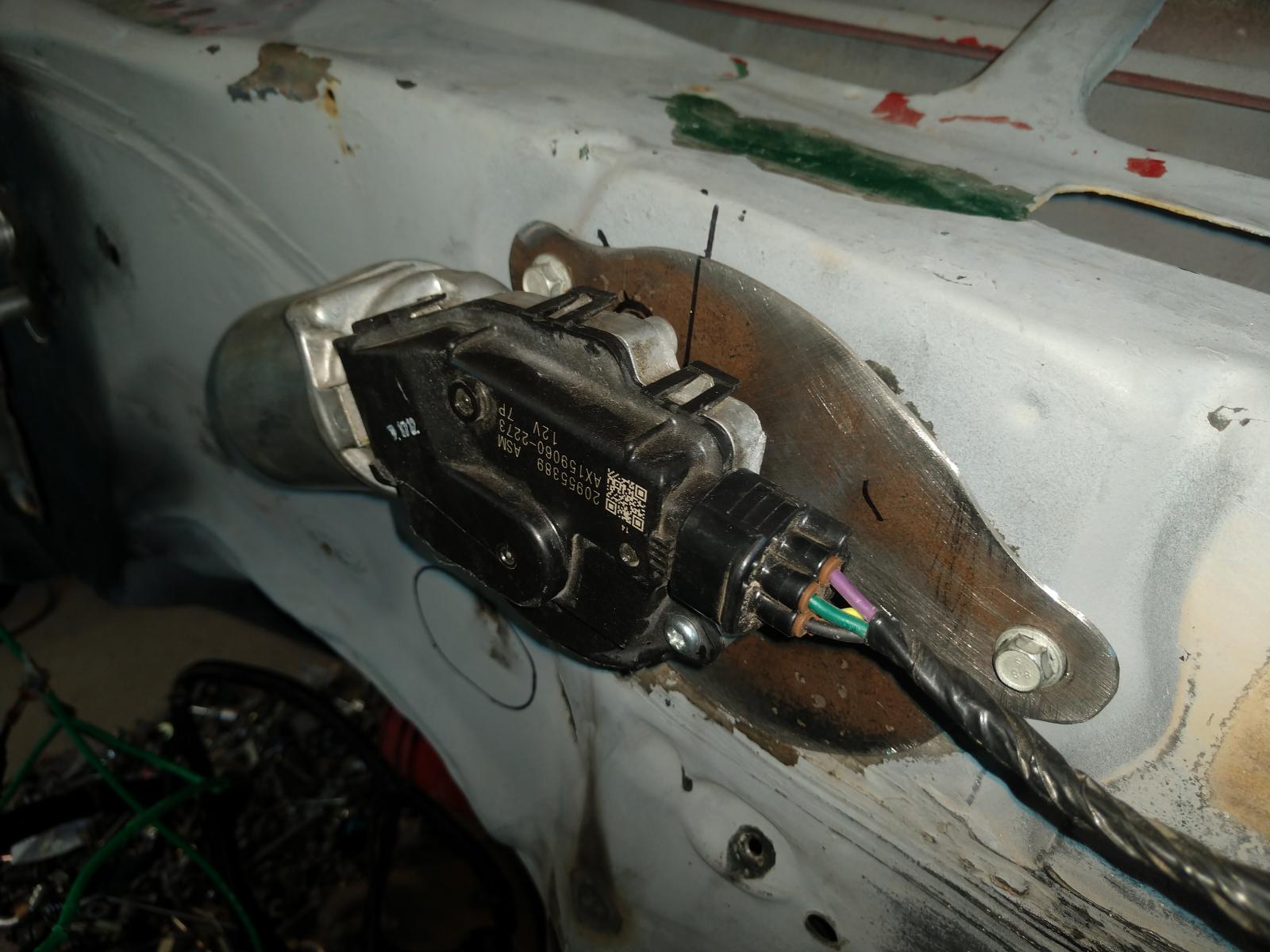

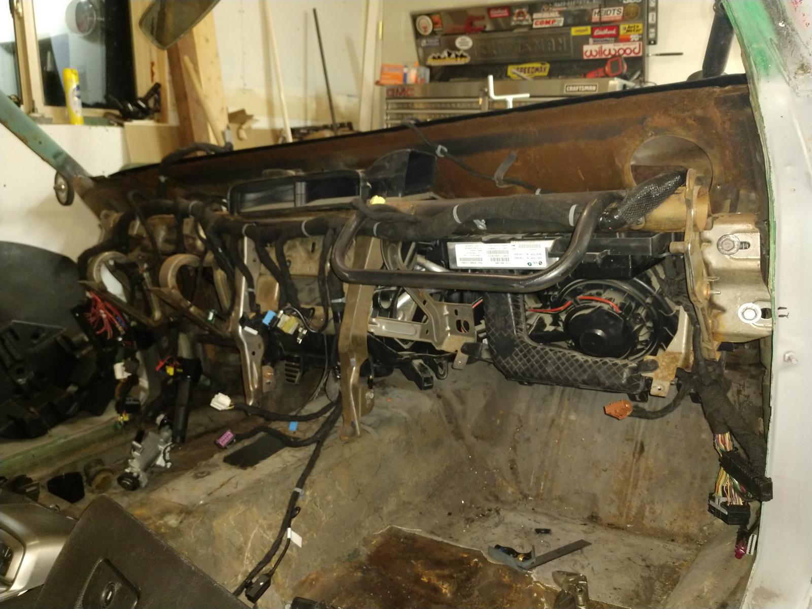

      Final fitting the dash, Installing the main harness and powering this baby up....
Size:  168.6 KBName:  IMG_20190309_143152629.jpg
Size:  236.7 KBName:  IMG_20190309_143053830.jpg
Size:  94.5 KBName:  IMG_20190309_143040405.jpg
Size:  226.3 KBName:  IMG_20190304_182706861.jpg

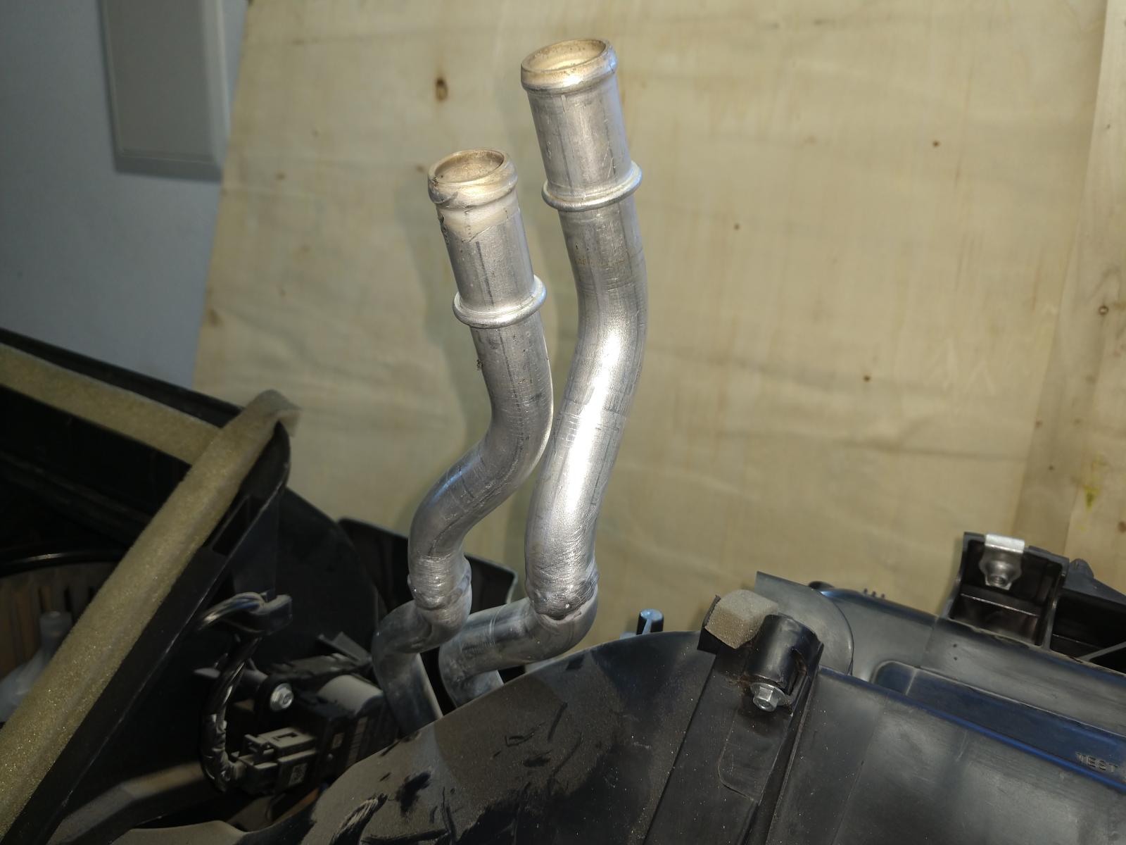

      Nice build, doing one of my own as well. 2010 2SS into 69. Did you tig the heater core lines back together?
      Jun 2017
      Idaho
      173
      Yes, I dig TIG weld the heater core lines to extend them so they would reach through the firewall.
      Quote Originally Posted by xHarrell View Post
      Jan 2020
      MS
      5
      Thanks for the reply, what about the ac lines? You going to extend them too or just make a recess in the firewall?

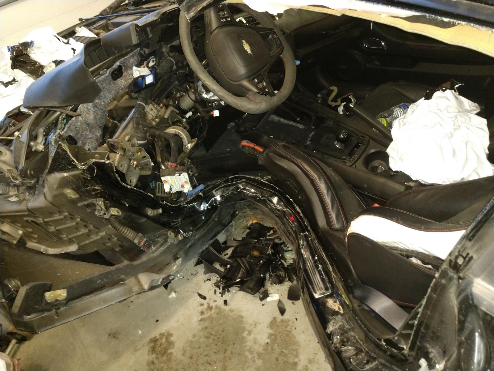

      Oh and for the curious ones, he hit a mesquite tree doing approximately 50MPH sideways off a curved wet freeway onramp. The dude had an angel looking out for him that day.....
